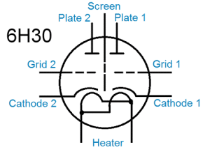

Replaced Q12 with a resistor of same value. Now have 42v and 40v across each channels plate resistors. But of course the transport has decided to not read, LOL. So now I need to install the new transport to test the output.Just to confirm, on the left channel (with the low output), you have about 55V over the plate resistors in both legs of the circuit, and in the right channel you have about 40V over the plate resistors in both legs?
55V over the plate resistors is a good value, but it creates about 2.3W of heat, and the resistors should support 2W only. Also the CCS value suggests rather about 44V over the plates, so maybe there is something fishy there. Therefore I ask if there is indeed 55V over the plate resistors in both legs (maybe one is less, would explain the lower output). You can indeed replace Q12 with a resistor between pin 2 and pin 3, just as Q14.
Lets check if both channels have good DC conditions. With a test tone at circa 100Hz one can measure AC well with a DVM. Please measure voltages at (all) grids, at all plates. Maybe somehow a tube is not connected correctly and disbalancing the circuit.

Please measure at both grid pins and plates. If we get weird measurements (probably we will) you can also take out all the tubes and measure again at the grids, to make sure the signal is present well at the grids. But first please with the tubes in place.
When measuring the grid on AC, what pins am I doing? Since its AC I dont want one probe on grid and one on ground or do I? Sorry if this is a stupid question. just trying to get it right.
You do indeed put the black probe on the audio ground (let's say the RCA shell), or any other easily available audio gnd (not to confound with the chassis ground). Leave it there, now with the red probe you poke around the pins for the grid and the plate. When playing the test CD, the sine will be amplified throughout the circuit, and you can measure with AC setting.
