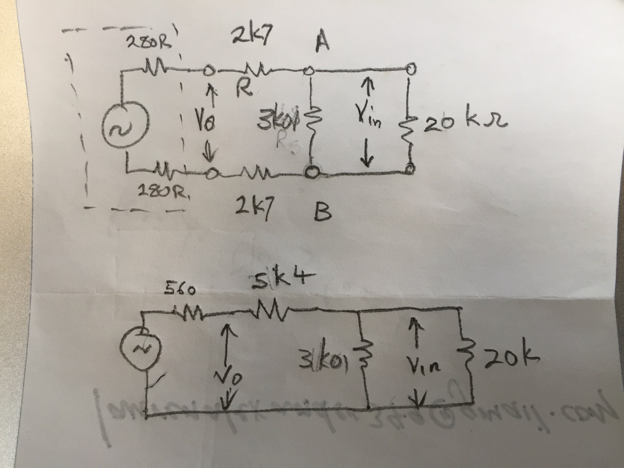

Below is the equivalent schematic of your DAC output / attenuator / amplifier input. It is symmetrical so we can redraw it in a simplified version as underneath. No let's say your DAC outputs 0dB. Without any attenuator in series the proportion of the DAC's voltage across the amplifier input is forming a potential divider with the output impedance of the DAC.
We can work out the attenuation as 20*log10(20,000÷(20,000+560)) = 20*log10(20,000÷20,560) = 20*log10(0.973) = -0.24dB. There is already a small amount of attenuation.
Now if we put 5k4Ω in series with the 560Ω output impedance of the DAC, the total 'output impedance' is now 5k96Ω. If we put 1k8Ω in // with the 20kΩ input impedance of the amp, the load seen by the DAC + series r = (1,800 x 20,000)÷(1,800+20,000) = 1k651Ω.
So now the attenuation at the amplifier input is 20*log10(1,561÷(5,960+1,561) = 20*log10(1,562 ÷ 7,521) = 20*log10(0.208) = -13.65dB. The actual attenuation is the difference between padded and not padded = -13.65 + 0.24 = -13.41dB.
I have guesstimated a little over the correct amount by 3.14dB - doh!
The voltage across the load needs to be 31.6% of the DAC output. Therefore the output impedance + series Rs has to be the other 68.4%. From that we can work out that the input load has to be ((Rsource ÷ 0.684) x 0.316) = 2k729Ω.
Using the R48 preferred value of 3k010Ω in parallel with 20kΩ = 2k616Ω, and the attenuation now works out as 20*log10(2,616÷(5,960+2,616) = -10.31dB.
Then subtract the original .24dB attenuation without the pad and you have added and additional -10.07dB attenuation.

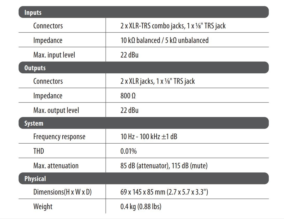

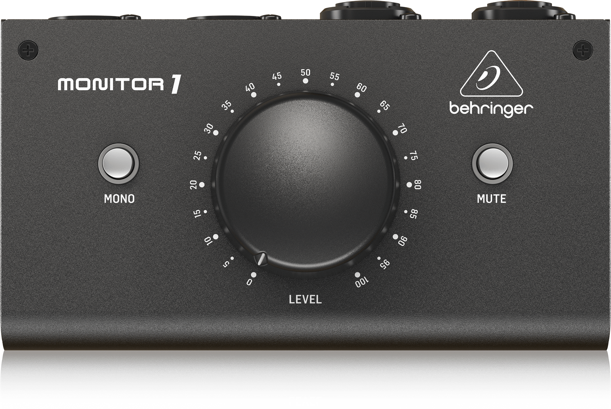

Whilst I wait for my basket to fill up so I don't have tp spend £15 for a handful of peny resistors I got wondering how these passive units work:
Behringer Monitor1
https://www.gear4music.com/Recordin...ME7DhB9JFJs16dwn-ncfMEvv20xEBzMhoCkwwQAvD_BwE
I don't understand how they are able to pick seemingly arbitrary input and output resistances and how they are maintained. I can't find a teardown for this kind of unit with a detailed assessment so it's hard to know!
Any thoughts, anyone? 🙂
