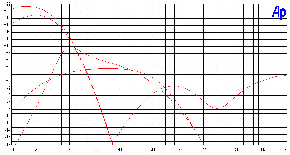

The filter topology for the LxMini is the same, but there are adjustments
in the values. Attached are the curves to the filters I worked up, and you
can play with the LXmini values a bit to duplicate them. You will note that
the high pass filter for the LxMini remains unchanged, and you can also
see the original Lxmini woofer filter for comparison.

1. Apologies if I'm missing this or if it's a dense question, but in the ASP, is the subwoofer filter designed to match the LXmini+2 filter or the LXstudio filter? They're a bit different.
2. The curves in this chart aren't labeled; is this comparing the DSP to the ASP? If so, which is which, and is the DSP curve the LXmini+2 version or the LXstudio version?

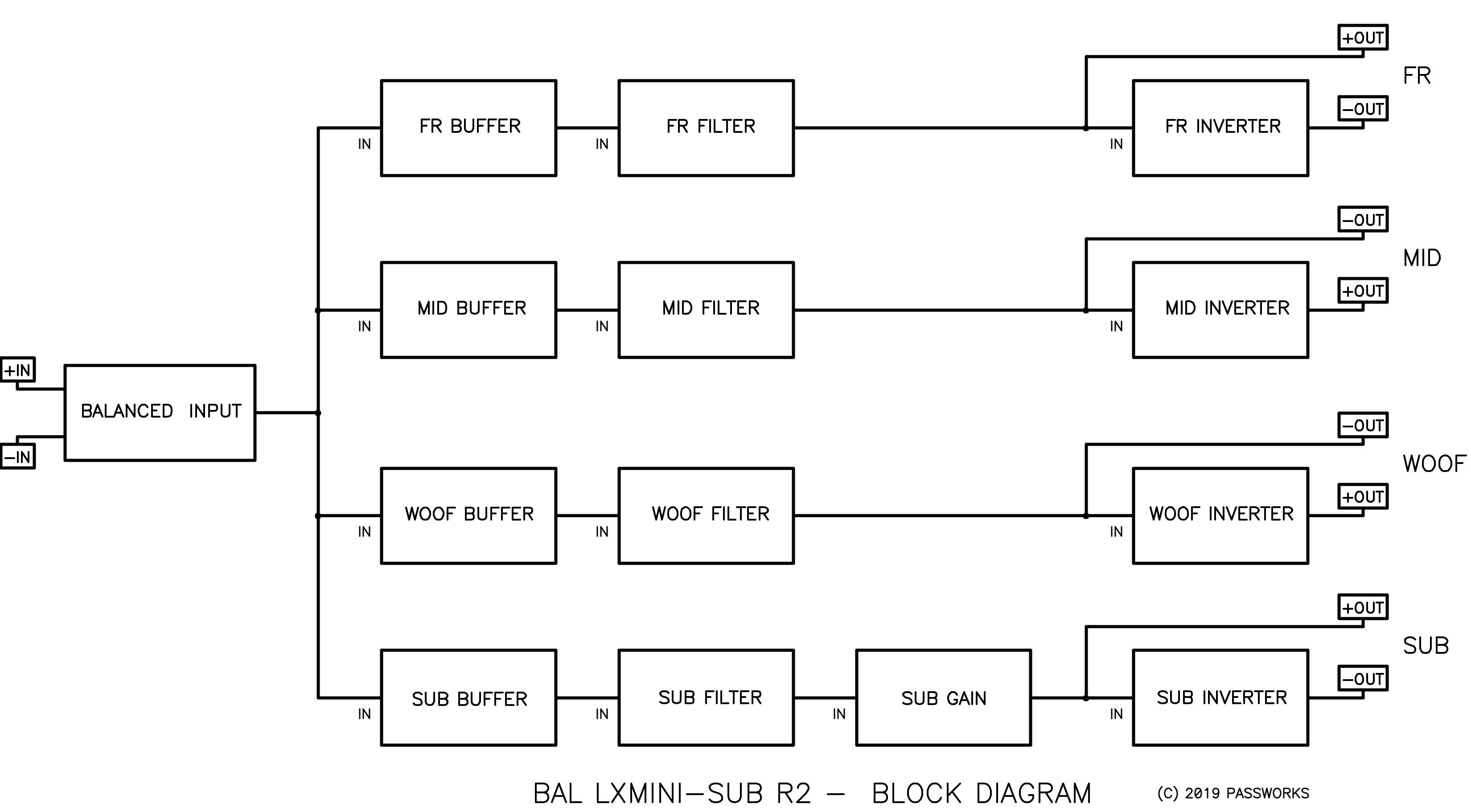

I recently purchased the 3-way ASP kit from Frank and have one question I'm hoping someone here can answer for me...
I have the LX Studio setup and was previously using the miniDSP 4x10HD for crossover/eq duties. With the switch to the ASP, do I need to reverse the wiring on the full range driver and dual subs to mimic the phase inversion that the miniDSP program had?
I think so.
Also I asked Frank the same question regarding inverting the phase and received this response: "Externally, leave everything straight, the XO has the reversion integrated."
So you are saying I should invert the phase by switching the wiring to the speakers, Frank is saying I don't need to invert the phase because this function is integrated into the ASP.
Does anyone know which is correct?

I still don't have a clear answer from Frank or from Nelson as to whether the the phase of the FR driver and/or subs needs to be reversed when using this ASP as they are reversed in the miniDSP settings. I've settled on what sounds best (I hate that answer BTW, especially in regards to the FR driver.)
Hopefully this info can help someone in the future.
The crossover was designed so that all inversions are done within the
crossover, as seen in the attached block diagram. This would mean that
the intent is that you operate the amplifiers and speakers as non-inverting.
With regard to the grounding, the board has been designed for flexibility.
It provides connections to pin 1, but whether they are used or not is up to
whoever is assembling it. If they are connected they go to circuit ground.
The attachment of circuit ground to chassis is made through R211, a power
resistor found on the center of the board below the attachment labeled
CHASSIS. The spot for the resistor can be filled by a resistor, a shorting
wire or nothing depending on what works best in a given environment.
