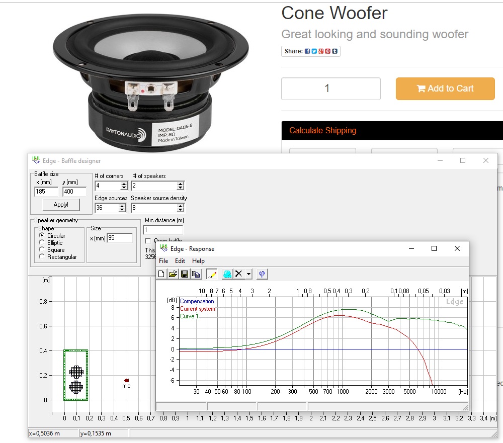

I usually ignore baffle step because I usually build big speakers but at the moment I am building small and tall boxes for the grandchild and the roll-off is apparent.
The midrange driver I am using is currently crossed over at ~180Hz which seems a little low for a 185mm wide baffle but I want to keep the XO as low as I can simply because these little 4" midrange sound better that way. I'm buying another couple of 4" woofers and I'd like some help with an approximation of the frequency to add the .5 driver at if I move the W to M frequency up to around the 300Hz mark
For sure there is need for compensation!

Any chance your budget can handle another $7.50 per driver?
Dayton ND105-8
