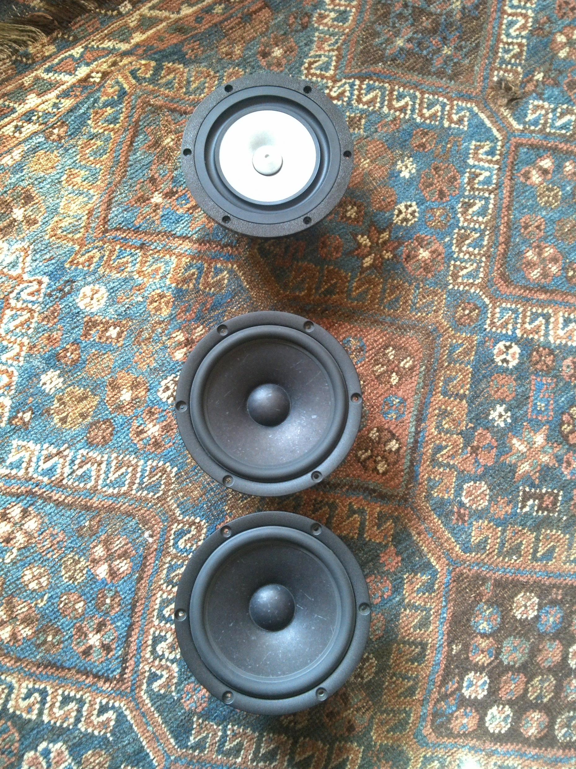

There are (mid)tweeters you can XO at 500 Hz. Althou usually you want to XO at less than the BS frequency (somewhere between 0.707 to 1 x F3(BS)). Woofer(s) should be 3 to 6 dB more sensitive than the midtweeter.
dave
If you look at the Cambridge Aero 2 measurements in HFW Feb 2014, this is exactly what they have done. You can see that the bass driver is about 3dB more sensitive than the BMR mid/tweeter, crossed over around 300Hz. The reviewer noted that the bass was slightly excessive.
6dB BSC correction appears to be way too high in real rooms
So a crossover at about 350hz for a 500hz baffle step with a 3-6db hotter woofer than the (mid)tweeter?
pretty much what I'm doing with these.
