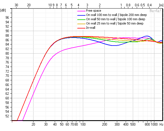

Why do you think BSC approach is problematic?
Because people often approach it with little understanding of the whole issue.
The intent of BSC is to counter the FR decline as the baffle/box transitions from 2π to 4π radiation. In free space this is a full 6db decline. In most cases it in a real room it is rarely close to that. The room and room placement make a significant difference.
If we take the basic example, if we raise the on-axis response to flat, for every bit of EQ we add to do that, we raise the room response above its nominal by the same amount. So we have the “right” amount of bass on-axis (according to the mic/analyzer) but too much in the room. Which is right?
Probably of greater issue is the way the roll-off occurs. It is rarely a smooth transition, and the naure of that transition can have way more effect than the actual baffle loss.
There are many ways to deal with the radiation transition, a filter is the las band-aid i wil try, and so far i have only ever had to use a BSC filter once (across hundreds of speaker pairs).

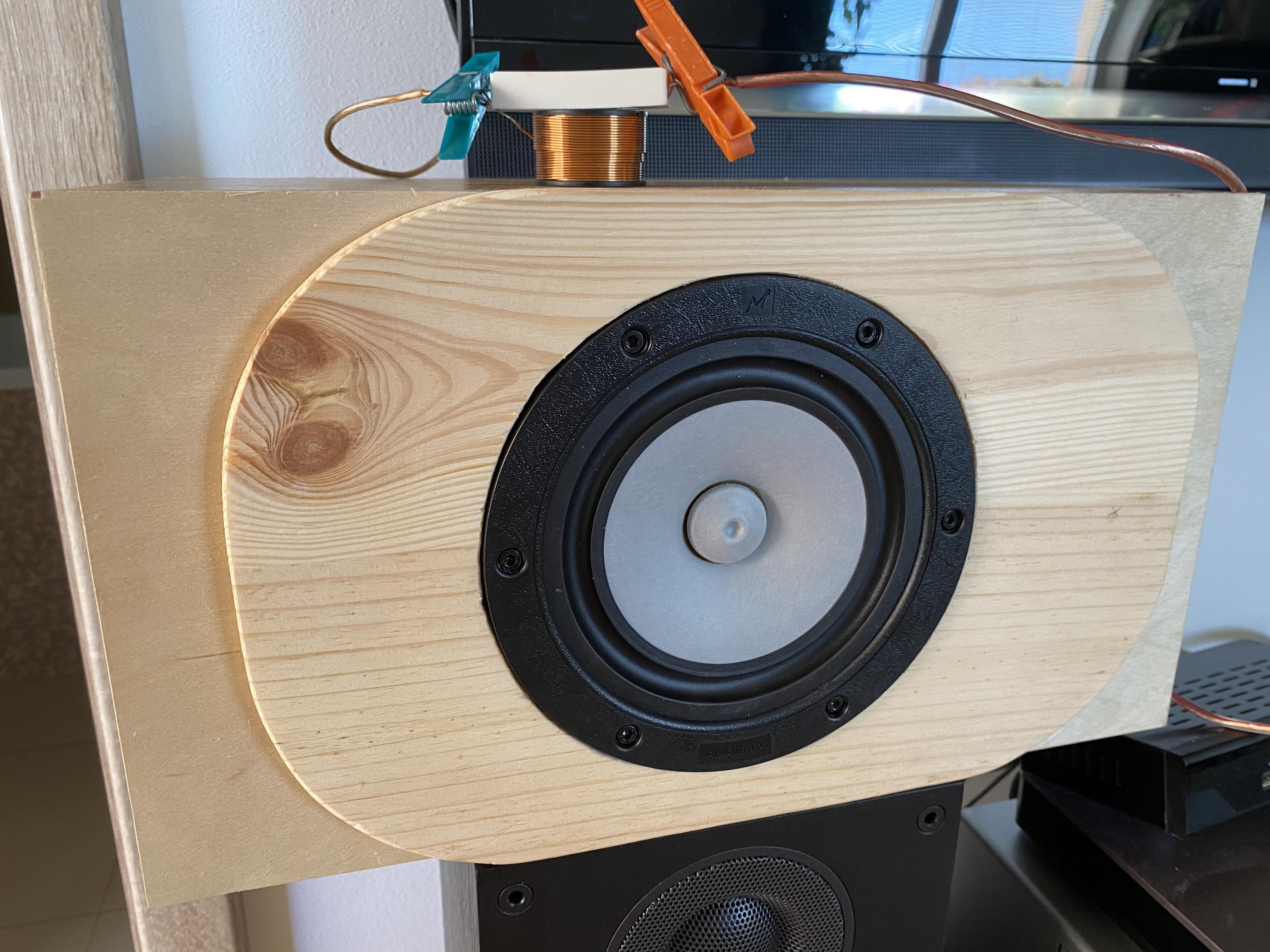

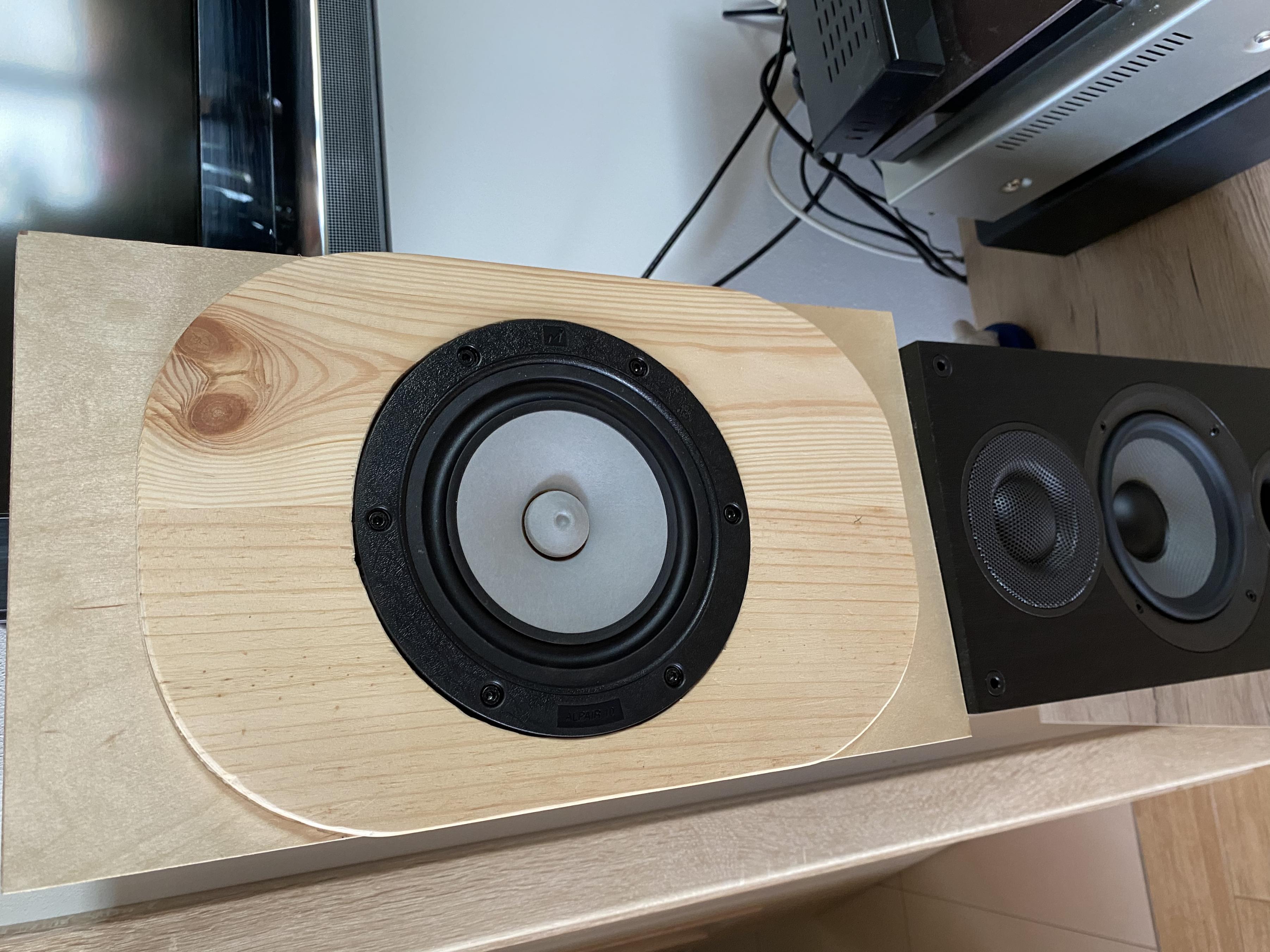

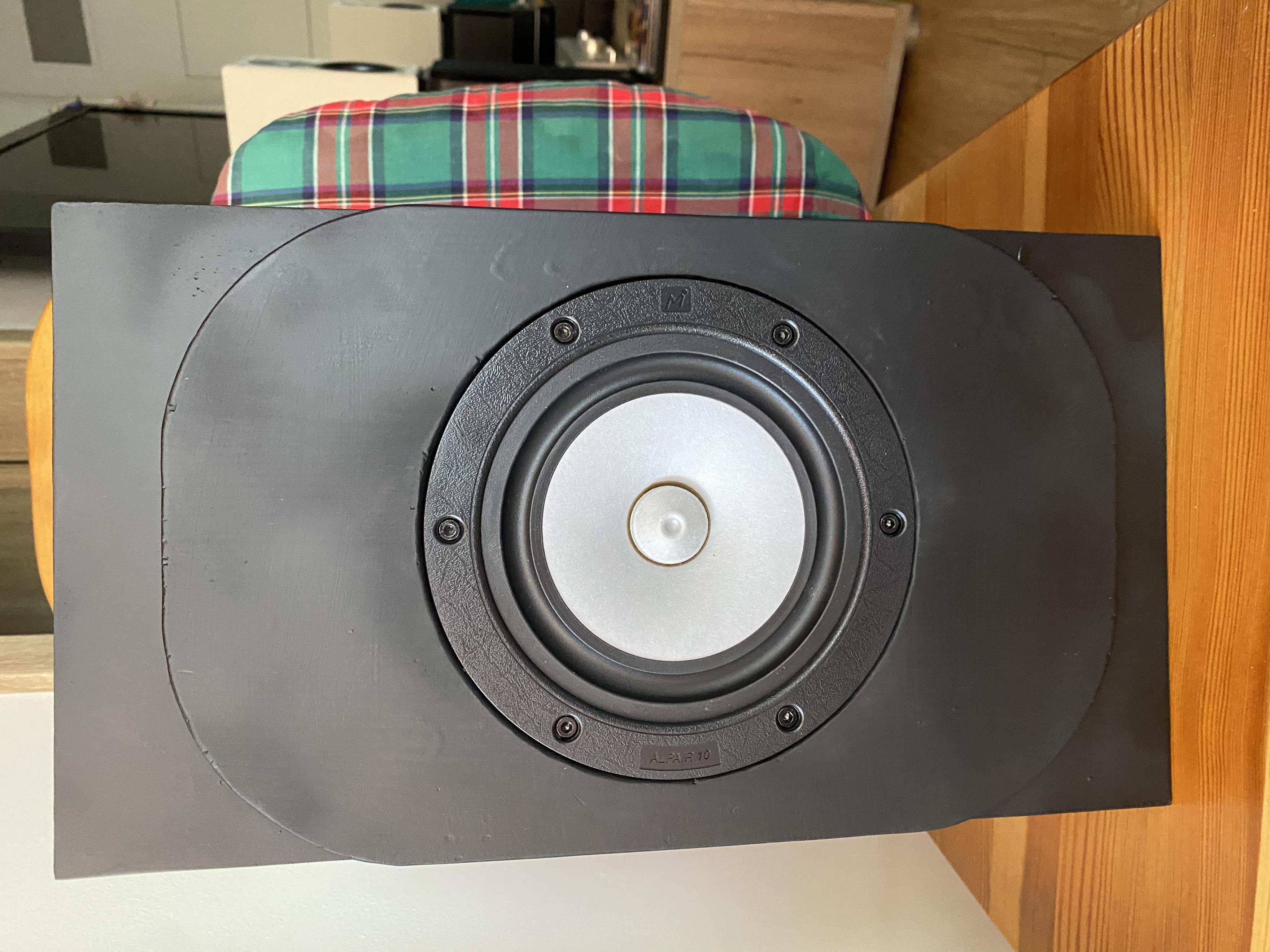

Sealed box done.
Sealed box, 12 liters, done. Listening period begins. My first impression is that there is plenty of bass. It is rather soft and does not go deep. In fact, there seems to be more bass than with previous ported prototype. It looks like it was tuned too high. Or there was some other issue with it.
I painted the box with black color. The result is rather ugly, but I can live wit it. Or better, not sure if I can do it better.

mashaffer, the rear fired woofer is fundamentally a 2.5 way, so yes you need to cut the top end. If you don't it's going to act more like a small baffle that sends midrange behind the cabinet.
