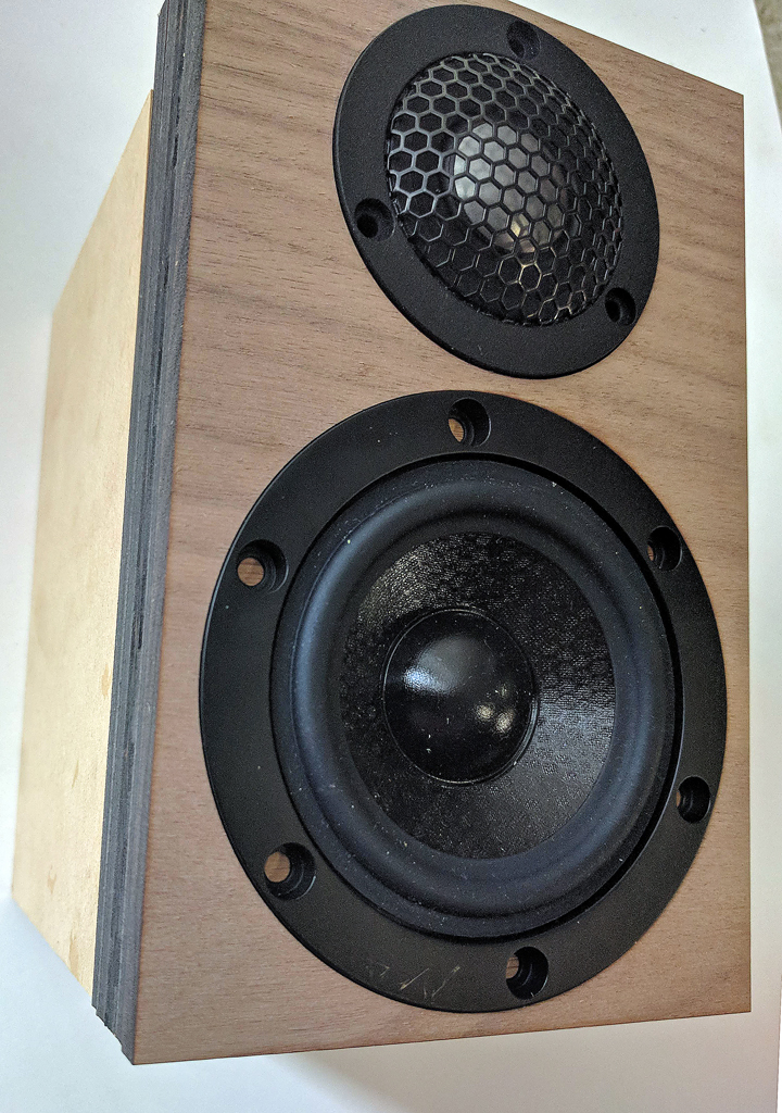

Is that because diffractions in the vertical plane are less detrimental to imagery? They will still cause ripples in the frequency response.In many speakers you only really need to worry about the vertical edges.
If the diffraction were only taken care of then we wouldn't be having this conversation.
Obviously. 🙂 The subject keeps coming up though, I think it's interesting.
Typically vertical diffraction (ie from the top edge) is not as great an issue. Diffraction off the sides will directly affect image/soundstage.

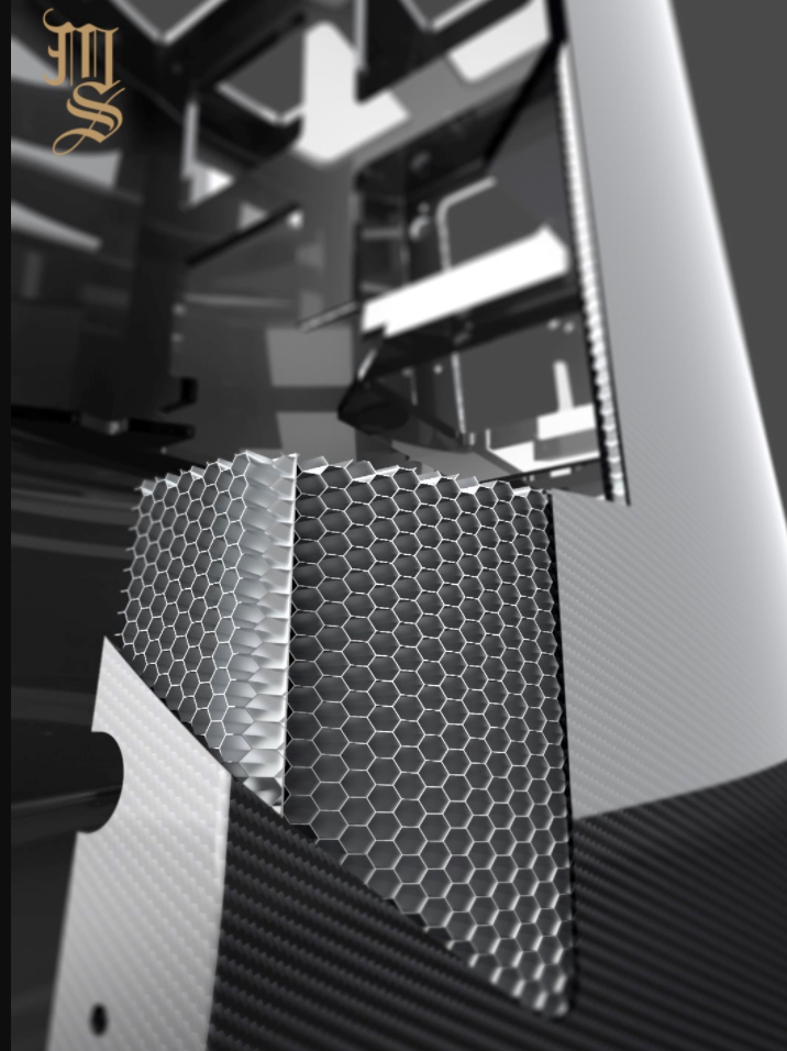

Years ago I made a fiberglass/marine honeycomb woofer box for my car. I don't think I ever managed to get it sounding even half way decent. I definitely see how problems may be inherent with composites, regarding acoustics.
About your aluminum to cfrp comparison- the properties of those two are very different, albeit I can see why they would behave acoustically similar, in that they are both way, way, stiffer than wood. Still, the average carbon composite is over twice as stiff as AL alloy. And it's about 40x stiffer than MDF assuming correct fiber orientation. But I believe carbon has positive damping properties, where aluminum is notorious for being harsh. Just put any cyclist through a punishing ride on a carbon frame vs an aluminum. It's gonna be 100% of the test subjects complaining that the AL frame beat the hell out of them, compared to carbon. I wonder that carbon is just so stiff that it cannot be made thin enough to 'give' in a way that's required. This has been a classic problem in the ski/snowboard industry, where historically carbon was rarely implemented because it made the boards so darn stiff. Still, high-end cabs are out there, like the Magico (cfrp/al honeycomb). Not to mention there are great performing carbon instruments.
It's got to come down to implementation IMO. I can contradict everything I just said by bringing the modulus of steel into the mix. It's about 25% stiffer than standard issue carbon/epoxy and yet steel frame bikes are the most compliant. Of the three, aluminum is the least stiff, by over 2x, and is the 'harshest material. Steel is the stiffest and is the most forgiving. This is to do with other factors. Steel is also hard and ductile and can be drawn to very thin walls and still be safe. To get the same compliance with carbon, it may be that the walls are too thin, and hey, it's half plastic, so easily damaged. Aluminum is so much less stiff, and much lower in tensile strength, that it has to take advantage of much larger physical geometry, i.e. larger tubing diameter. Yet AL frame bikes tend to be among the lightest because al is just that much lighter than steel. If you up your tube diameter with steel to increase the stiffness, you then hit a limit because the walls are now too thin to be safe; but if you maintain wall thickness your steel frame weighs twice that of the AL one.
For me, the main advantage of carbon is that it's easy to work with and much cheaper than metals. The reason it is cheaper than metals is that most of the metal is ultimately waste material because the process is subtractive. With composites you only use what you need. Plus it's obvious other advantages like being super lightweight.
The ultimate material, I'm talking real word here, not diamonds, would be something like gray cast iron. Products like Durabar gray iron are a sort of gold standard when it comes to vibration damping and stability, which is why it is the top choice for frames and bases of large precision machinery. A Durabar cabinet would be insane! Heavily insane!

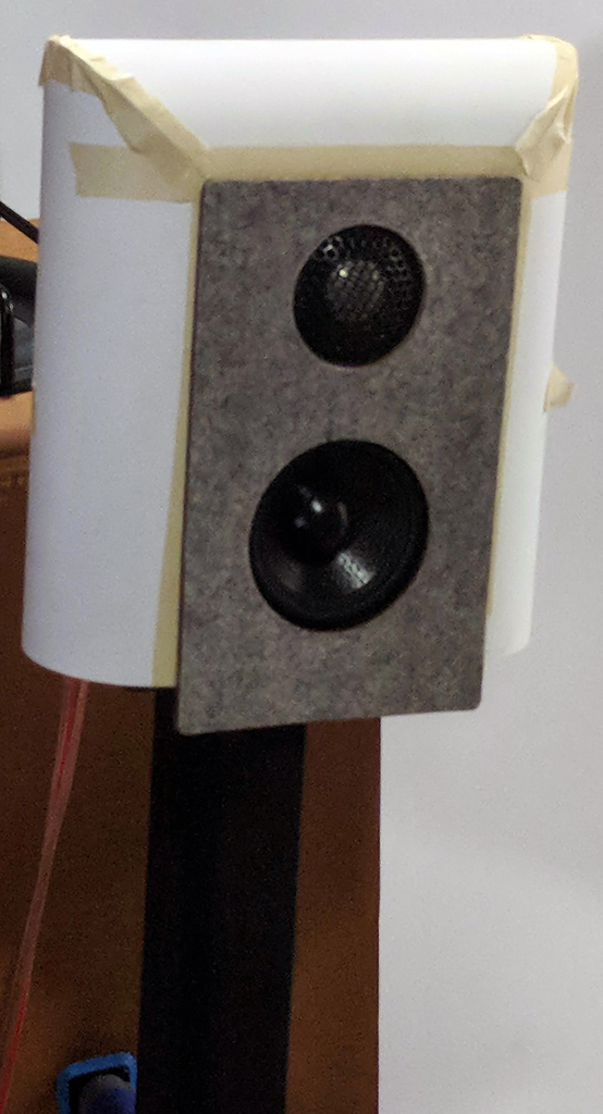

I've done listening tests and measurements w/ and w/o the edge. If I mess with the tweeter timing to make it come way sooner than anything it makes it easier to hear a difference. IMO a large edge makes high-frequency things harder to localize.
Don't forget you can simulate an edge radius in virtuixcad's baffle sim.
My speaker is still a WIP.
Moulding | Fypon Decorative Millwork
