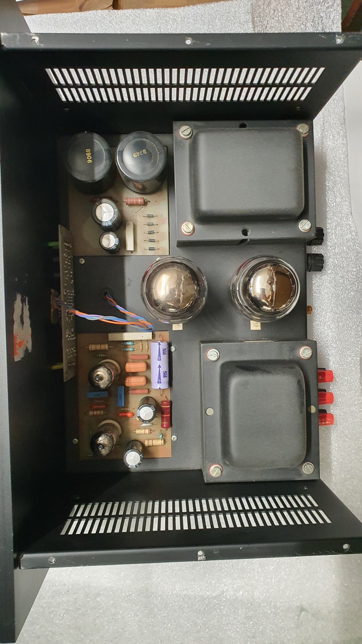

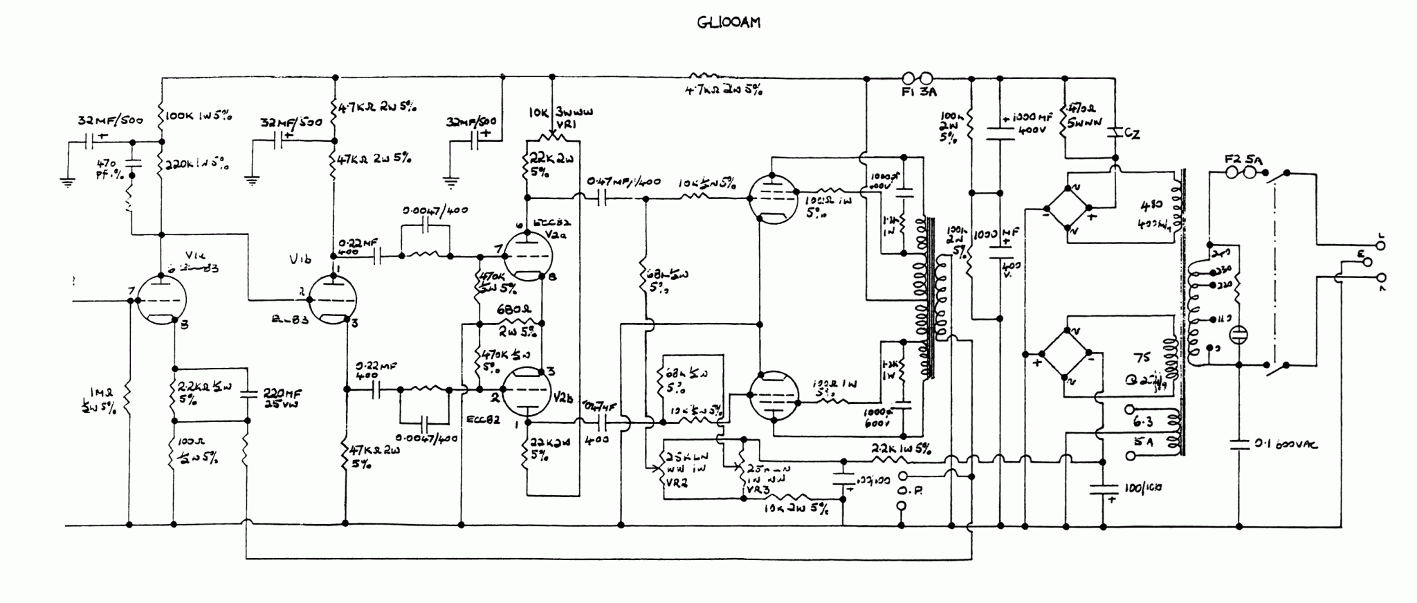

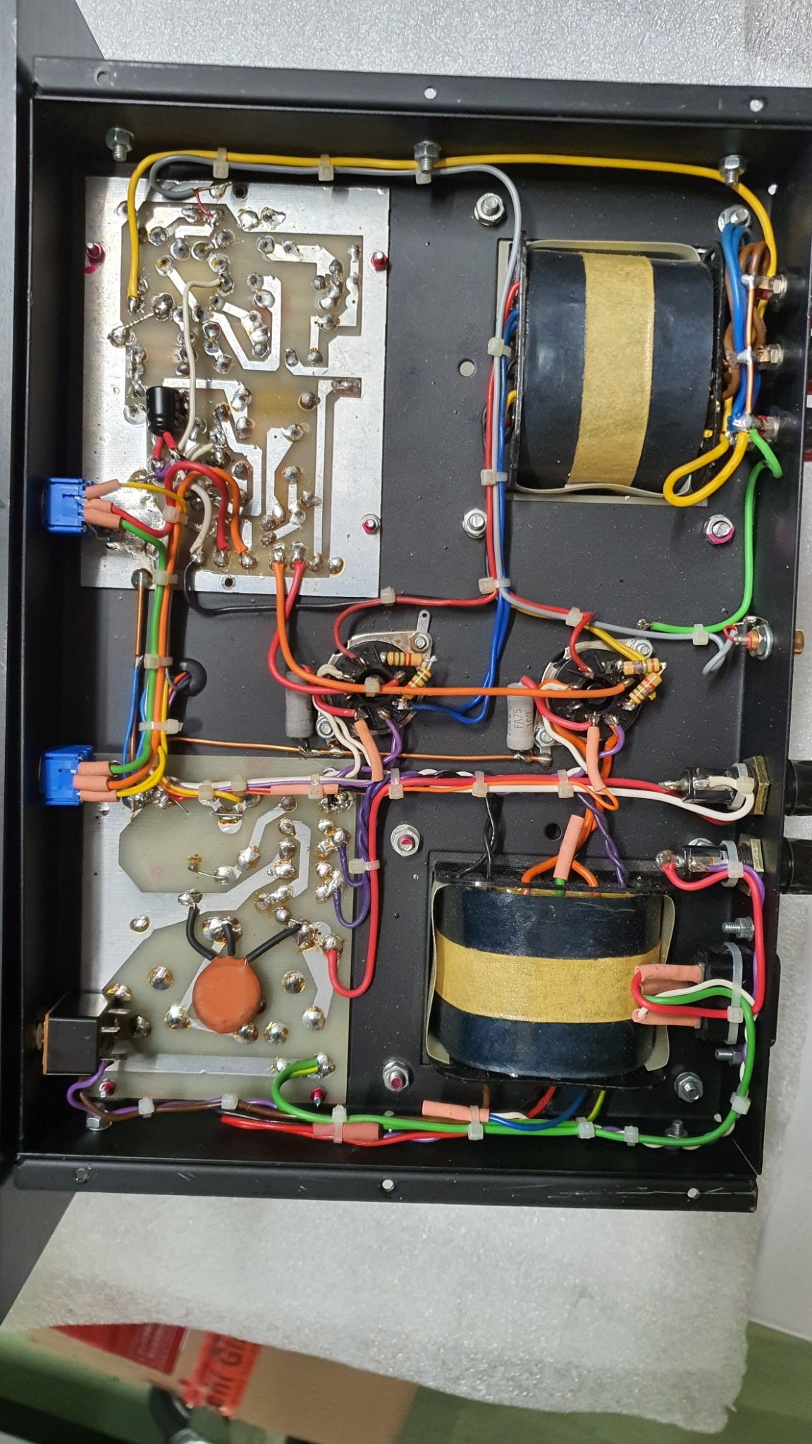

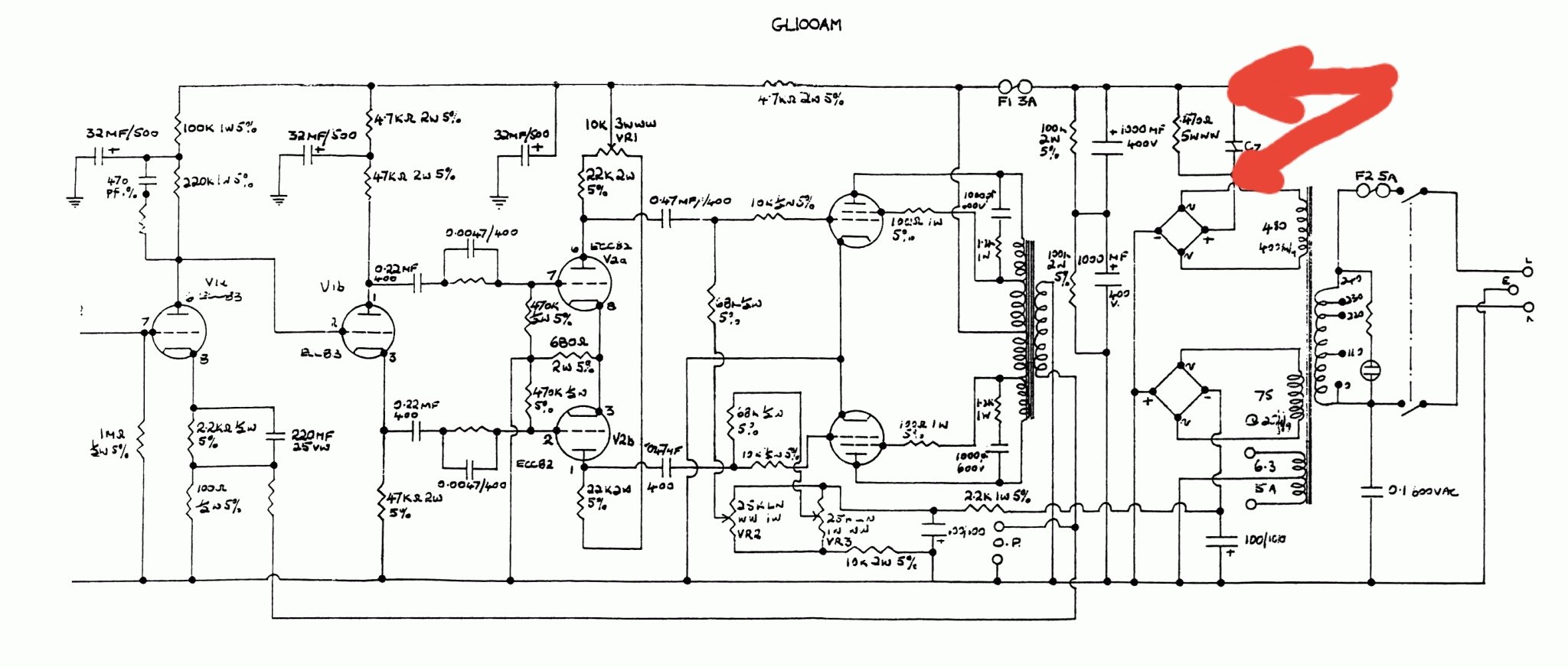

Can someone please explain me why this amp sounds bad? Is there bad iron or schematic is not optimal, personally I would do phase splitter differently. I've build one PP KT88 amp and it sounds very good. Here I have no clue why Grant is so bad.
This is the only schematic, which can be found online.

There is no cathode resistor for the power tubes. How do you measure and adjust the bias?

The power tubes are fixed bias, there is a negative voltage supply in the schematic. The lower bridge rectifier sends (-) voltage to VR2, which adjust the bias of the power tubes.

That's a Williamson circuit and there's nothing inherently wrong with it, that I can see. It seems that there is no way to measure the output tube's bias. If they are not adjusted properly the amp is not going to sound as good as it should. A 10 ohm resistor needs to be inserted between the cathode of each output tube and ground, and the DC voltage across those resistors will help properly bias the tubes. If the amp can't be modified, a set of sockets for measuring bias might work:

There is also a pot, VR1, to balance the driver stages. If this is not set properly, there will be a lot of distortion going to the output stage. Voltages at the plates of V2a and V2b should be checked to make sure they are roughly equal. The proper way to check this pot is with a 'scope, but if that isn't available, making sure the plate voltages of V2 are equal is the next best thing.

There are TWO bias adjust pots, one for each output tube. But no way to determine the idle current being drawn by each output tube.

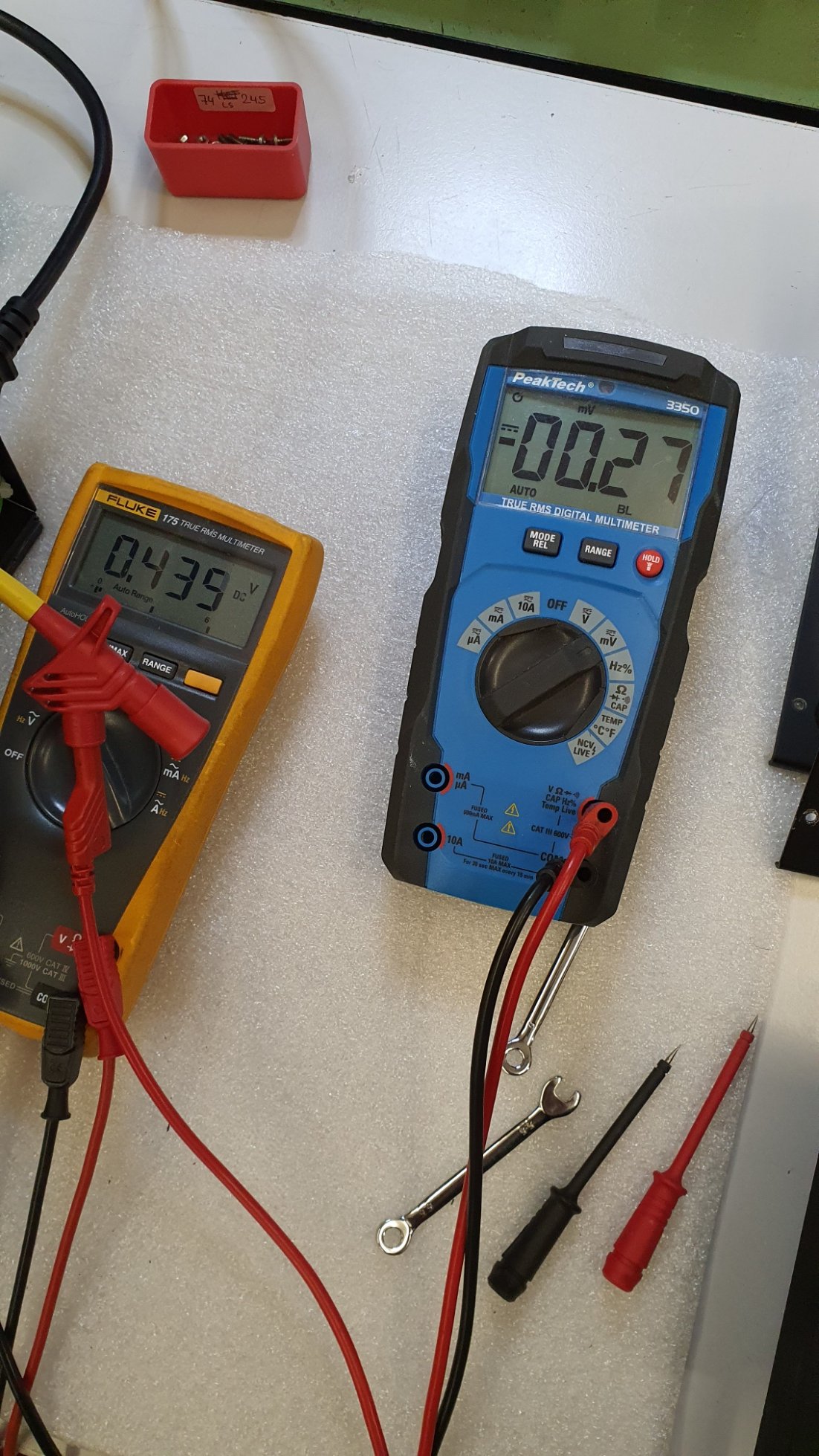

If you measure the voltage on the 2 ends of capacitor C2, you can deduce the current running through the 2 Kt88 bulbs. We adjust VR2, VR3 so that the G1 of the 2 Kt88 bulbs has the most negative value, then the 2 Kt88 bulbs are considered not to conduct. Then gradually adjust VR2, VR3 to have the current running through the Kt88 bulbs at the desired value of about 50 mA ÷ 60 mA (based on the voltage change on the 2 ends of capacitor C2). You can adjust it like that and see how it goes.
But before that, you need to make the 2 tube V2a, V2b work in balance by adjusting Vr1 so that the voltage at pins 1 and 6 of the 2 tube is equal.

What is the value of the feedback resistor at the front driver? It's not printed. Did you install one...of what value?

Withoiut working the detaikls i’d loose at least one of the first 2 gain stages and the phase splitter turned into a proper LTP with a CCS.NDo what you wish wish the output stage bias.
Iron plays a big role, as does the power supply. Not exactly sure what is happening withthe dual bridges, buyt better diodes (Schottky), and some poly caps (poly).

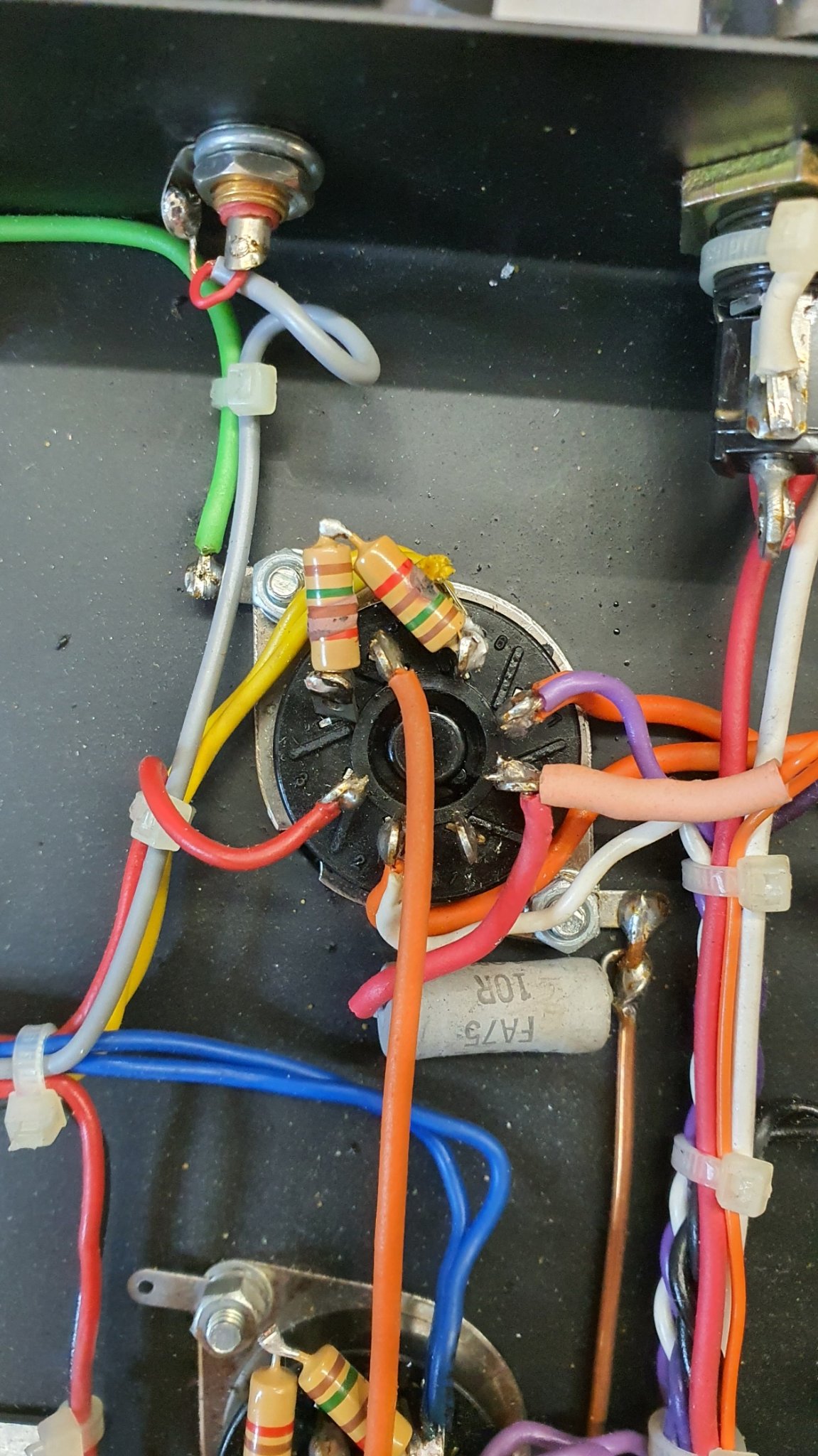

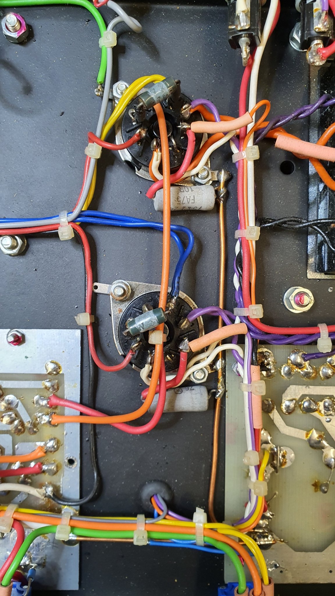

Today I have some time to tinker with amps. One of them not let you to adjust bias, found out that 100 Ohm resistor, witch connects grid 2 of KT88 to the output transformer for UL mode are toast. Measured anode voltage it is 570 V, negative supply for bias is for one KT88 can be adjusted and is about -65 V, another one is something -80 V. And both KT88 have cathode 10 Ohm resistor, on the picture is voltage measured across this resistor.
Here its better to understand how it is connected, in my amps values can be different.What is the exact diagram for the led comparator in post 11? Values and components type are missing and it’s connected to…?
As you posted, the Ia current of the 2 Kt88 bulbs is very different. One bulb is 0.27v and the other is 0.435v, almost double. You need to adjust it to have the same value and it is probably more reasonable to change the value of the bulb from 0.27v to 0.435v.

Break KT88 cathode circuit, put 10R 1-2W wirewounds in each leg to ground: and wire cathodes to access sockets to correctly ascertain the correct currents using the Volts setting. A little degeneration does no harm and reduces distortion.
Let Ohms law do the rest.

So, now this thread can be also repair attempt🤣.
Today I've changed resistors from grid 2 of KT88 to OT. And now I can adjust bias on both tubes😏, but not for long time, it endet up in spectacular firework inside one of KT88😅. And also it took grid 2 resistor, wich I have replaced and original installed was burnt. I've repaired many of tube amps and build some, I think this seams to be a faulty KT88. OT must be OK, but I need to measure it. And some pictures of amp, white things inside KT88 after firework)
