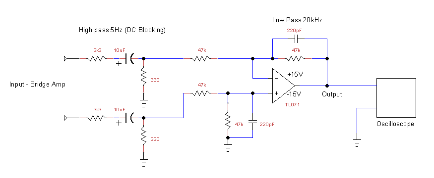

Hello!
I was playing with my class D (TPA3255 from FOSI Audio) and it is really difficult to measure noise at the output without filtering and converting the bridge signal to a single ended signal. I tried some passive hacks, but some other 60Hz noise comes in.
In addition, if you don't filter above 20kHz, noise from the power supply also shows up.
It's not easy 🙂
So I've built a quick differential pre-amp in a protoboard limiting the frequency from 5Hz to 20kHz (aproximate values).
Then things got more stable. And I noticed that you need to connect a load - I used a 8.2ohm resistor.
I'll put this in a box cause it's handy.
This is the schematic of the circuit I've built and tested.
I use my scope always without the cord ground disconnected - I know what I'm doing in the workbench and it is only for my own use.
I think this way we play safe and get a reasonable result to check noise. Input impedance is 3.6kohms so it will not interfer with the amp.
First the signal from the amp is decoupled removing the DC and divided by 10, so as to not overvoltage the opamp.
Then signal goes to the differential unitary gain pre-amp.
The 220pF capacitors do the low pass filter, limiting the bandwidth so as to remove the high frequency switching signal.
We can improve the low pass filter to be second or third order so as to cut sharply above 20kHz.
We also can put more gain in the differential amplifier if needed - just play with the opamp 4 resistors.

Hey cool! Thanks for the quick answer!!
I will have to see as I don't have DIP components here (only SMD) - so no quick answer.
Last week I already tried to measure with REW and an analogue front end - but if BW is not limited enough I am afraid to measure alias frequencies and won't be able to see the true noise. So a LP will be neccessary, I guess.
One thing that I observed and what does not make any sense to me - the noise spektrum arround 6kHz is moving all the time by 1-2 khz up and down.
So each snapshot the oscilloscope shows the spectrum at a different spectral position.
Can it be a mixing artefact as the AMP has a stereo output - that the noise is actuall higher frequency noise and mixed down by the two independant PWM frequencies?

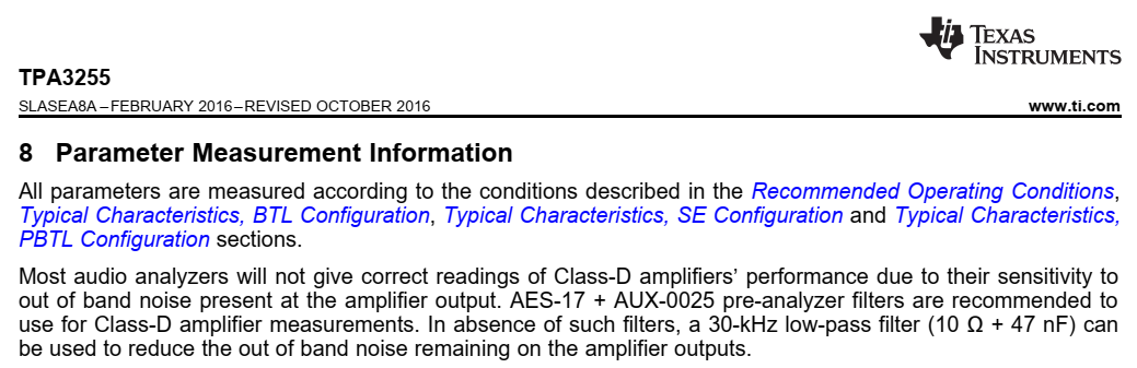

Hello,
Yes, it might be an intermodulation between the high frequency switching frequencies.
Something like one is at 500kHz and the other at 506kHz.
Most chips have a feature to synchronize the clock in a master/slave topology so they go together.
Is it possible to somehow deactivate one of the amps just to check if this ghost frequency goes away?
Some kind of mute? If it stops, that's it.
Do you have the chip specs for your board? I couldn't find it. It just mention Sure T-AMP
Regarding measurements, TI datasheet, for example, mentions that a low pass filter is in fact necessary to measure class D amps.
It seams they have a special pre-analyzer filters when they take measurements.
See below:
See below:
