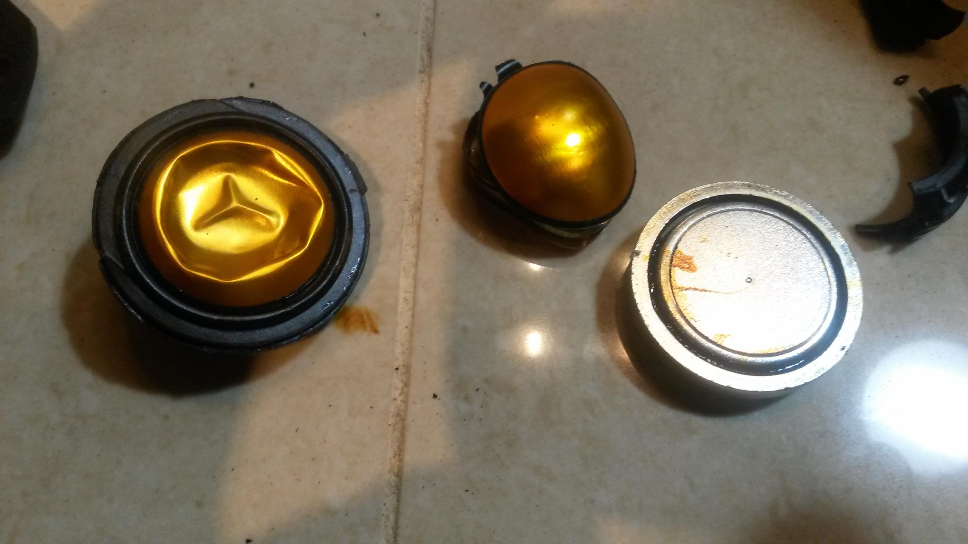

Sounds like an Audax. In which case, once you figure out which of a dozen different versions you have, you may get a replacement coil/dome assenbly. What markings are on the tweeters? Should be marked for impedence, then take one apart, see if there's ferrofluid. That will narrow it down quite a bit. You should be able to get close enough to adjust the level and be pretty good.

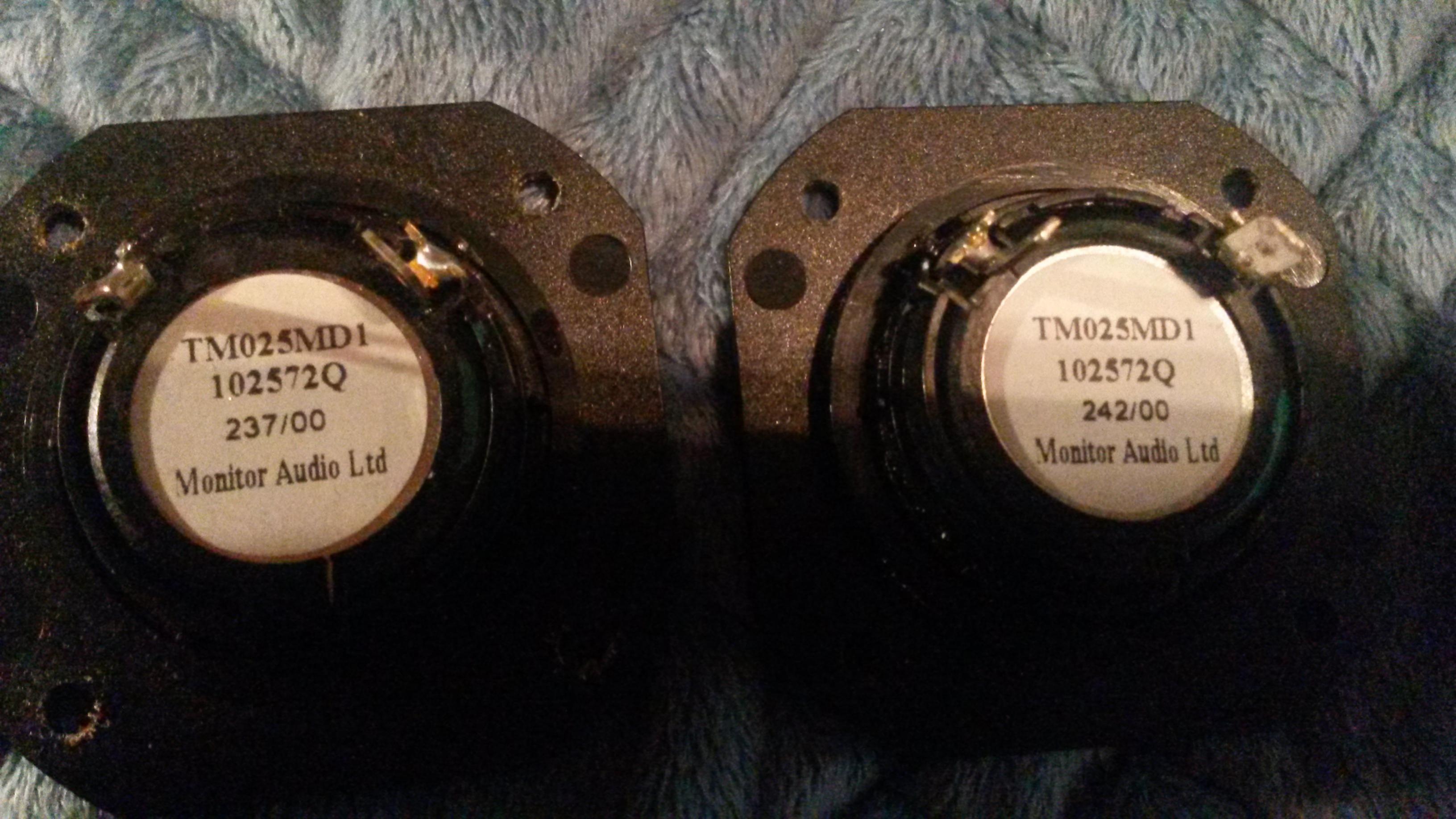

I'll try to get a pic of the tweeter back up today. I'm not sure of the impedance unless it is within the tweeter model number. If the tweeter is indeed an out of house part Monitor Audio has placed one of their stickers over the back of the tweeter.
Audax was very big in the oem market. I have some from Yamaha speakers that are marked Yamaha(though the woofers have Seas markings).
I'll try to gather some decisions and Crack one open this weekend. I'd tried to figure out how to separate the tweeter from the plastic bezel.....further investigation will be needed.

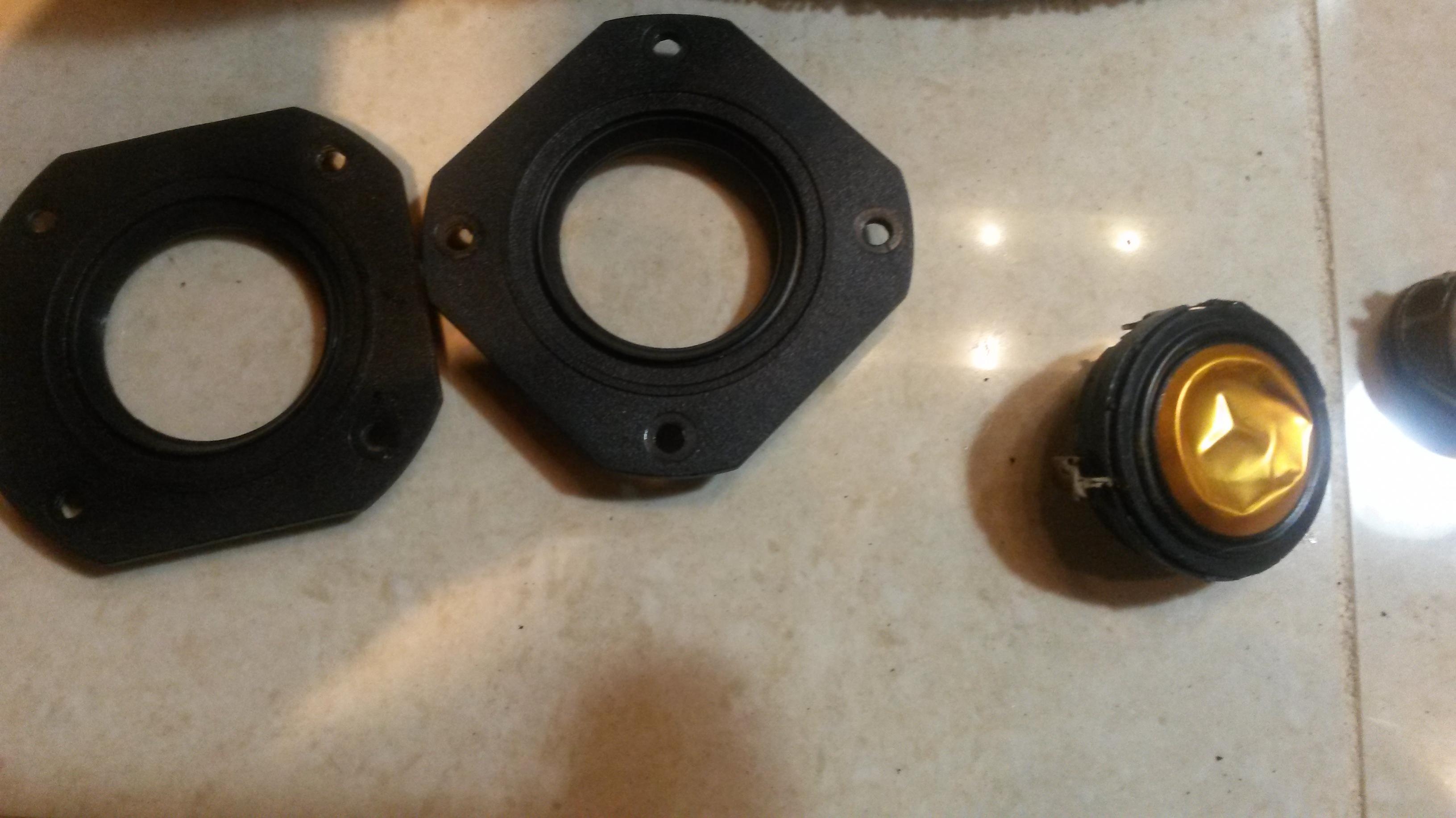

OK so I busted both tweeters off of the bezel. Out of magnets are 1.25"
Domes measure at 1"
Ferro fluid is there.

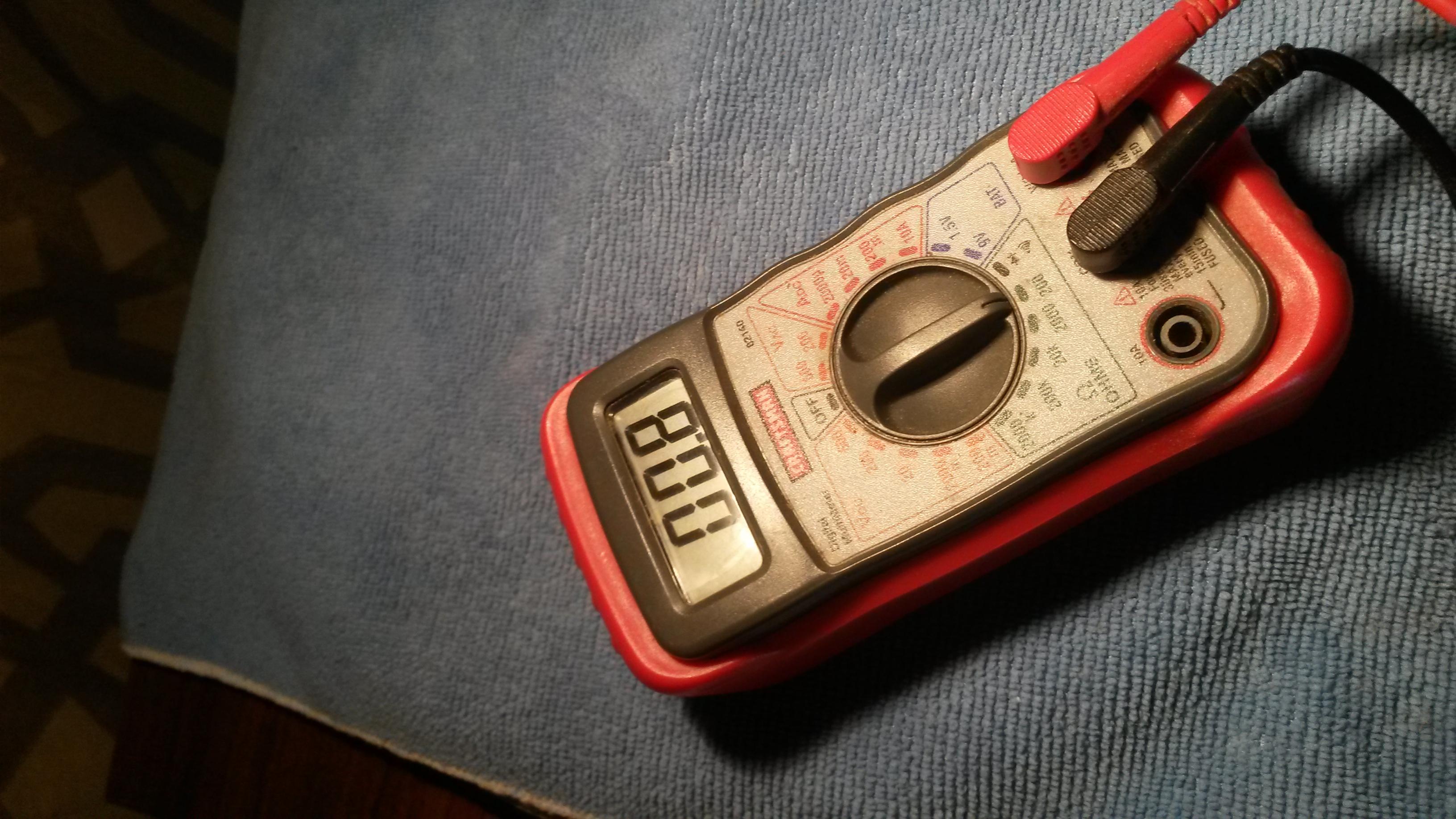

Still was not able to get a ohm measurement.

I know this sounds a bit obvious, but have you tried pealing the sticker off the back of the magnet? It may be hiding the manufacturer information.
I just measured a couple of working tweeters on the 200 Ohm scale, and I got 6.6 and 7.5 ohms. 0.8 makes no sense at all! Except broken! 😀

I'd guess this is a 8 ohm 88dB tweeter with a 6" 2.5 way and a 4uF tweeter capacitor. So preferably 8 ohms nominal, which is 6 ohms DC.

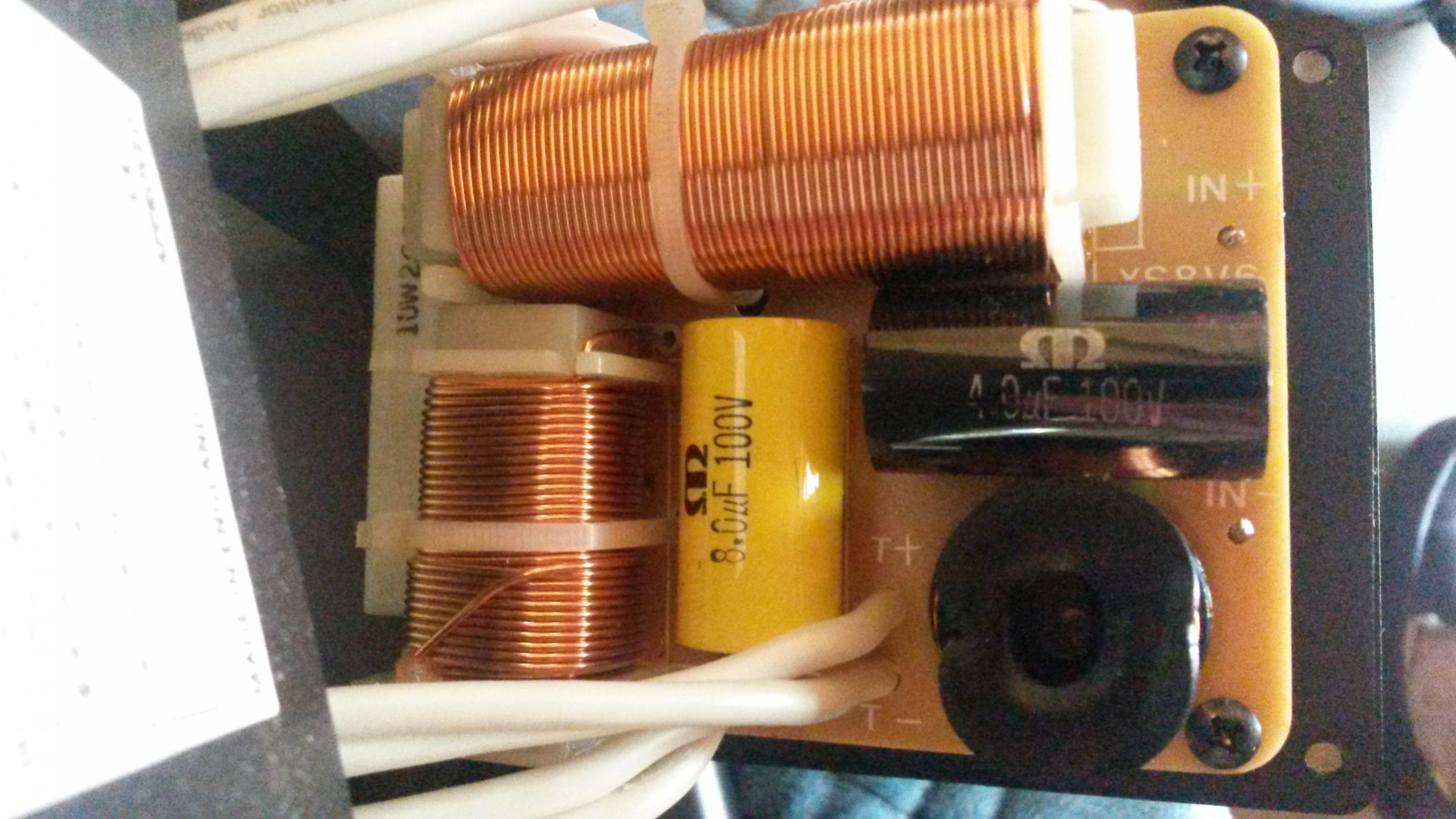

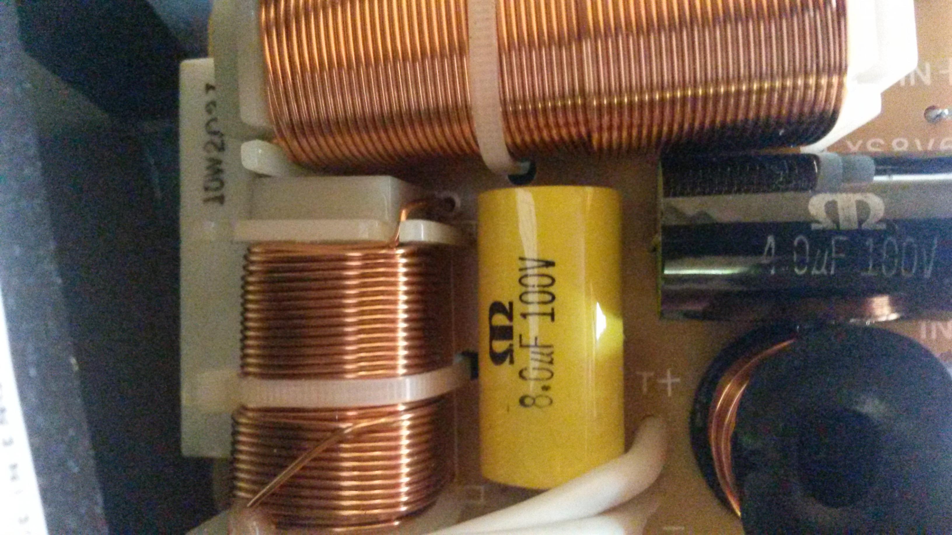

I can tell you what that 2.5 crossover is just by looking at it. About 4mH on the bass, about 1mH and 8uF on the midbass, and 4uf and about 0.3mH on the tweeter. The resistor might be level adjusting the tweeter. Or it might be in the 8uF shunt on the midbass.
TBH, it can be improved. But that's for another day. 🙂
I actually have to no avail.
