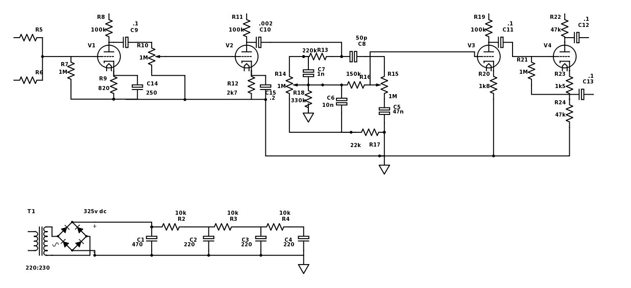

I'm having some issues with an amp I'm building:
When I turn the volume pot past 3 o'clock, some very undesirably screeching occurs (high frequency). What could be the cause of this? Circuit and sound file are attached!
Output tubes are 2x6L6 PP with 470 ohm screen resistors, grid biased at -30v for 38 watts of power.
The 50p cap in the tonestack should still be changed to 500p, I just didn't have one laying around.
https://soundcloud.com/mk5-studios/amp-nosie/s-3io9u
In the clip I first play a note, then I turn up the volume. Second time you hear it, i'm turning it up with the guitar plugged in, third time is without guitar.
Layout.
The real cause is GAIN. You have a gain of over 5,000 there, plus maybe 10 in the 6L6es, 50,000. If the *least* signal sneaks from 6L6 back to V1, it gets amplified again, and again.
Keep your big tubes and the OT wires very far from V1.
Also V2 output side should be very-far from V1 input. Not so much gain here, but they may be in the same bottle.
I do indeed still have to add grid stoppers. I didn't because the Marshall plexi 1959 doesn't use them and that one's also quite high on the gain levels. The OT wires are as far as they can get from V1(12ax7, so together with V2). I'll post updates tomorrow!
Layout.
+1 on the layout and lead dress.
Even if you were to remove the power section, there is enough gain in the preamp, for squealing to happen on its own. Basically, you have stepped into a minefield.
I strongly recommend taking a look at the designs on AX84.com, which are fully baked, complete with working layouts, and with a whole range of preamp gain choices and power amps.

I would also add that those cold-biased later stages with the 2k7 and 1k8 cathode resistors are going to suffer from harsh/fizzy distortion. Probably you should swap around the cathode resistor values of the first two stages. Your tone stack really needs to be driven from a cathode follower, and/or you should also have a warm-biased stage, with something like a 620 ohm cathode resistor to give you some good thick crunchy Marshall style distortion.

So... Grid stopper at v2 helped, but the problem still occurred, although at higher gain.
Next, I tried adding the "pot stopper" ,10k, which made the amp act really weird. Barely any volume, except at one very specific spot on the gain pot , about 2 O'clock.At which it goes to max volume...
I've replaced the pot with a 1M7 pot, that seems to work for now.
...which made the amp act really weird. Barely any volume, except at one very specific spot on the gain pot , about 2 O'clock.At which it goes to max volume...
Your amp is probably oscillating continuously at a high frequency (too high to hear, it's usually at radio frequencies). You may be able to hear or see interference if you take a portable radio or small TV near the amp, which will confirm the amp is unstable and oscillating.
If you're sure the layout is good, RF instability is basically caused by the amp having too much gain at too high a frequency. You have to take measures to reduce the amps gain at frequencies above the guitar range, and that starts with having a grid stopper on every stage. Also, are you using shielded cable on the input? I consider that a necessity, even if some very old amp designs didn't use it.
Beyond grid stoppers on every stage, you might have to add additional capacitors from gain stage anodes to ground. But I suggest starting with the grid stoppers.

First and second samples clearly sound as HF oscillation, third one is strong buzz which should not be there, all 3 scream poor grounding - poor shielding - poor layout.
Killing gain or filtering highs strongly enough as to make sound muddy attack the symptom and not the main cause.
Adding grid stoppers is fine, because they usually work above the audio spectrum, but you still need to improve layout.
The old fine amps you mention, certainly had tens or hundreds hours in development and tweaking before reaching the commercial form you or I know, with most bugs ironed out.
You either *faithfully* follow an old tried and true layout and grounding or be ready to sweat it 🙂 .
