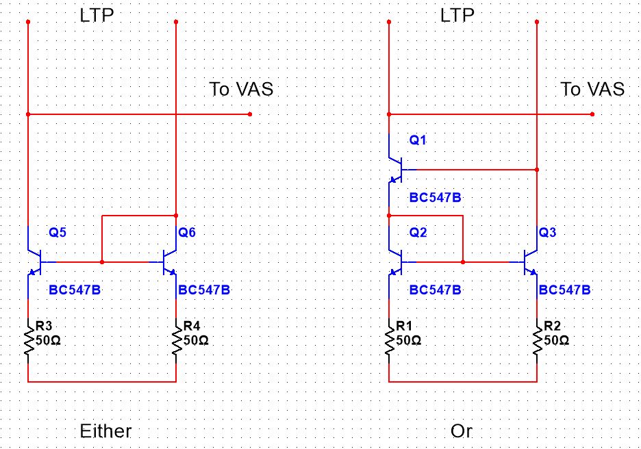

Backwards WILSON current mirror?
I must have stuck my head somewhere we should not discuss.
Playing around with possible "improvements" I dropped a Wilson current mirror into my input stage. Absolutely normal LTP, ccs and mirror, light degen etc driving a very conventional Darlington single side VAS
FAIL. It drove one side to the rail. This is with the feedback transistor and the added Wilson transistor in the negative (feedback) leg. Yet, if I reverse legs, it works. (does cut the offset in half, even while it raises the distortion by an insignificant smidge)
What the #%*& am I missing?
Umm... I mean... that's the only way it works )
Comparing to simple mirror, Wilson one will always be "backwards", otherwise, at the other side, you always have Vbe * 2 offset (plus some small addition because of the emitter resistor) from the rail. So it will always send the output to the rail the other way round.
Is that what you mean? )

Well, that is exactly what it was doing. Seems odd none of the text books mention this at all. I find very few places where it was implemented, and some did not have it backwards, leading me to believe they never tested their design.
I now still have no idea if it is worth it. In simulation, no; but simulation does not take into consideration my level of matching of the various input pairs.
Thanks, I thought I was loosing what little mind I had left.

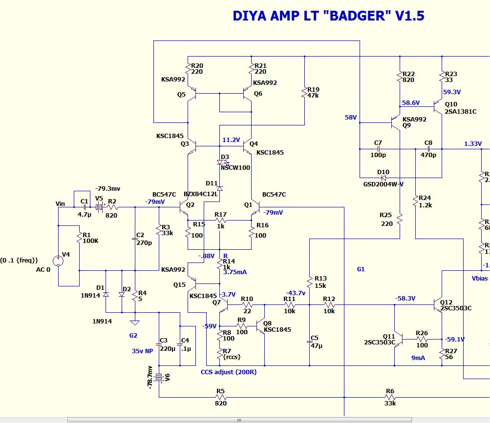

Cascode - "bang for the buck" !!
Yes ! do the cascode ....
You -
A. can use lower Vsat CM/LTP semi's .
B. many more options for devices (lower Vce).
C. higher Z at cascode will lower THD more than a wilson CM.
I used a zener as cascode reference on the "badger". There is
another "way". Either reference it between rail and the LTP CCS with 2 resistors (badger option or luxman) ... the crude way !
OR add a emitter follower off the main LTP CCS for a
"isolated" reference and use a LED "string" or zener/diode/led (D3-11 /Q15 - below) to get the desired voltage.
I was told this will not show as reduced THD (it stays the same) ,
but will impart "magic" 😀 upon the soundstage.
All I know is that it is a valid (electrically) ... way to implement the cascode.

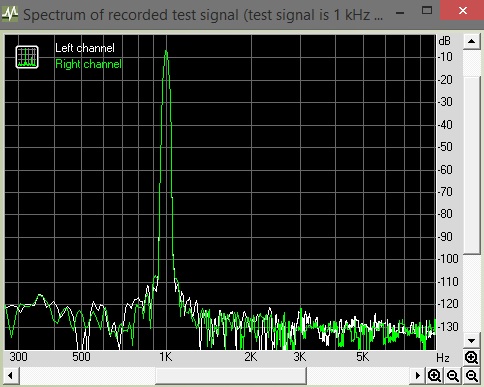

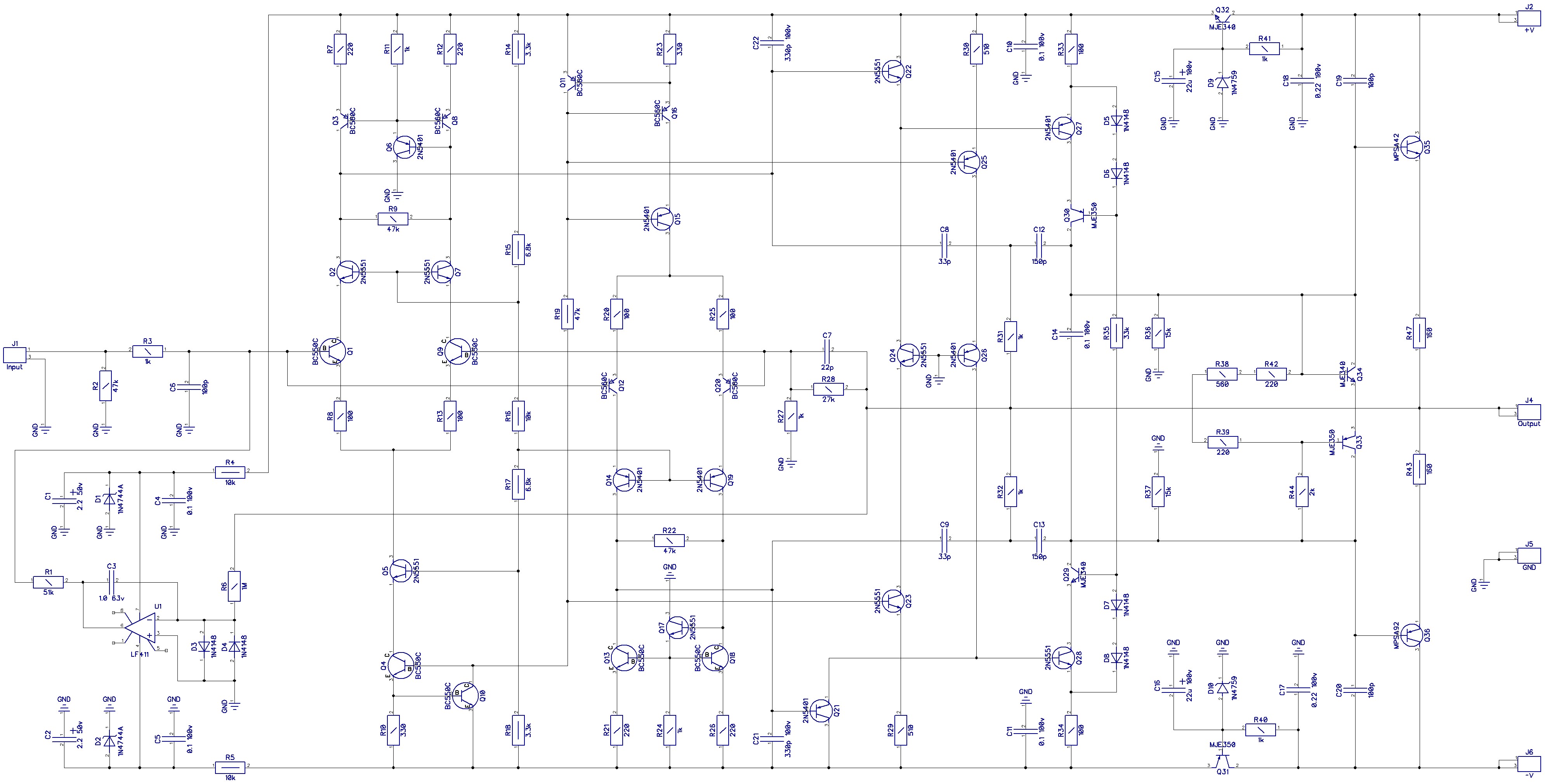

Cascode
As an example - my implementation of the cascode (rather simple, but no problem). I've got 2 LTPs "upside down" against each other, so CMCL improves the balancing ability in situation of real elements tolerance.
This is a live prototype and practically measured spectre for 1 kHz signal. OP is not shown on schematic.
