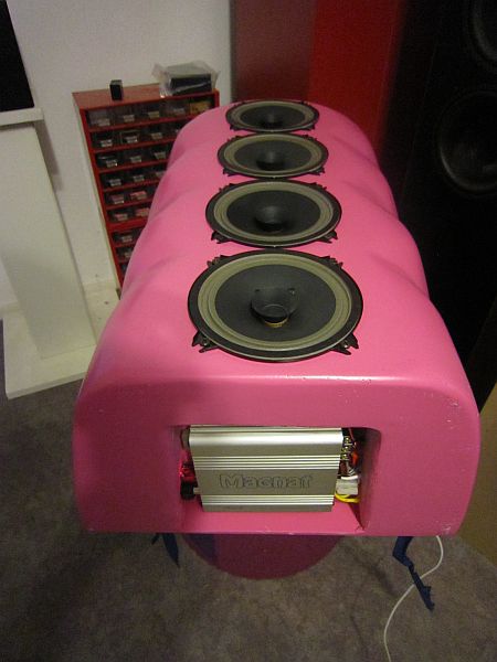

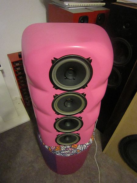

My design is a bit different, I used four 13 cm full-range drivers from Visaton FR 13 4 Ohm version and did a small line array because I wanted directional sound and they don't need a crossover. I used a cheap car audio amp which I had available (I would prefer any D-class amp). Batteries are lipo (will be changed for a stronger ones, also lipo), box is made from fiberglass and carbon and so everything comes together around 5 kilograms of weight.
Sound is very nice for a simple setup and because it uses four drivers it can play very loud. As mentioned in thread, when used with players that have equalizer I usually set to minimum frequencies below around 60 Hz, it doesn't effect sound much, but it can play louder and longer.
After all I'm satisfied with result, but if I did it again I would use 10 cm drivers instead of 13 cm to get a bit smaller backpack.
