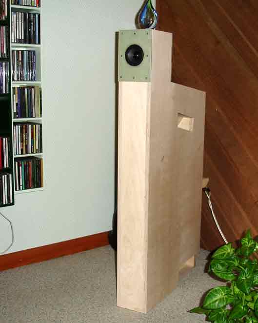

Yes, the F-81 was the starting point for the Naga design, which is now pretty heavily evolved. It is definitely viable in stock "F-81" form though.
I personally love the small Fostex drivers. harder to please than you think though... they are very resolute, especially in the upper frequencies. gotta feed 'em right.
I am having some modded by Dave Dlugos now, actually to offer as an option in the Naga horn... should take things to the next level.
-Clark

yes, definitely.
Thanks for the compliments! It is really fun handmaking things and always pushing myself. It is athletic work, (mind and body) for sure. That I can do it for a living is my customers' greatest gift to me.
A subwoofer is indeed easier to join with a small fullrange (in general). The F-81 in stock form, properly setup will actually dive down to around 50hz(!). If you do the math of the box, (~12 ft, driver roughly at position zero) this confirms the theoretical ability of the box to go that low. It is essentially an organ pipe in that case then, except for the doubling expansion (60mm to 120mm, constant width) of the F-81. The F-81 is not super deadpan flat bass, (no horn truely is...) but I found this horn bass to be tolerable, with tweaking eventually enjoyable given the virtues of drivers this small. I would say that in the critical ranges for most music, the F-81 gets the bass done well, actually.
The Naga is slightly better in bass flatness than the F-81, but to be honest, I have concentrated more on getting the midrange to really "happen" than anything else. That should let you know what I think of the bass of the stock F-81...
I offer the Naga with a subwoofer which as a system goes down to 20hz, but I find a sub with the naga to be unnecessary for the general customer (and considering a difficult BLH-Bassreflex meshing, it is easier for most people to screw up than get right, IMO).
