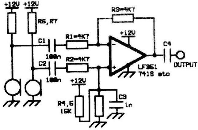

The brown square is my desk and the yellow one is the play area of my brother the only problem is that he make a lot of noise when playing so Is ther a way to remove all noise picked by the electret mic from the dynamic mic ? I seen this schematic:
(A Noise Cancelling Microphone)
but how do I connect it ?
Thank in advance
Won't work, though understanding "why" will take some time.
The microphones must be very well matched and close together, much less than one wavelength of sound in air. Wavelength of sound in air varies from 10 feet for deep bass to 1 inch for high treble. So if brother had a large bass drum, you might be able to cancel the boom but not the thwack. Most of the annoying sounds are mid-high frequency, short wavelengths, and "close" is at most a few inches.
