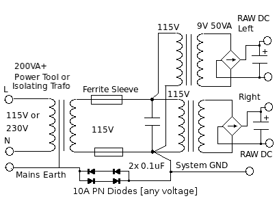

In applications of my Filament Regulator kits, I find that an isolating transformer can be very effective where there's a lot of mains noise.
The first transformer has its chassis connected to mains Earth. The secondary windings are connected to system GND (B-Return), which is only returned to safety Earth through 10A diodes - these give quite good EMI isolation for common-mode noise. !! Caution - Only use this diode connexion if you are SURE you know what you are doing!!
Also, be sure to use some Ferrite sleeves or toroids on the secondary wiring to absorb the really high frequency noise. Wind 3 or more turns through a toroid. Choose a grade of ferrite designed for EMC purposes - the 'inductor' grades are not so lossy.

Rod:
What is the advantage to bonding the intermediate stage to system gnd as opposed to earth ?
I find mains earth to be quite noisy, sad to say. This noise is typically common-mode with the phase wiring.
The diodes isolate us from that, at least up to moderate frequencies. The ferrites are helpful to prevent the noise creeping in through the phase wires.

I have a number of split bobbin types and they are excellent from an EMI perspective as you say, mine unfortunately made so much noise that after 4 yrs of use I retired them, and yes I replaced them with quiet-as-a-ghost toroids.
I try to ground transformer cores when they are accessible for grounding, if for no other reason than safety. I think it is a good idea for the reasons you state as well. (Have seen this effect with some UTC line to plate, and line to line transformers)
Rod's recommendation above with the isolation transformer is an excellent one.
