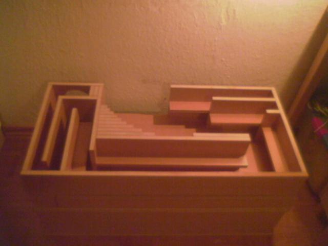

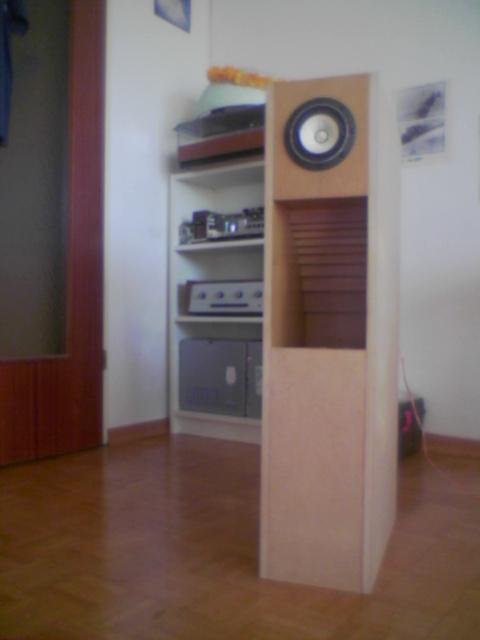

Hi there,

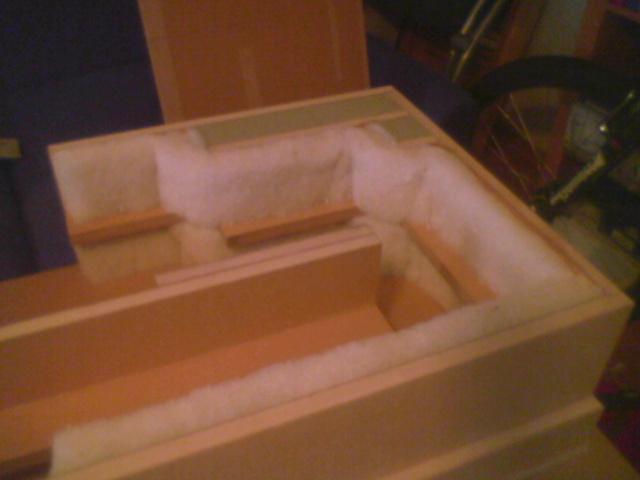

Well, after a considerable break I have finally finished my speakers. They sound...brilliant.
They are currently fed by my (Sony) stereo, which is not so high-end, and an old tube-amp (a bit hum but warm sound). Hopefully my Zen-light is finished soon.
The pics are a bit blur.

I just got a Fostex BK10 kit from Japan which is supposed to be okay for use with the Fostex FE126E (which I've already ordered but haven't received); however, it looks like using this driver will only give me .47" (12 mm) between the back of the driver, and the wall of the compression chamber, which won't leave me much space for any acoustic material on the compression chamber wall.
(The instructions are in Japanese, but they seem to indicate that felt should be used to line back of the compression chamber.)
There are shallower drivers like the FE103E which will leave me over an inch of space. How important is this distance? Should I get a driver that's not as deep? The kit instructions also mention the FE108EZ, the FE107E, the FF125K, and the FE127 as suitable drivers.

Hi All,
Since I have a strange international life and work, my contributions to these conversations are spotty. I apologise for this. BUT I was visiting family over Thanksgiving holiday and was able in that time to complete an original design for a rear firing BLH using fostex FE103E drivers. Following Martin King's advise to keep true to the internal geometry of the fostex designed cabinet, I did one better and tried to keep a continuous expansion of the horn, rather than a stepped expantion, as fostex uses. These are my first horn type speaker (I did a folded TQWT before), so I felt I was taking a small risk going with a shot in the dark design.
To make this short, I made the cabinets with just with enough time to put them together and listen to them for a night before I had to fly back to Asia. There was no dampening in these things and they sounded great!! Warm where they had to be and crisp elsewhere. I did not hear any strangeness that made me think they would need dampening, but they may change some after break in.
When I am back at my home base (out in the field now) I will post some of the pics I have.
Regards fellow single driver horn freaks. I am sold!!
Stuart

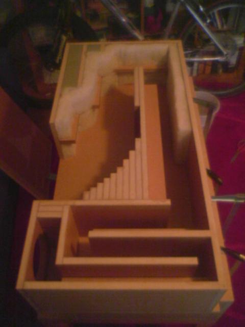

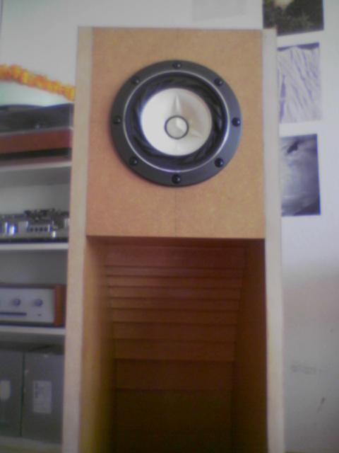

It's quite a heavy beast.
The break-in was fascinating, one could hear the bass developing during play.
My first impression: Definitely not bad for one single driver. Can't wait to hear different amps (+ some fat cable, nothing too fancy though).
And it reminds me that there's a plasma-tweeter project still waiting to be finished...
Oh, and yes, I'm unable (too stupid?) to add multiple pics to one single post.
