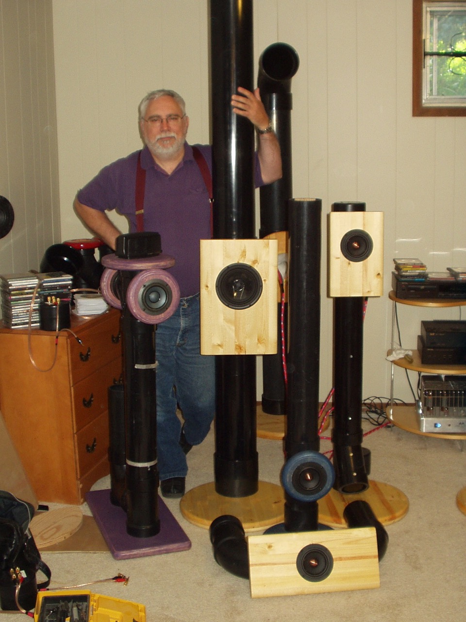

I've made all sorts of things out of ABS pipe. Most success came with quarter-wave resonators.
Just as you have wondered about a back horn from pipe, I did as well. I had some parts for 1/4 wave speakers and combined them with a bunch of 45 degree tees to make the horn flare.
The recipe was:
A 90 degree tee with a baffle for a Fostex FE 108ez at one opening, speaker terminals on a plug at the opposing opening and the start of the horn on the 90 deg opening.
A one meter piece of 4in ABS pipe which had an internal expansion plug that tapered from 25% opening to 100% opening.
A half meter U shaped section of straight pipe.
Then the horn flare, 7 45 degree tees coupled 1 to 2 to 4 to 8 openings.
It was totally goofy looking, you had to twist the tees in all directions to make them not interfere with each other. Sorry no pics.
It sounded lousy, really bad. There was little horn augmentation. I tried a number of fiddles to make it do something. The only fiddle that worked, kind of, was to place a can of soup behind the driver in the "compression chamber" to reduce it's volume. I got a moose like bellow at 65hz and that was all it did.
It was, as they say, a teachable moment. I learned that I needed to know more than nothing about horn theory to get to even a ballpark solution.
All in all the 45 degree tees made a much better planter for wave petunias than a horn. A very expensive planter.

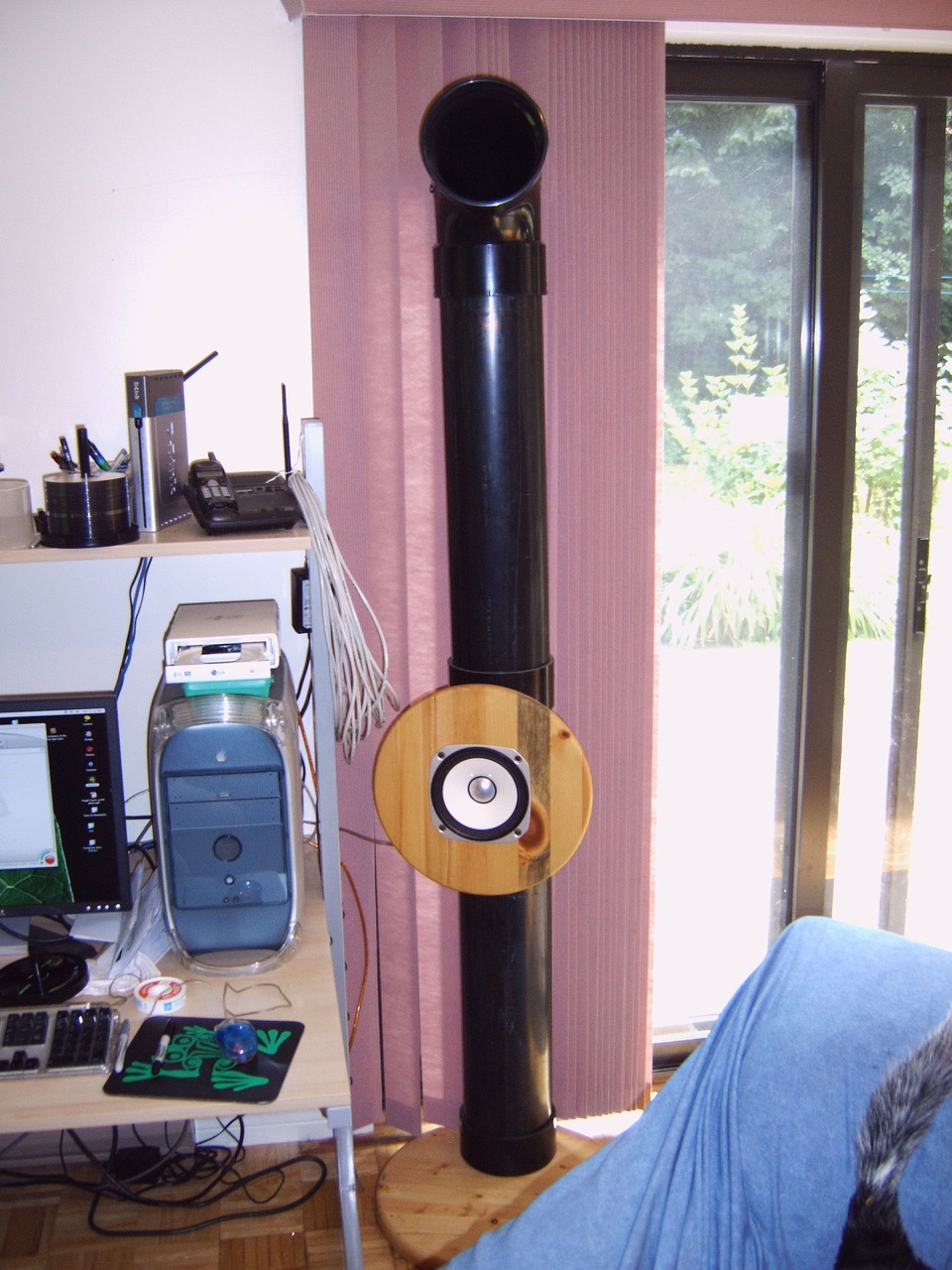

I did an expanding taper pipe for the Fostex FF165. The problem with this was that the open terminus was limited in cross section area so acoustic gain was minimal. It only sounded "meh".

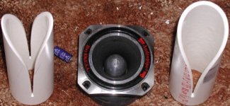

jjasniew: Karlsonating is not necessary in my opinion - and maybe even contraproductive. The 34c9 works as it is with square aluminium tubes (I built these: My 34c9 (omnidirectional full range with 3FE22) build) I also experimented a bit with 3D printed k-tube (3D printed K-Tube for 1" compression drivers) The slot there is ca 15 cm long. There is also a mini-klam in that thread with a short slot, but that seems not to load the driver I have properly. They sound quite well, but the initial measurements (may be flawed, of course) show no real benefit on such a small slot.

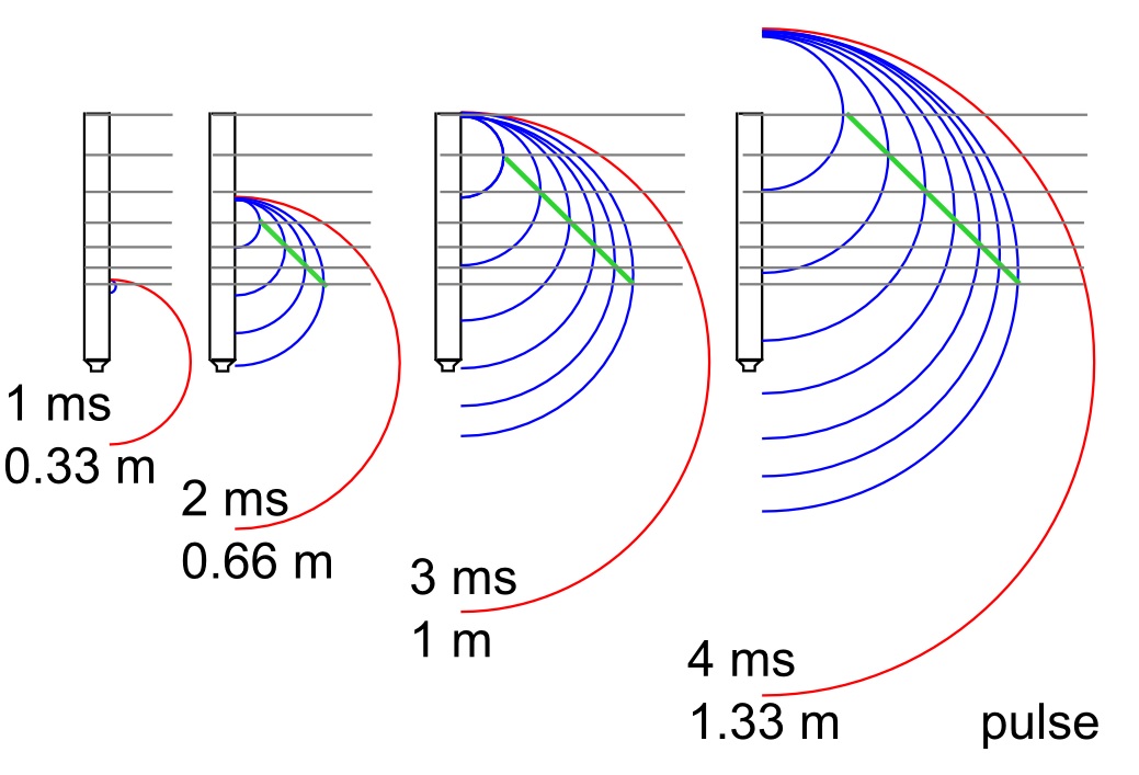

The k-tube mounted vertically I think has an omnidirectional emission due to the acoustic diffraction generated by the exponential profile. The emission is generated in a space of a few centimeters. In project 22C7, diffraction emission is generated over a length of one meter. On the acoustic page I drew the spatial distribution of the generated wave fronts. The effect is not measurable in standard mode and detectable only with direct listening. MDD technology is not commercially available so for now it is only available for DIY.
