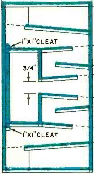

More or less. Technically it would be 'better' if the terminus was closer to the listener than the direct-radiating drive unit, as that will to an extent correct for some of the GD (providing you're on the right axis), but given the physical dimensions & other issues involved it's unlikely to be feasible for most home users.
One is a proper expanding horn with a flare factor, frequency, the other a stepped expanding horn, so not as smooth, efficient in theory, but have never done a comparison, so Scott would need to do sims for comparison.
That said, they're both parabolic flares since they each have a set of parallel sides, so not sure there would be much difference for a given acoustic pathlength except in the HF where it blends into the driver's output (baffle step) due to the slower expanding Olson flare.
Anyway, curious what Scott comes up with.
I'll try to post some comparative sims in a day or two, but I can't summarise any better than that. 😉
With my generalising hat on though, it's usually difficult to do exact comparisons because of the way the configurations tend to play out. Manifold (as I term it) construction is if nothing else very good at making efficient use of space in a given set of OA dimensions -with conventional angled baffles making up a more constant expansion you can sometimes find you end up needing slightly more.

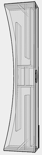

In general, I've found if you set the manifold proportions right for approximating a given [nominal] expansion profile (notwithstanding they're all strictly parabolic, as GM points out due to the parallel sides) then there's little in it in terms of efficiency, again assuming the same OA available cabinet dimensions. Since most are operating as resonant TLs for at least a portion of their BW, it's also usually six of one, half-a-dozen of the other as far as linearity goes, and as far as the LF is concerned, within reason it's dominated by how compromised the overall expansion is rather than the exact method of creating / approximating the expansion. Silbury is optimised as a corner design (also accounting for the rear integrating curve) and it's not too bad; I don't normally talk about them on the forum since they're a pay-for planset, but for what it's worth, a couple of sims attached -the measurements I've taken of test lines for this range are in good agreement assuming solid room construction. Top left is system response assuming corner loading, bottom the horn output. Right hand system graph shows results moved a reasonable distance away from the corner, but still with a reasonable front-wall boundary support (pulled out another few inches, 'just because') The null is the expected cancellation mode for the positioning used for these.
