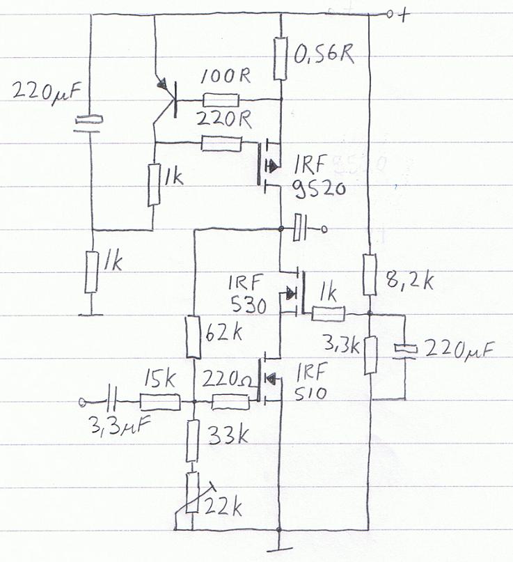

If everything goes as planned I´ll post some better schematics a couple of hours from now.
Handdrawn, since I haven´t had time to check that software out (I´m at work).
Although the circuit works if built as shown above, I have some suggestions for modifications that probably would improve the performance:
Higher rail voltage. I lost a few volts more than I had expected so I´m running mine on 21,6V, it works but a few more volts would probably be great. 28V would probably be ideal, 3V across the gain transistor and 25V to be shared between the cascode and the CCS.
Higher current. Of course!! I´m limited to 25-30W dissipation per channel by my quite small heatsink, if I could I´d definitely change the 0.56R resistor to 0.47 or even 0.33R
In that case I´d also change the CCS mosfet to something that can take a little more power, like IRF9530 (or -9540 or 9640 or whatever, you get my point).
A trimpot in the voltage divider for the cascode would be nice, I ended up with about 2,8V across the gain Mosfet but perhaps it would be interesting to play around with that voltage a bit?
As far as I can understand the internal capacitances in the Mosfet changes with the voltage, so one or two extra volts to play with could be fun.
I needed quite high input impedance to match the output of my active crossovers, people with good preamps could lower the values of the feedback resistors and probably get improvements here.
Putting the feedback loop outside the coupling caps might also be a good idea, but now we´re getting of the track.
While we´re of the track, why not add an input buffer and an active CCS? 😉
The possibilites are endless, but the amp sounds really good as drawn in the schematic and would probably sound even better with just a little more voltage and current.
As promised, I´ll build a bigger version someday with IRF540/9540 for the cascode/CCS and IRF530 as gain transistor, 28V rails and plenty of current. I got a pair of really huge heatsinks earlier this week and I already have a nice 2x24V 750VA toroid...
Not that I need more amps, but after my first listening I got the impression that the cascoding is a winning concept that deserves proper implementation.

Fuling said:If you guys can´t read this, get thicker glasses!
No problem, dear Fuling.
You make nice schematics with your method.
Your digital camera is not bad.

- Baby Zen for biamping
