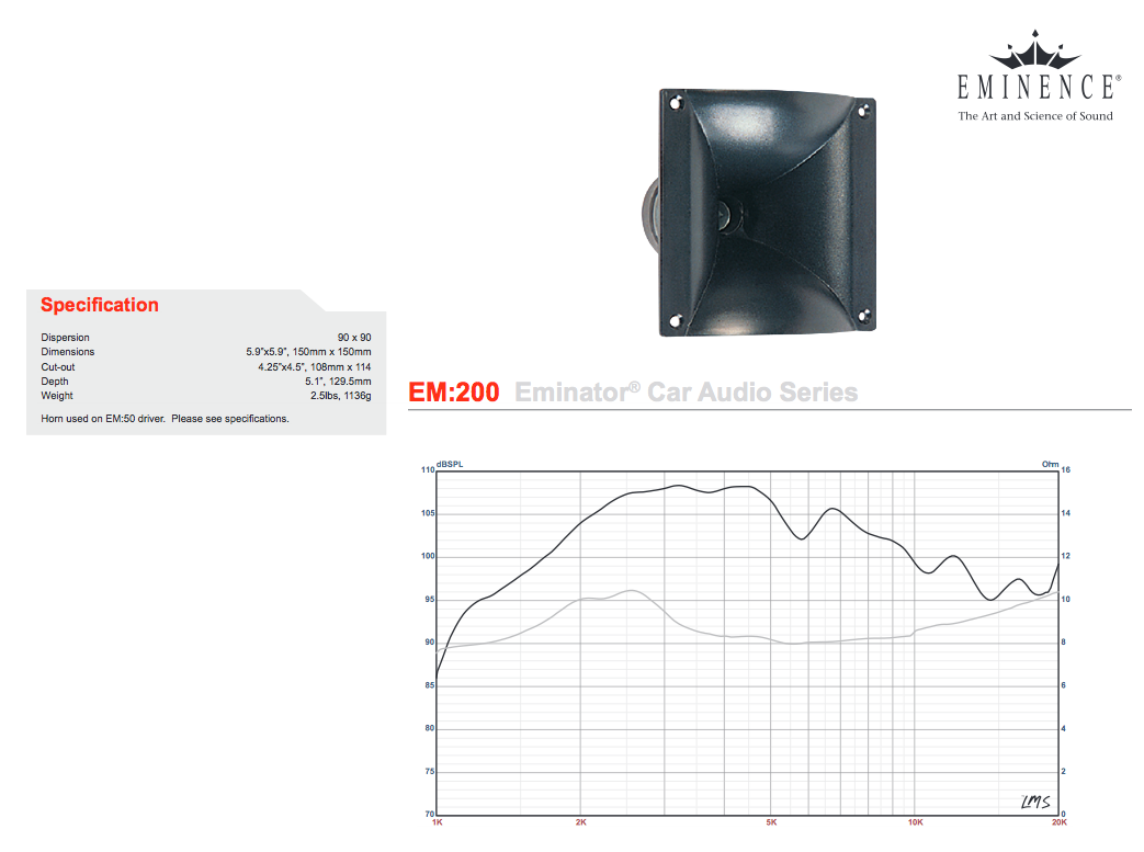

Just came upon a measurement of the EM:200, response is about what my guess in post #4 was.

It's strange nobody is familiar with this hornflare -sans- APT 80 tweeter. Maybe i should have posted this in Pro Audio. Does anybody know another Buttcheek 90 degrees wide dispersion TPI flare for 2 kHz and up? Available in Europe.
try google Iwata horns
