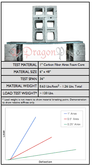

Check this out:
Carbon Fiber Applications - Robotics, UAV, Sports Equipment, Musical Instruments
and
Solid Carbon Fiber Sheet Bend Tests
and this
Carbon Fiber Foam Core > Airex 1" Foam Core - 3 Layer
So PanAm 😛 go for it, make that CF case! There will be some followers I am sure.

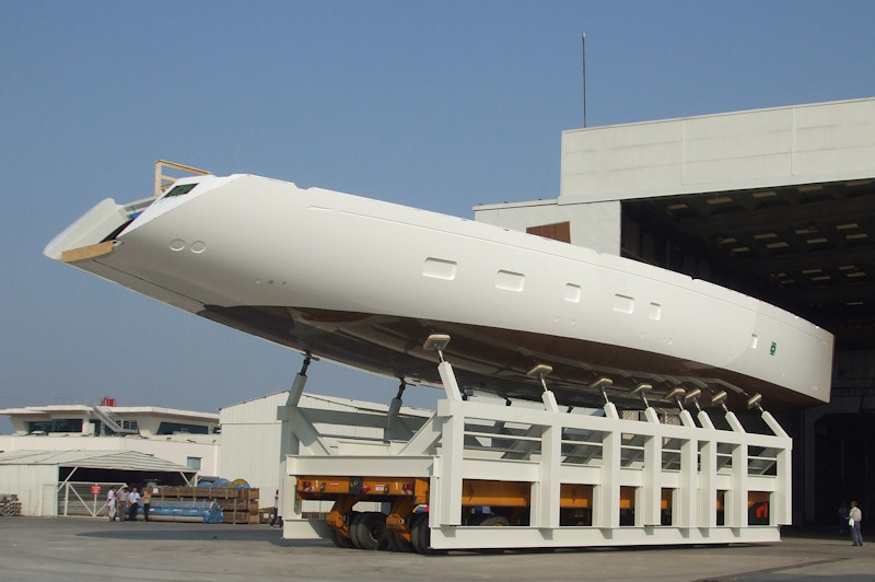

Close to 25 years ago, the Vise Guy spent some time in an airplane factory, making Kevlar sheeted panels with a honeycomb body.
Around the same time, he made a visit to a ship yard, where they made sonar domes* of...Kevlar.
Nowadays, carbon fiber is the No1 material for building or reinforcing lightweight hulls, tone arm board of me TT is carbon fiber cloth and resin.
But, if you're going for the best result, you'd need (access to) an autoclave oven and go for vacuum.
(*you know, mounted under the butt of a warship)
Currently the largest single vacuum infusion, close to 6-1/2 ton resin injected in 2 hours, carbon&aramid, hull of a 125ft sail yacht =>
