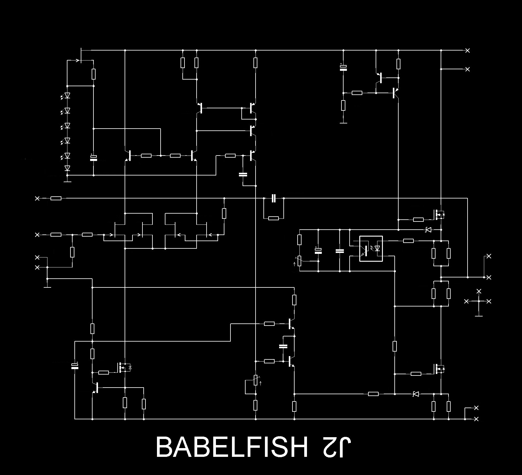

Seeing some stones turned lately , I simply couldn't resist Babelfishing urge......
Though , as I already did some mild Babelfishing of our dear and beloved J2 , logically that this time I needed to do something ...... completely different
due to constant demand and popularity mainly on Far and less Far East , schematic of original FW J2 is still generally unknown or - better said - none of circulating DIY schematics weren't blessed by Mighty Pa (pleonasm here , Pa is Mighty by 42)
few things we all know , and these few things are good and plenty enough for basic postulates of variation of Jazz Standard 🙂
Basic premises :
1. possibility of incorporating less critical ( for acquire) JFets for input LTP, by choice and must possible use of 1+1 , or 2+2 in same ;
2. possibility of incorporating various output devices , of lesser and bigger rarity and/or price
2a. possibility to avoid tearfully matched parts (outputs and other ) , while still easy settable both output offset and OS Iq in broad range of values

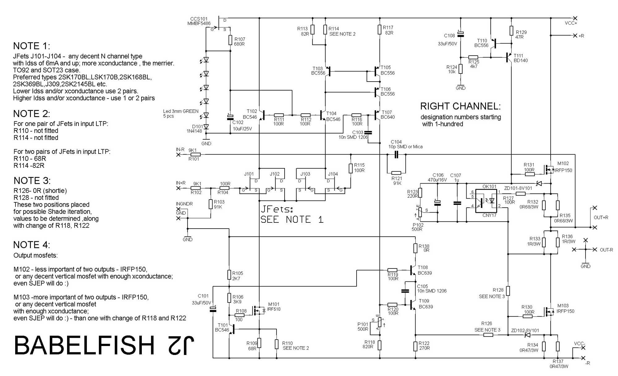

I got it all ........ how:
1.easy peasy - use N channel JFets (choice is waste!) , lead them (currents) back to lower output gate via simple and effective current mirror ..... put few cascodes here and there to pet both JFets and fine CM parts (tiny JFets are always grateful for that, but high beta small BJTs like that too) ....... and while we are there - why not using fine emiter follower between CM final end and lower output's gate .......
2. OK - trimpot in front of lower output's gate is trivial ; second part is feeding Optocoupler with CCS , with some current spare , and routing the same in loop around ( in parallel practically) said optocoupler , so we can set Iq of upper mosfet with ease and in broad range
2a.partly already covered above , just to add that output devices can be plain old IRFP150 , same as any boutique part you already have , value of Ugs is irrelevant - easily covered with change of ,say, two resistors

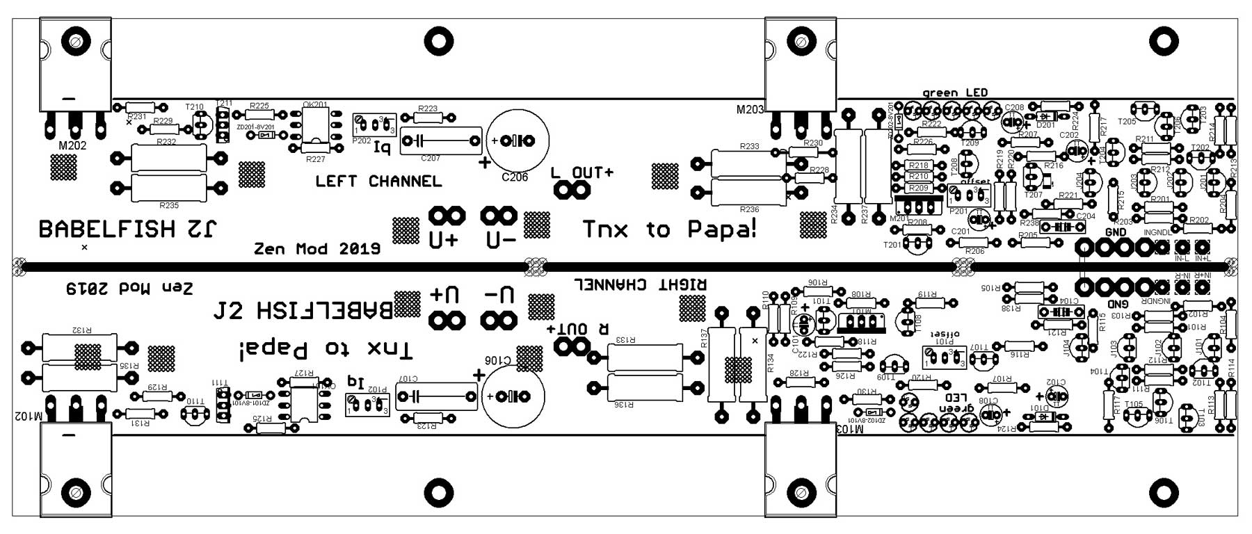

'nuff talking , time for schm (read notes on left side):

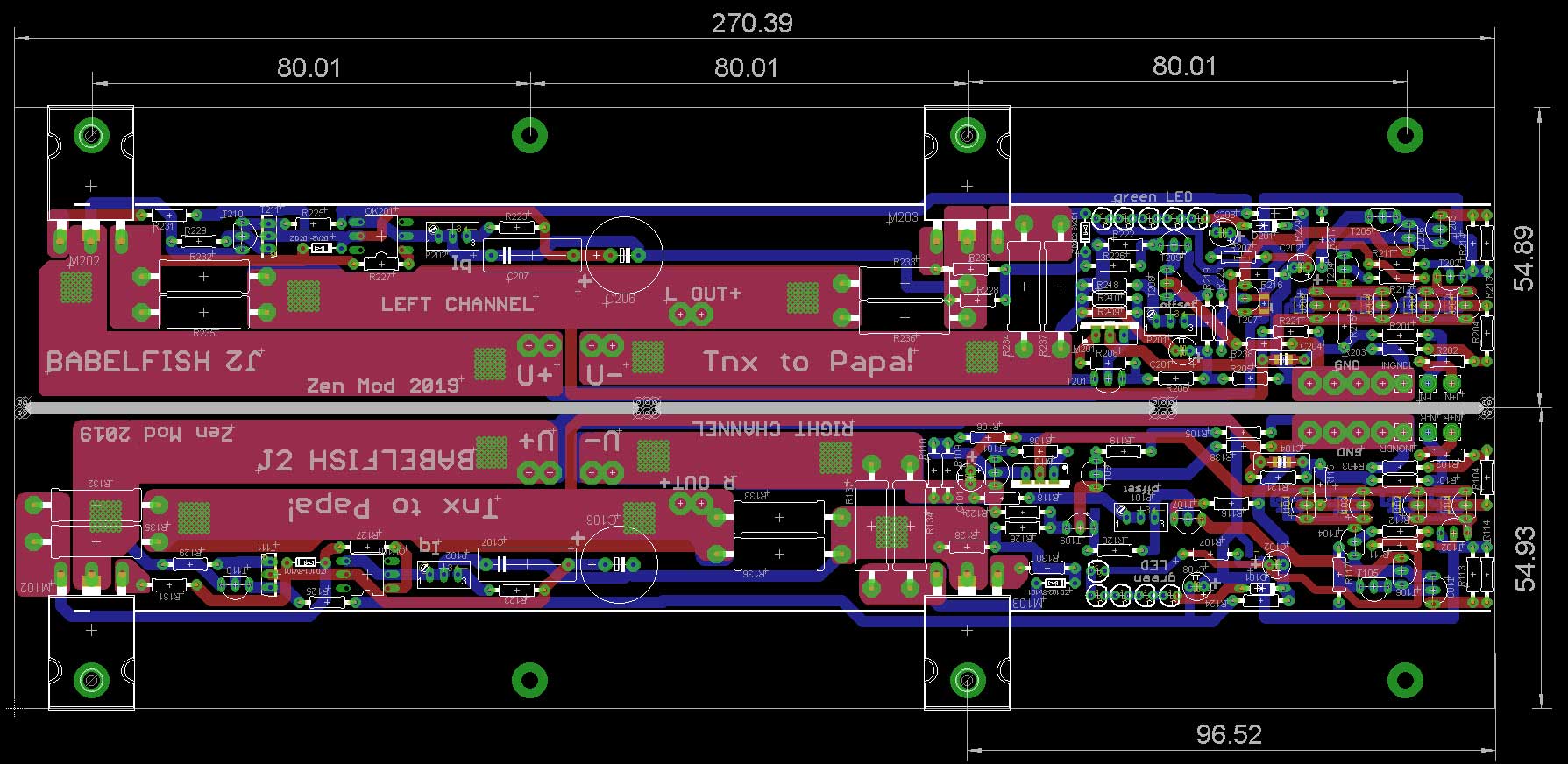

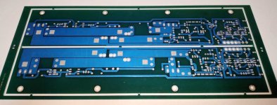

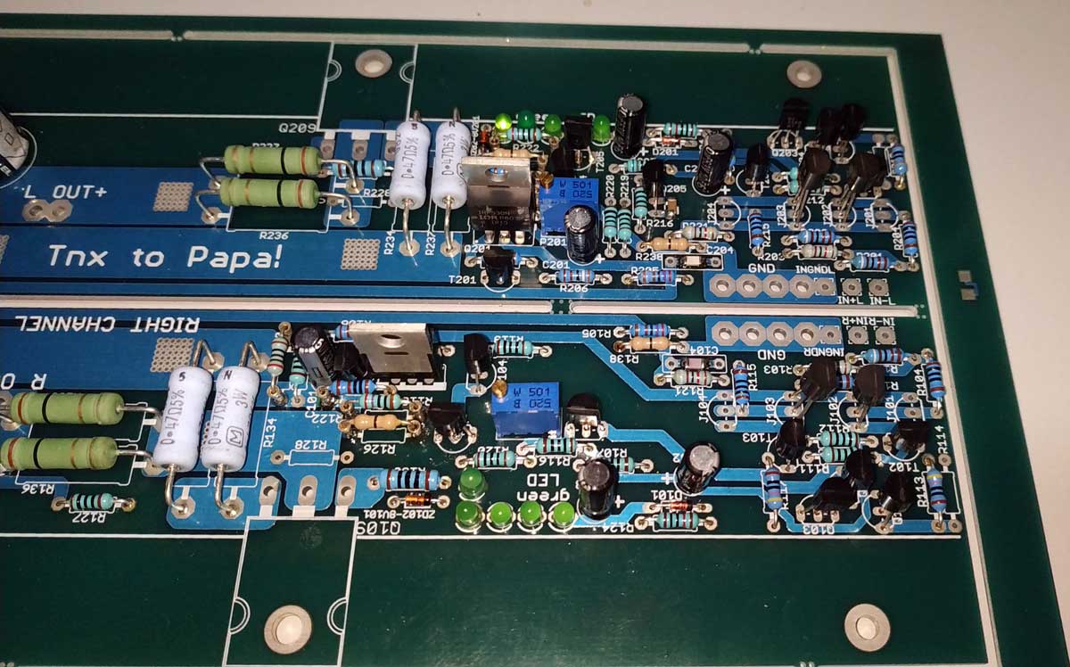

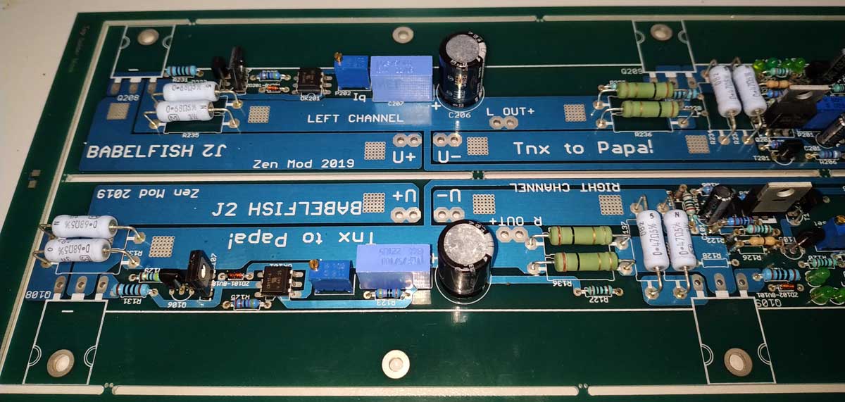

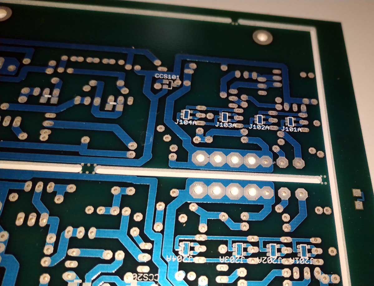

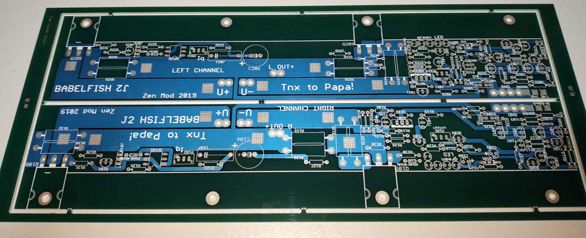

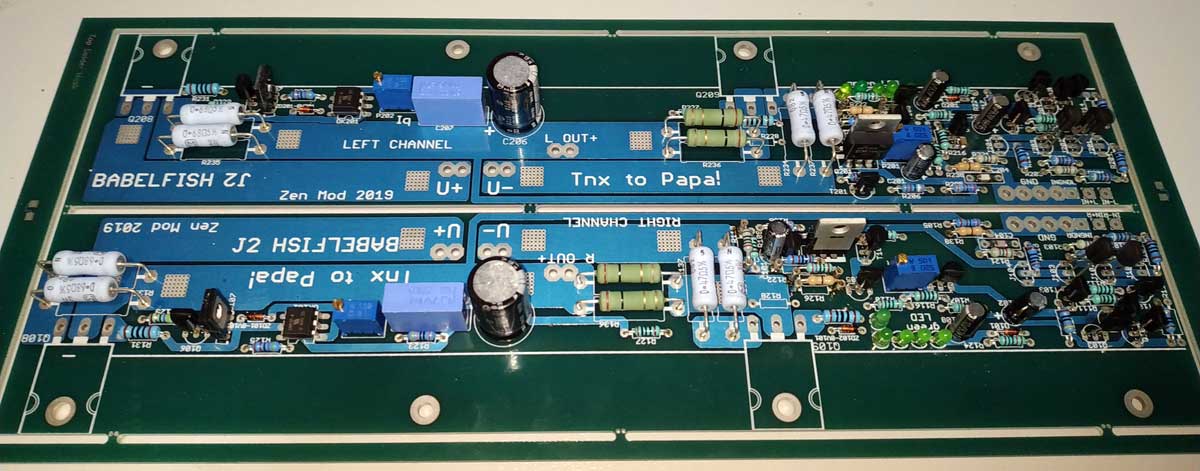

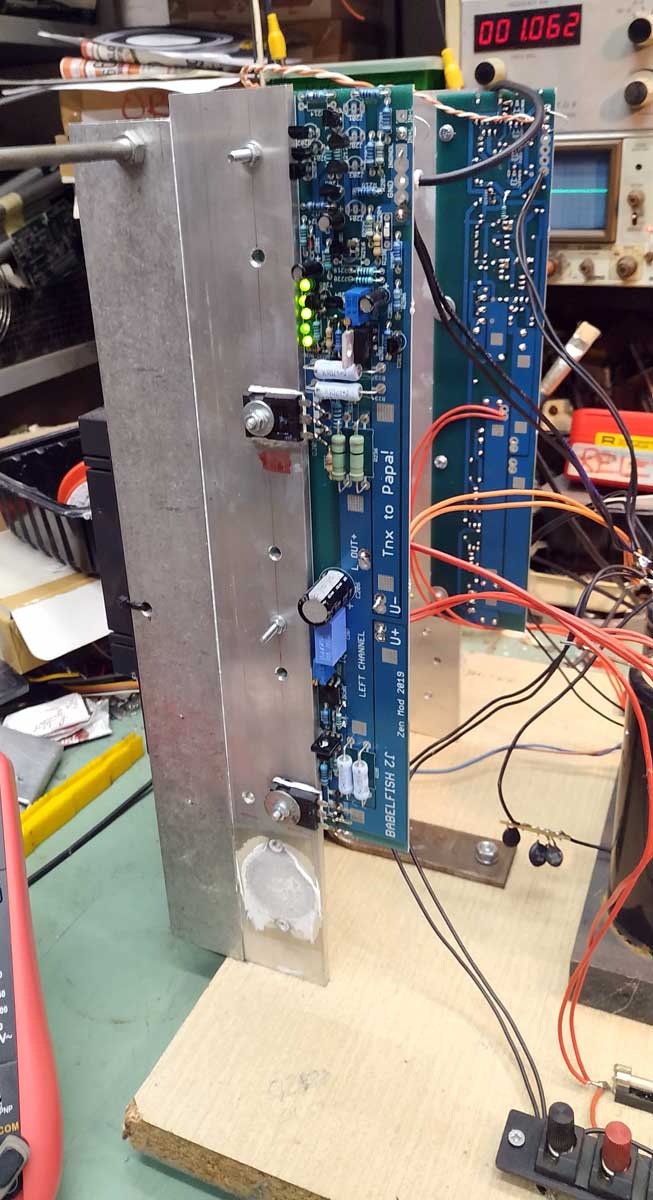

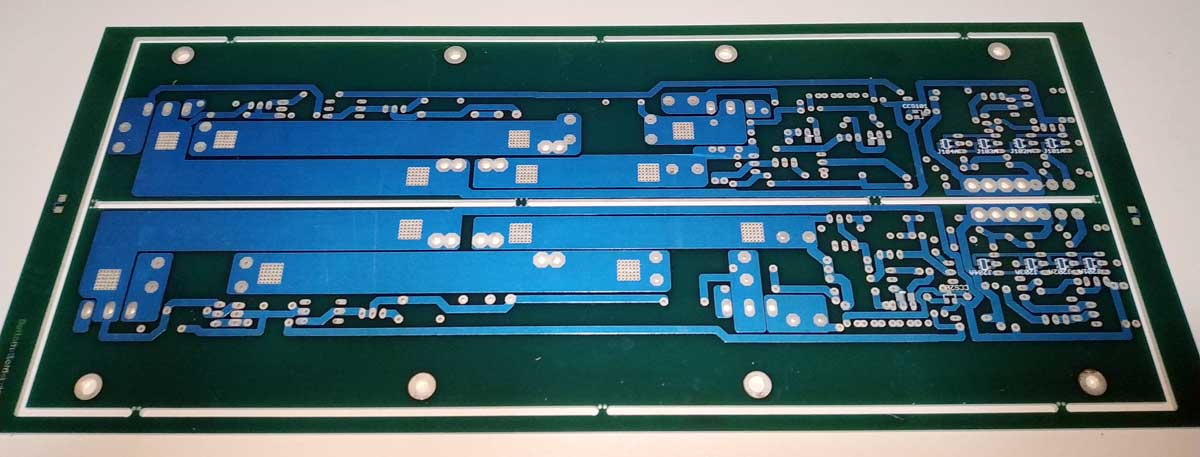

few days ago , I received 0 series pcbs , and did some stuffing

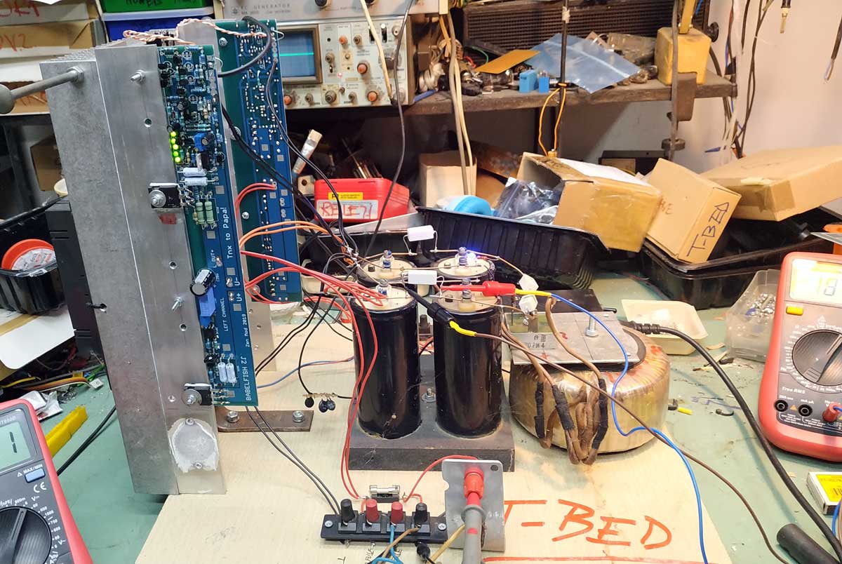

then yesterday and today I put it in T-Bed , and did some final tweaking of some values
for start , they're equipped with 1+1 Toshiba 2SK170BL in FE , Iq set at 10mA (5mA per tiny) and pair of goodoldsturdy IRFP150 are in OS

power-on and power-off behavior is same polite and nice and gorgeous as ZM Might itself , so there is no any surprise

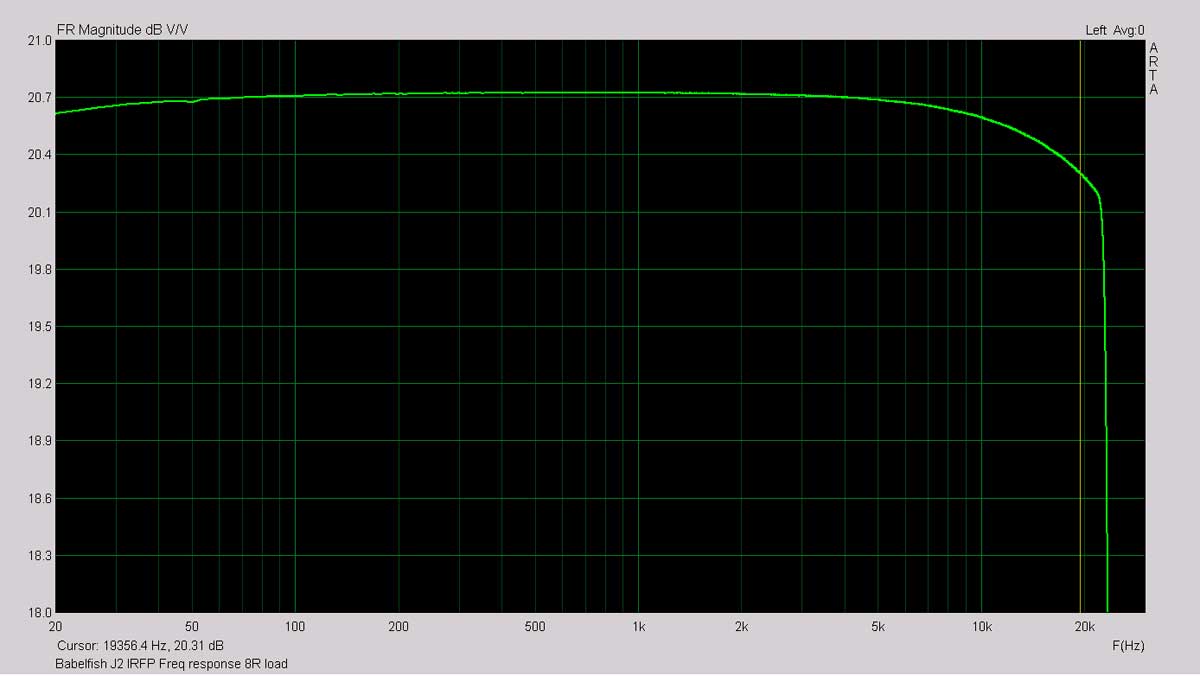

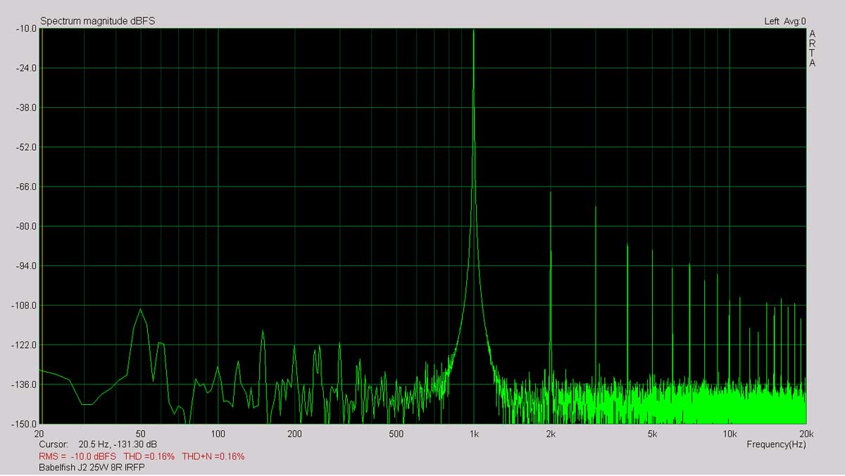

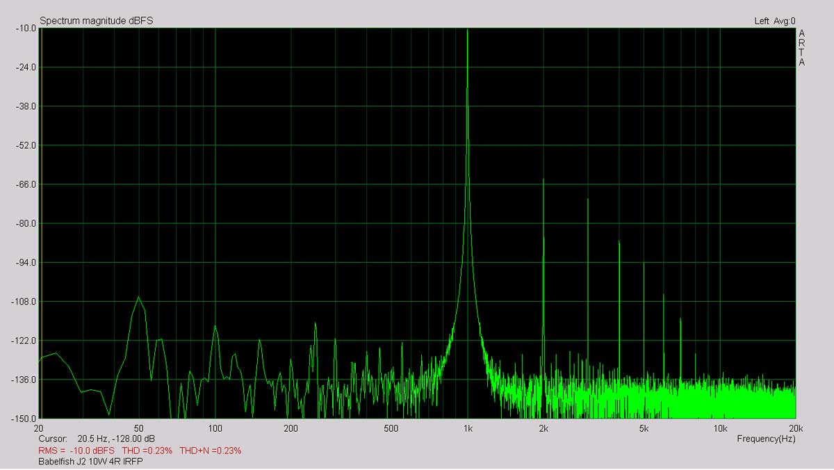

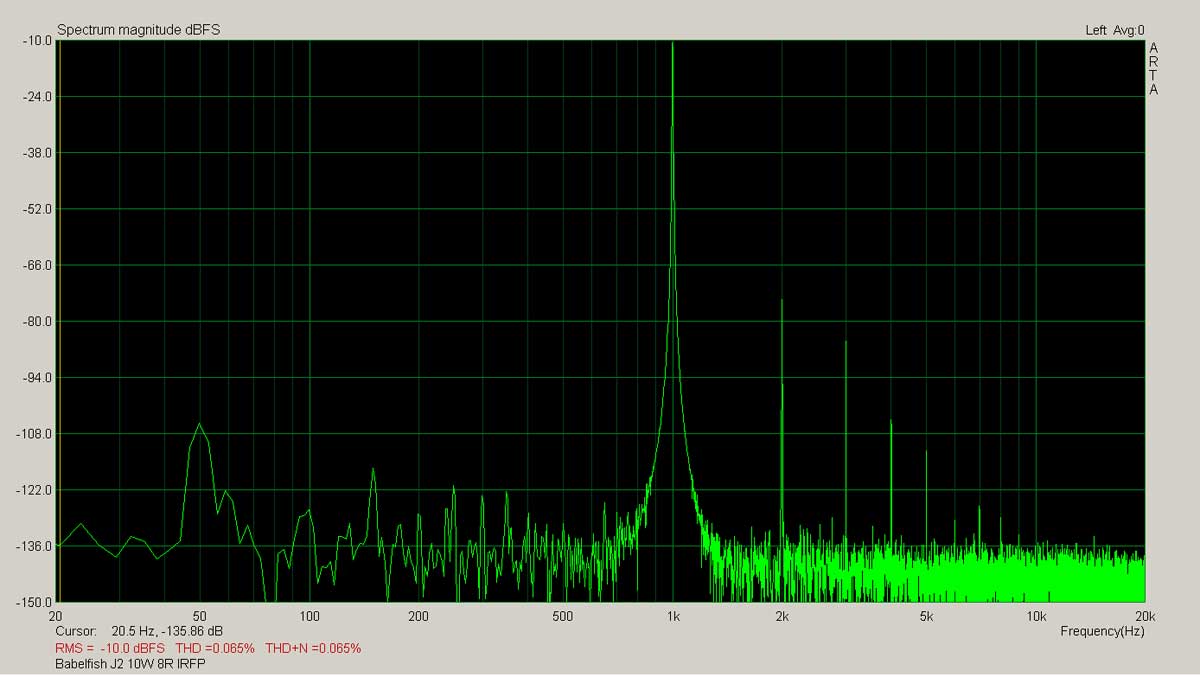

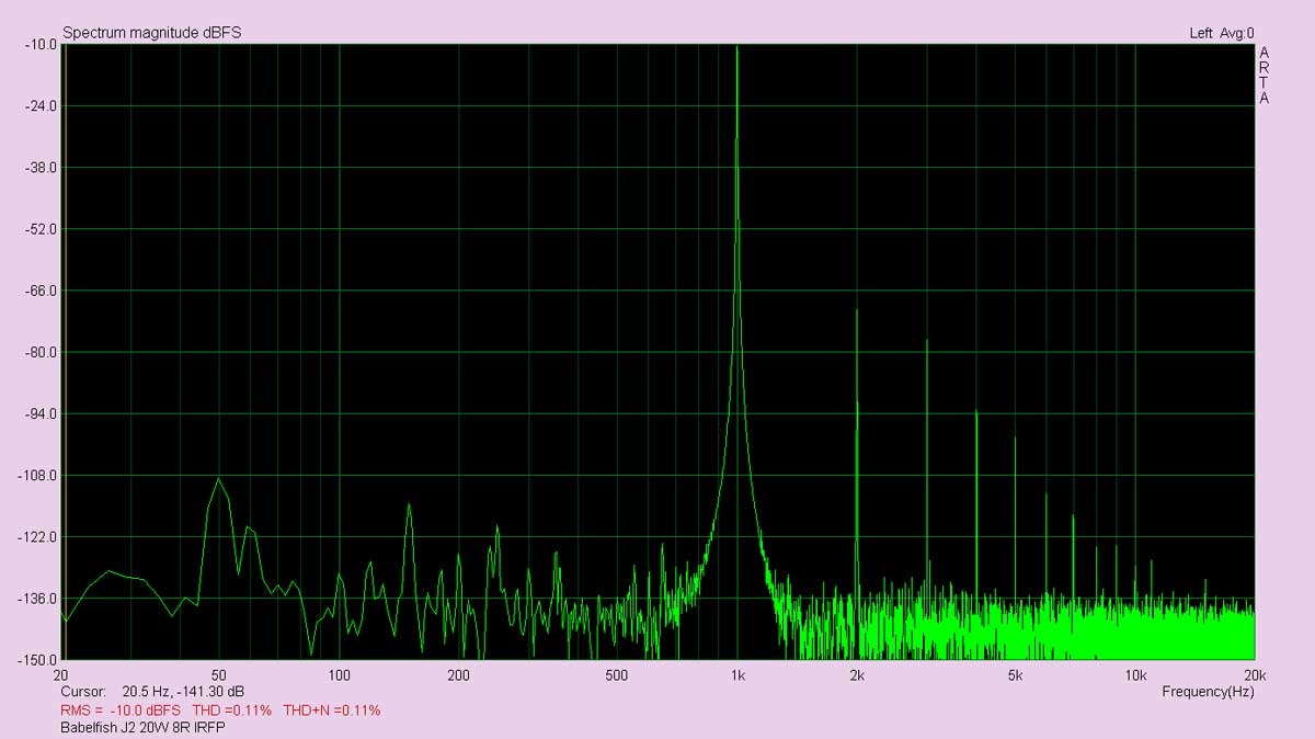

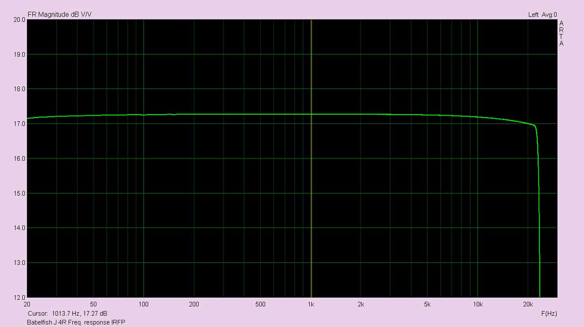

now some measurements ....... being lazy and impatient , I didn't use recently acquired Quantasylum ( older , SE one ) but my old funny interface box and EMU1212 in PC , software is ARTA

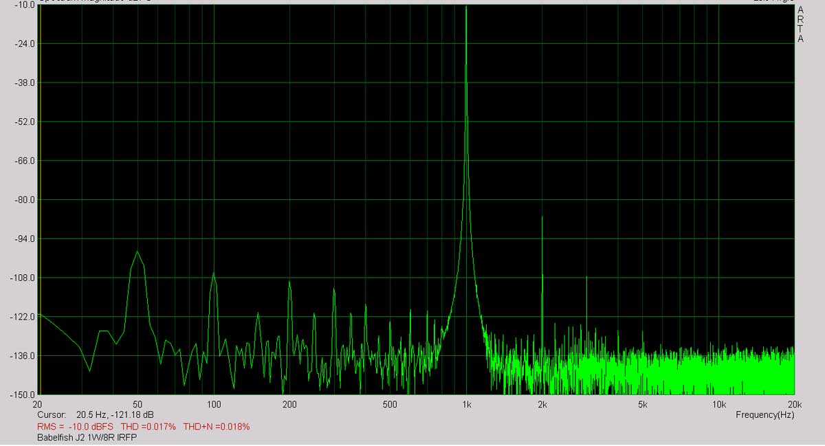

Iq set at 1A8 , rails more or less exactly 25Vdc
first set of measurements at 8R load ; each graph is titled at bottom ; as always with my T-Bed and test setup - ignore everything left of 1K ...... plastic box for interface , old and crummy PSU incorporated in T-Bed blahblah

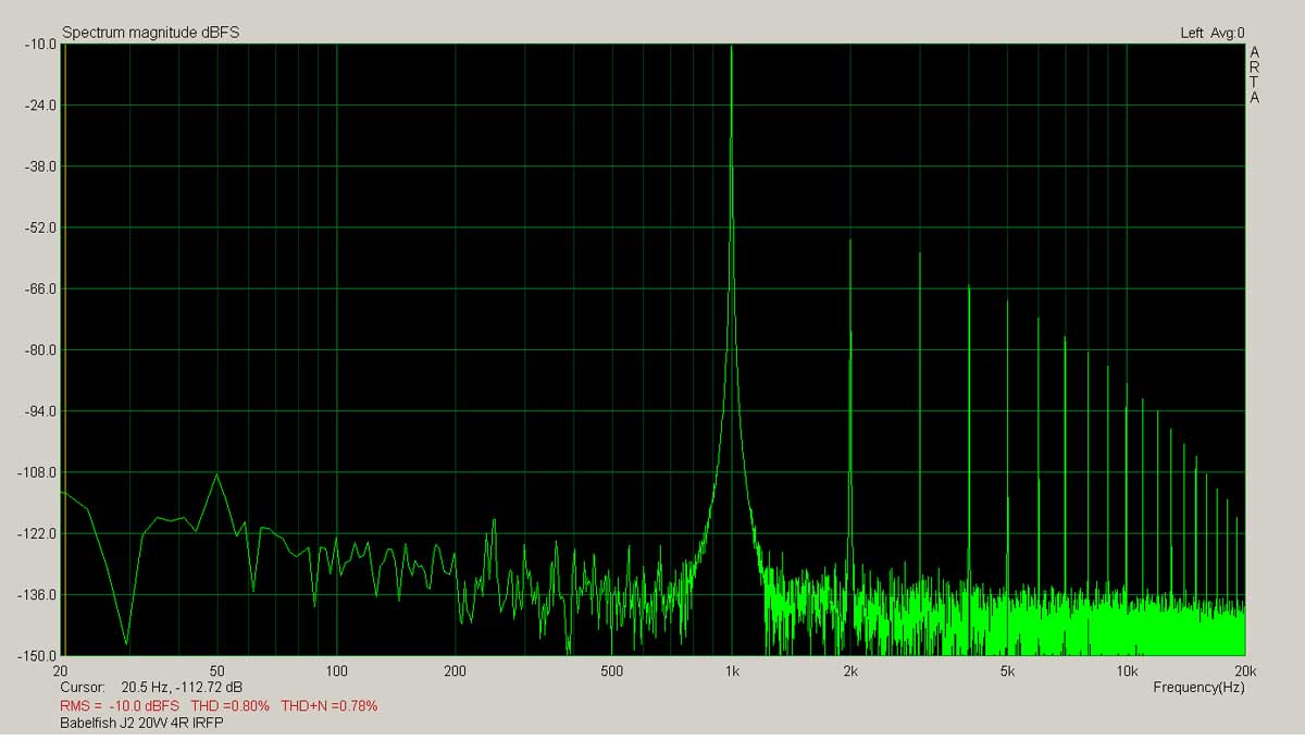

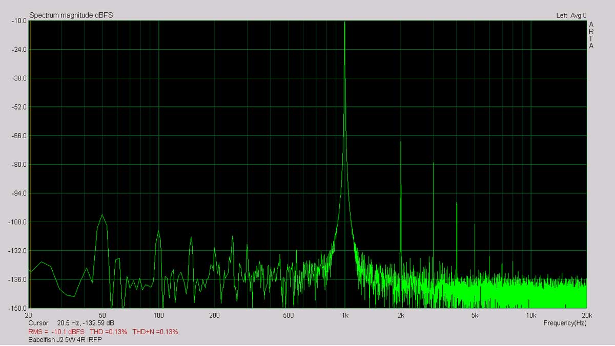

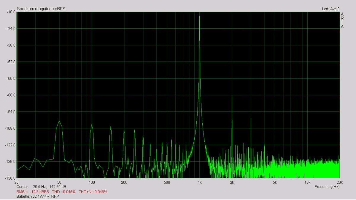

so , set of measurements at 4R load , same Iq and rails as for previous test
btw. I decided that clipping is at 1% THD , and that's exactly at 21W9 ...... though - it was tricky to set level pot to exact value (THD rising rapidly at that level!!) pretty good , if you ask Mighty Moi .......
