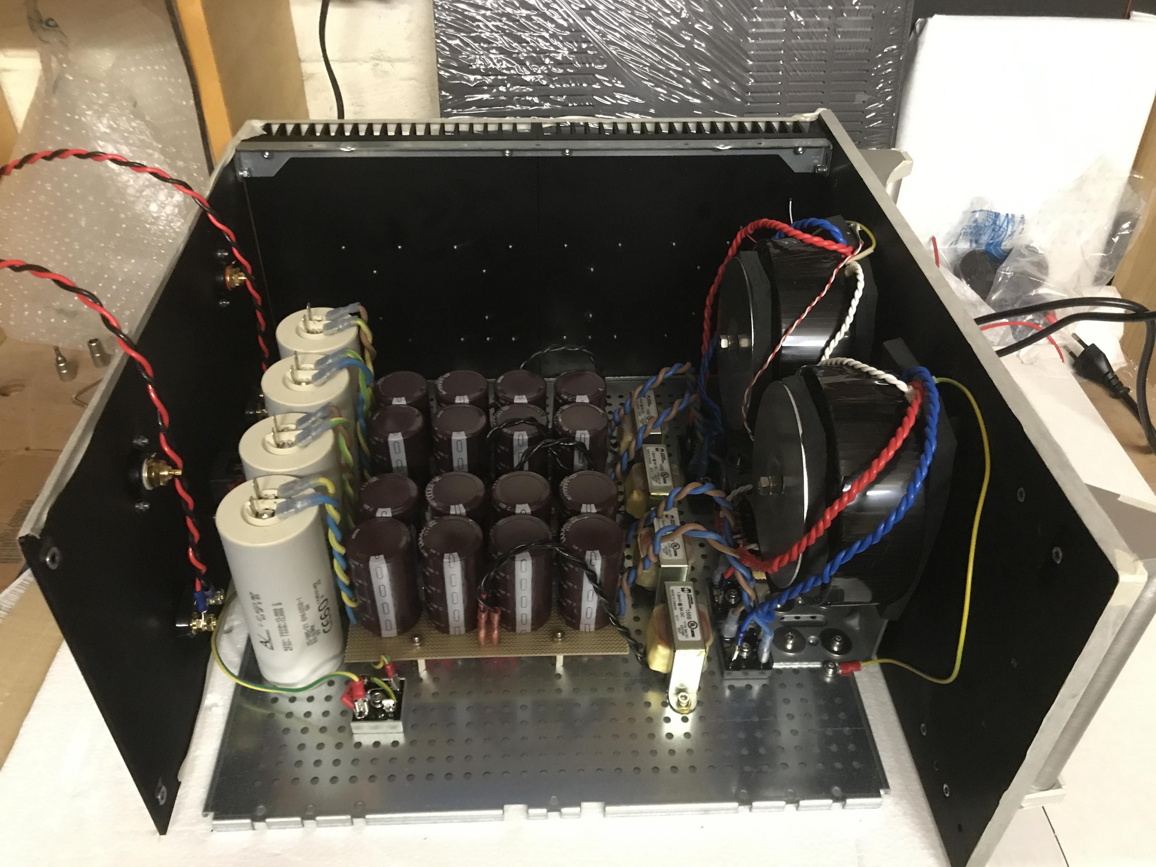

Haven't fired up my first channel yet, still PSU connections and input wiring to do, and we have friends staying with us for the weekend, so probably will happen sometime next week ... :)

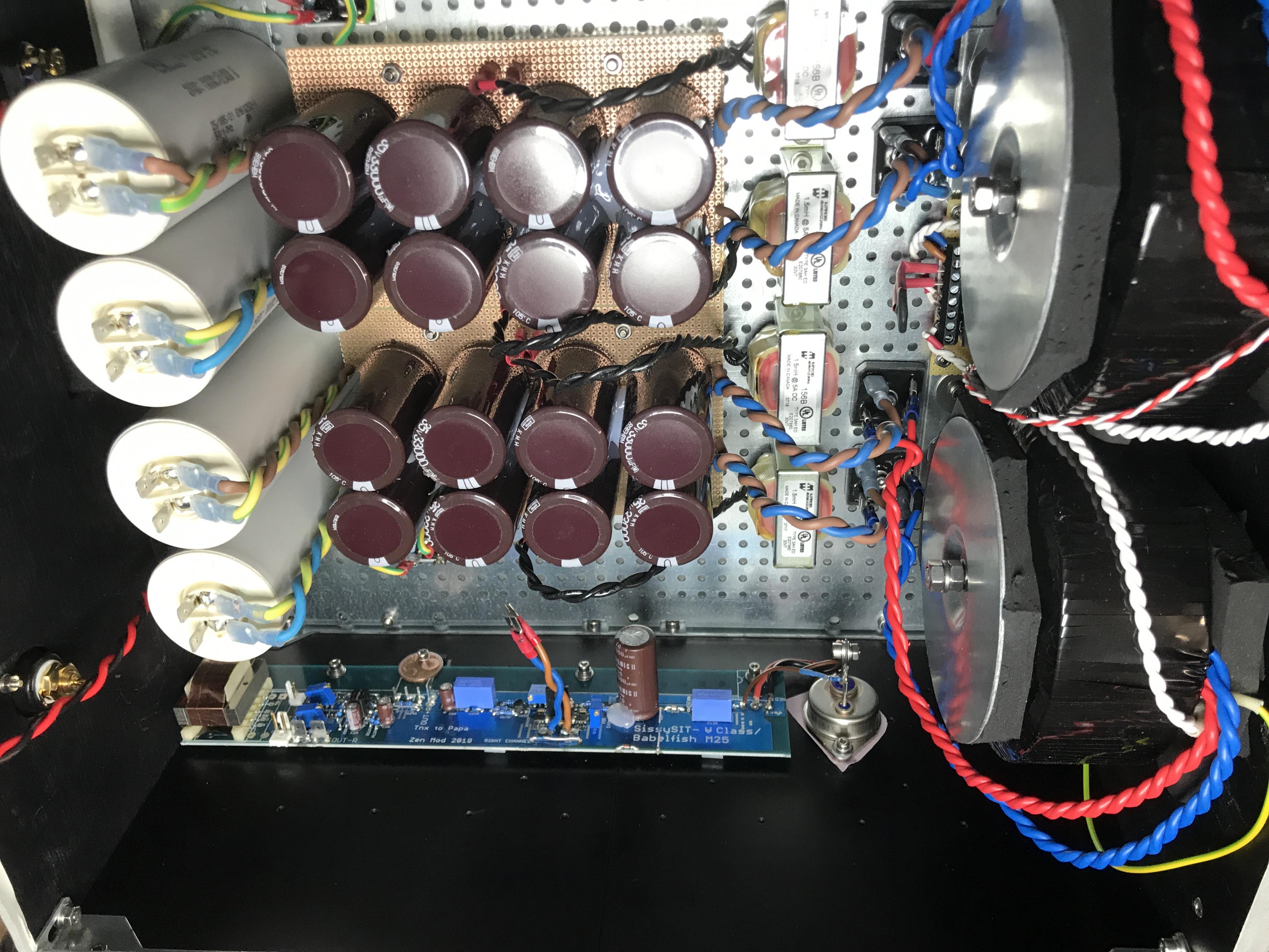

I see that some users have used polypropylene caps on the power supply, probably to improve the quality of the current. I have some doubts about positioning them because I am worried about the length of the wiring from the boards where the large electrolytics are housed. These wires, if they are long I think they introduce a non-negligible parasitic inductance and that could nullify their introduction. Do you have ideas in this regard? What do you think Zen Mod? I saw that you also adopted them. They are useful?

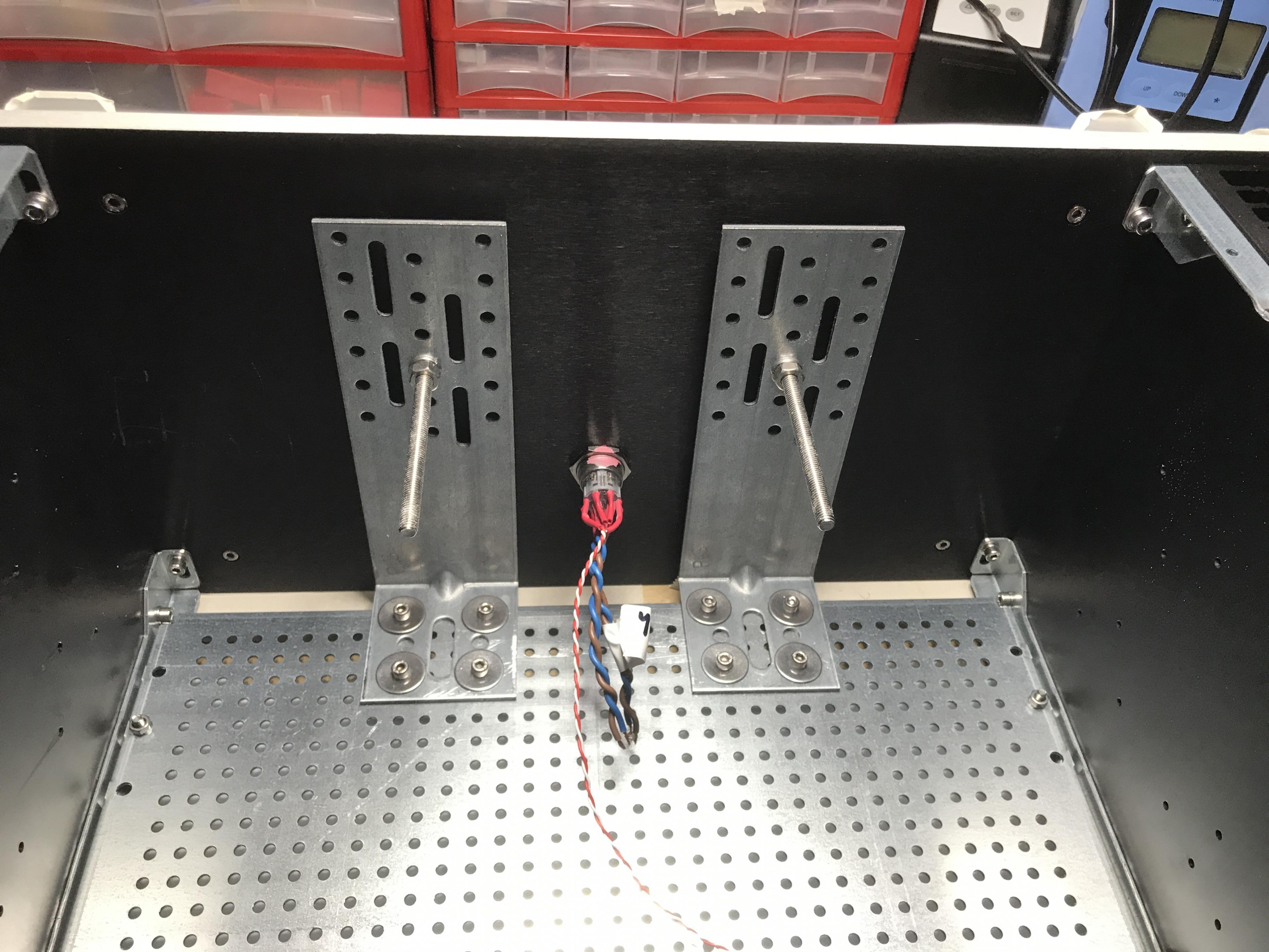

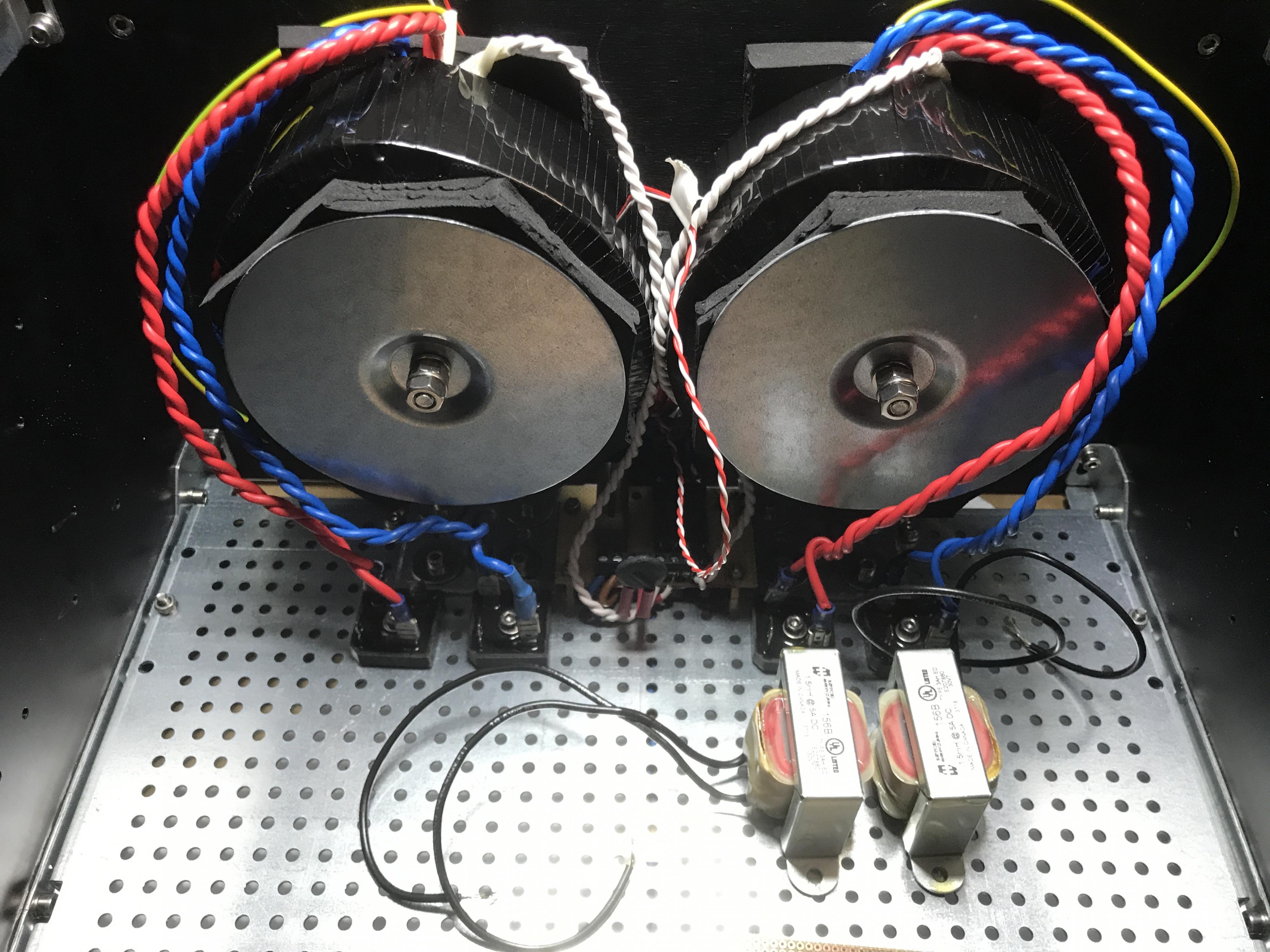

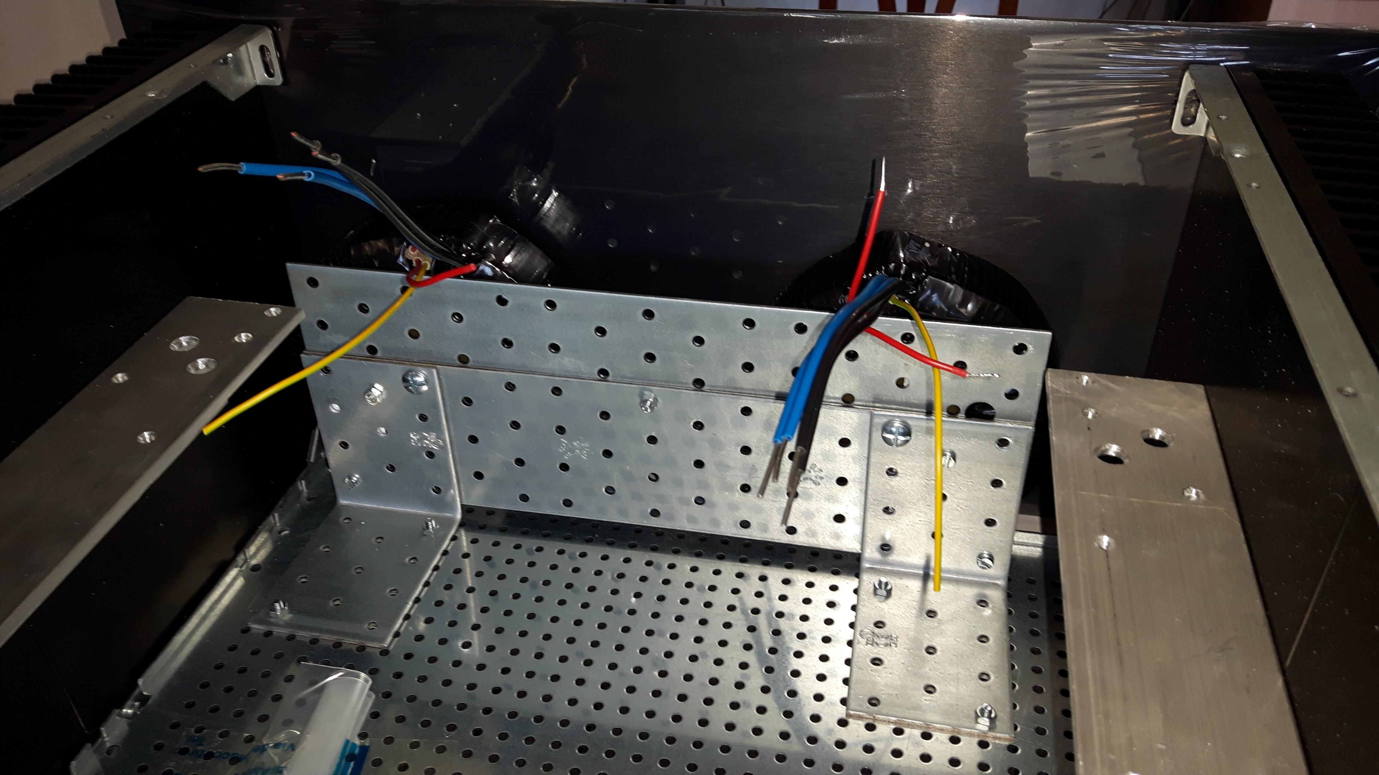

Can't tell from pic, what is holding your transforms up? I think I see base of a bracket on one pic. What did you use for bracket?
Also wondering make of caps.

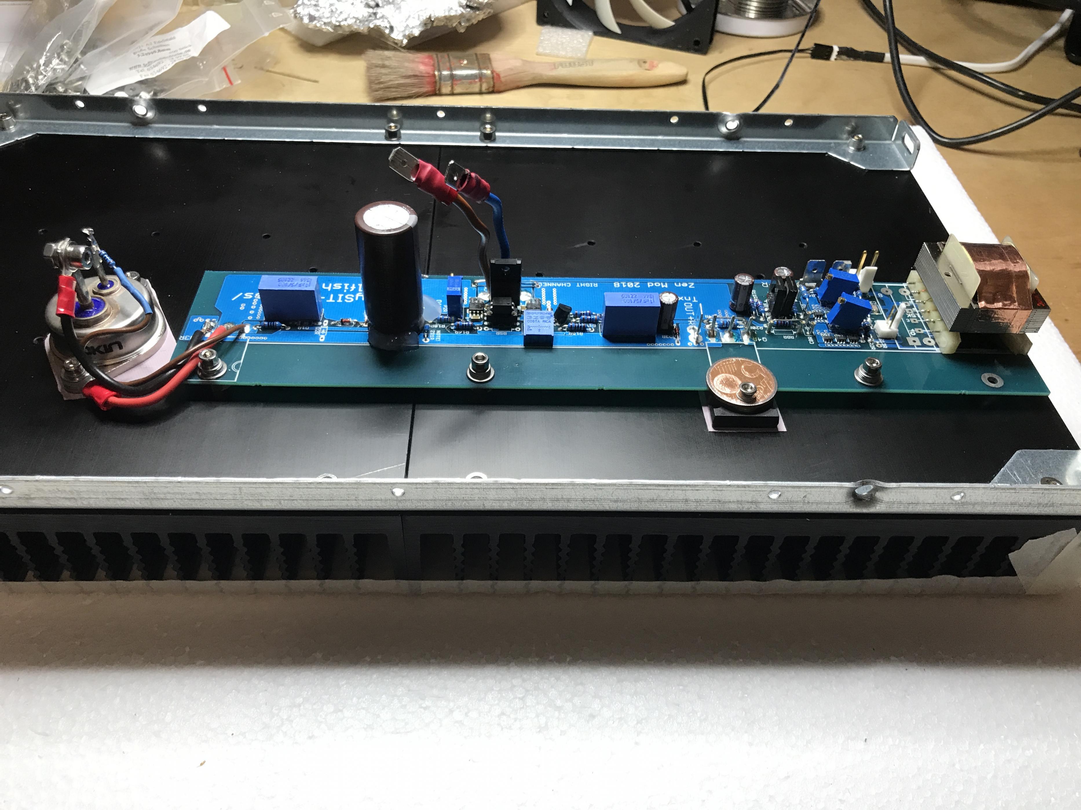

Hallo Ernst,
the inductors are Hammond 156B. 1.5 mH, 5 A, 0.073 Ohms.
Each one will have a bias curent of approx. 2 A going through it, so I think they should be sufficient. ;)
In my Aleph J and M2 (with just one PSU common to both channels) I used Hammond 159ZL, which is 2.5 mH, 10 A, 0.044 Ohms.
I would have liked the bigger choke better for the mono PSUs as well, as the low DC resistance should lead to lower impedance in the power supply.
But I couldn't have fitted four of them into the amp case ... :rolleyes:
