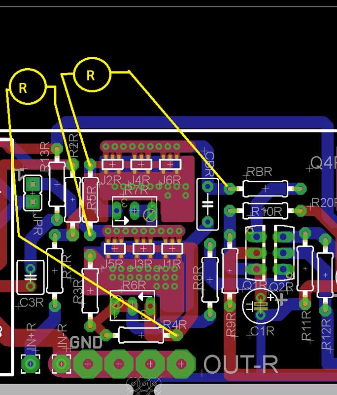

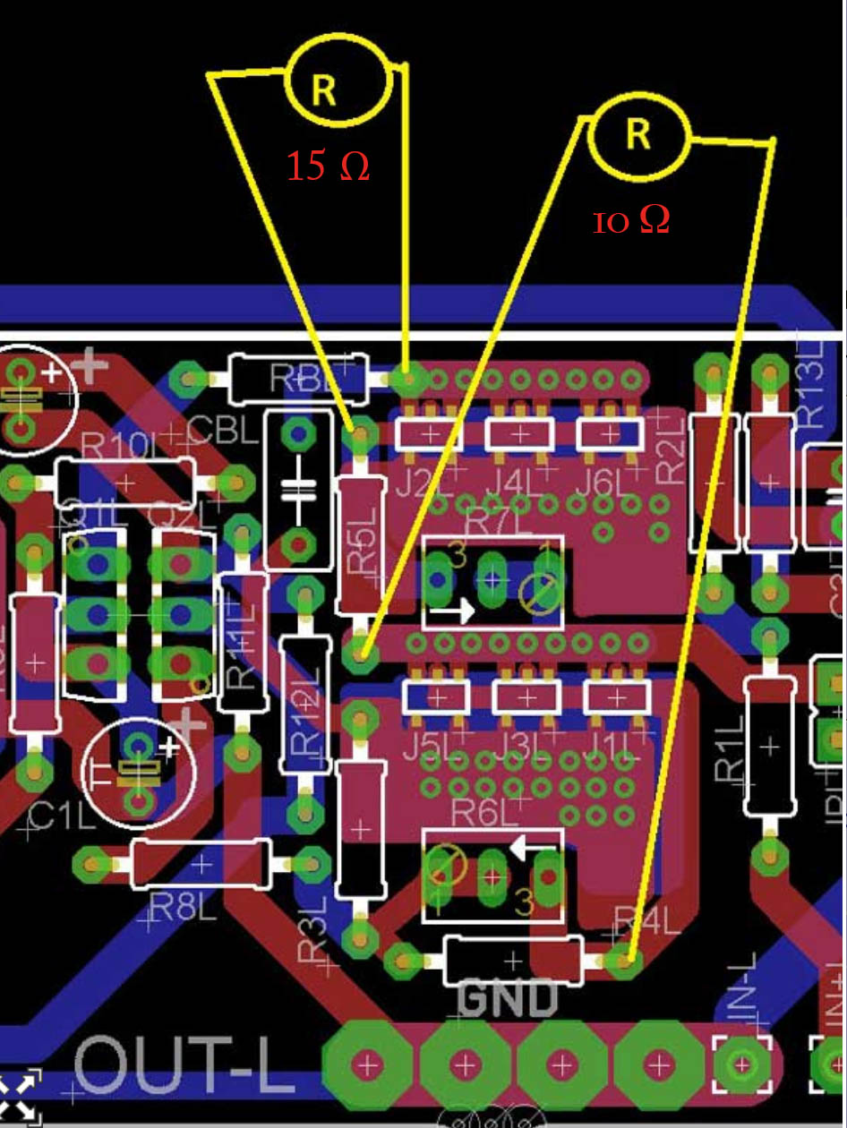

Grg, I have a problem, i set the pots as said in schematic. R6 max value , what measures about 23 Ohm across pot. R7 set at 0 Ohm.
Than i powered it up, Multimeter across R8, set for 200mV DC, and it instantly gave me the Diode-Test tone for ecceeding the measurement limit. Powered off instantly, dunno, i got to recheck everything tomorrow.
@ ZM: Potsetting schematic is right? Du you think buffer went dodo now?
srry for trouble
with everything powered off and JP not closed, measure resistances as shown
you can set ohmmeter either on 200R or higher , or on diode test position
