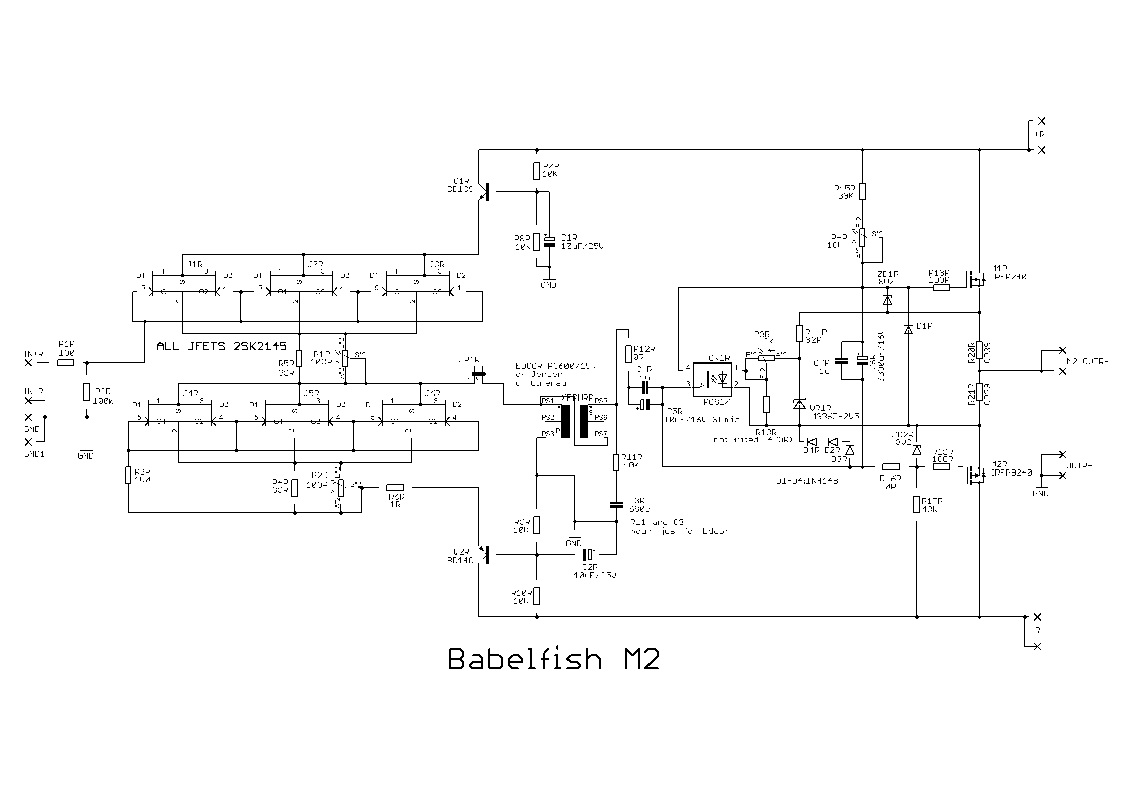

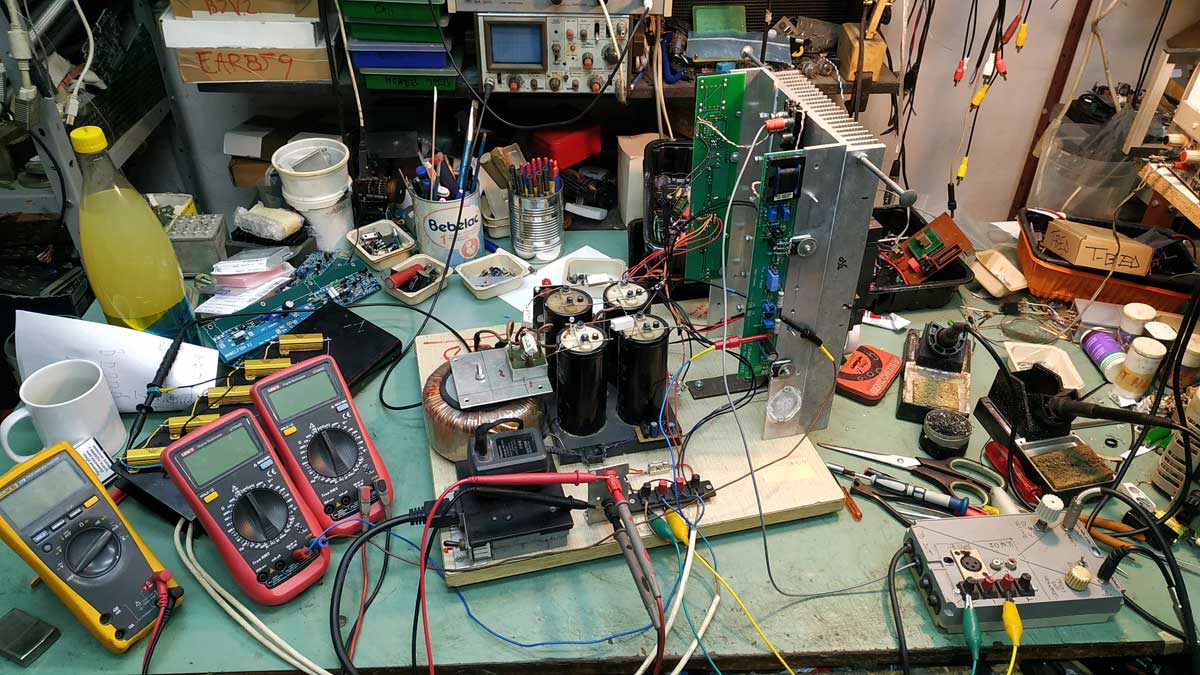

Babelfish M2/SEF amp (yup , S means Schade)
Another funny pair , for your fun , amusement and joy

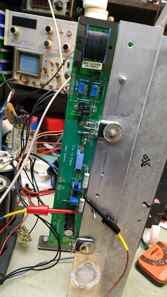

First remark - it's easy to convert your existing M2 to SEF amp ..... see yourself
Anyway , to start with Babelfish M2 - practically nothing new under the Sun , everything you're going to see it is familiar ; so , that one was trivial to make and test.
Practically - same approach as with Babelfish M25/SissySIT , sans Halls in rails ; difference vs. Papa's M2 are:
- tiny buggers (2SK2145BL) input JFet buffer , or T092 Toshibas , or any decent T092 N channel JFets ; xconductance conduct
how many are going to be used
- with this pcb , one can use Edcor or Jensen or Cinemag Iron ; all well known candidates
- for all tests Iq set at 1A8 , while Papa's original was more sissy in that department

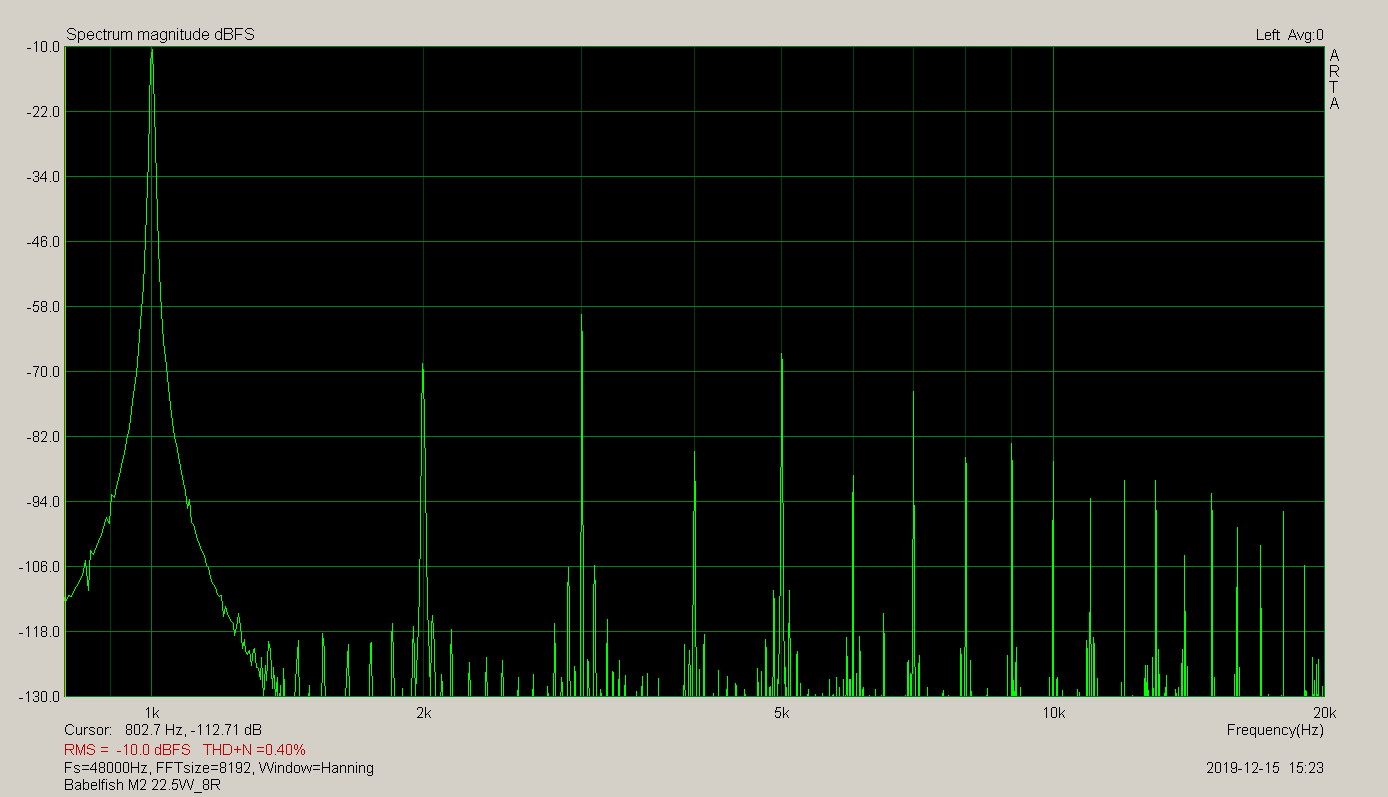

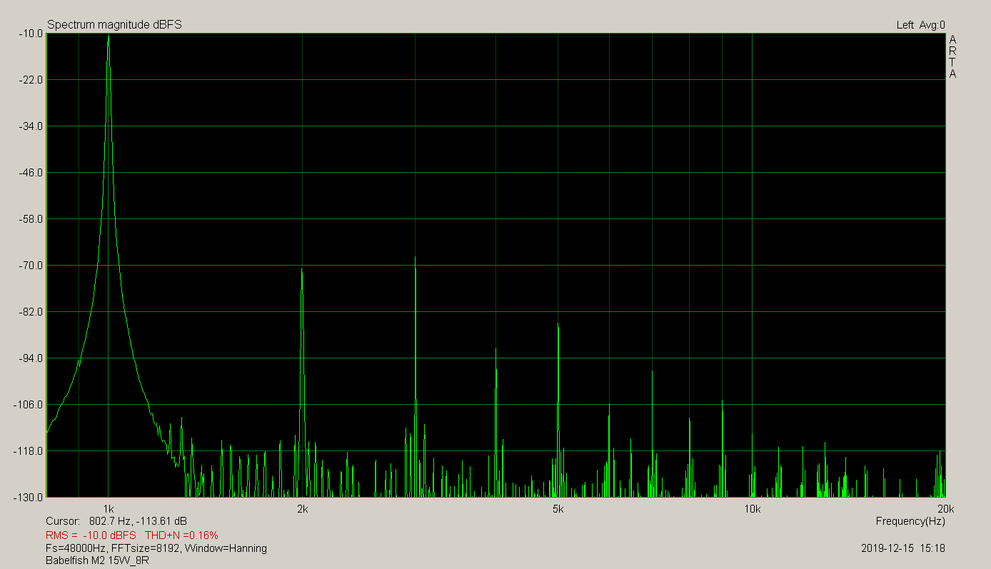

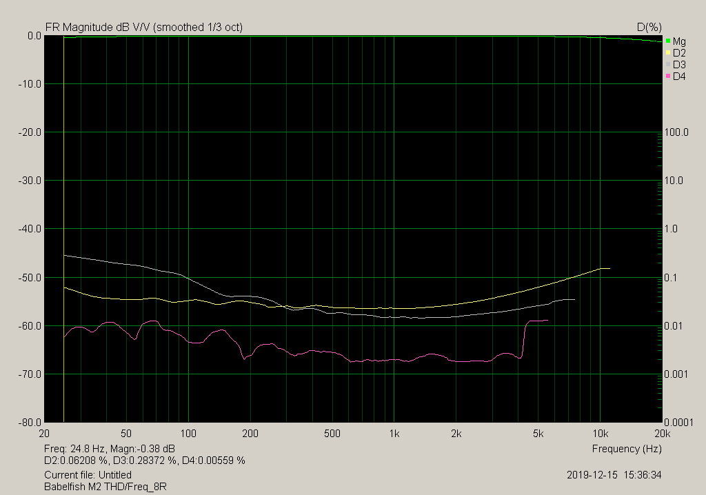

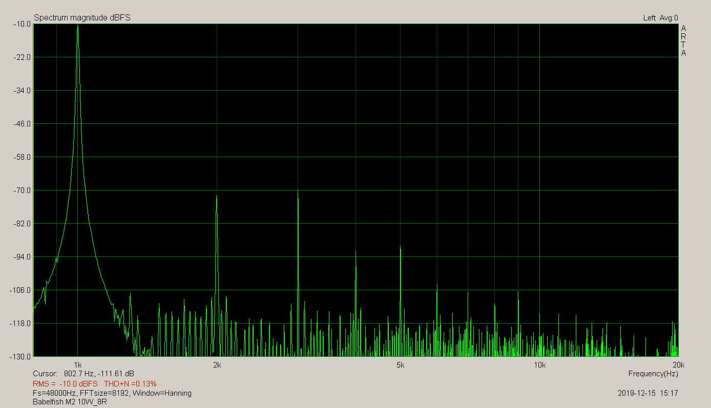

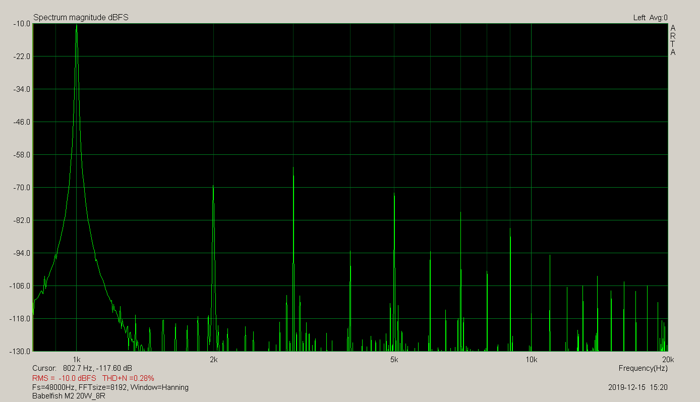

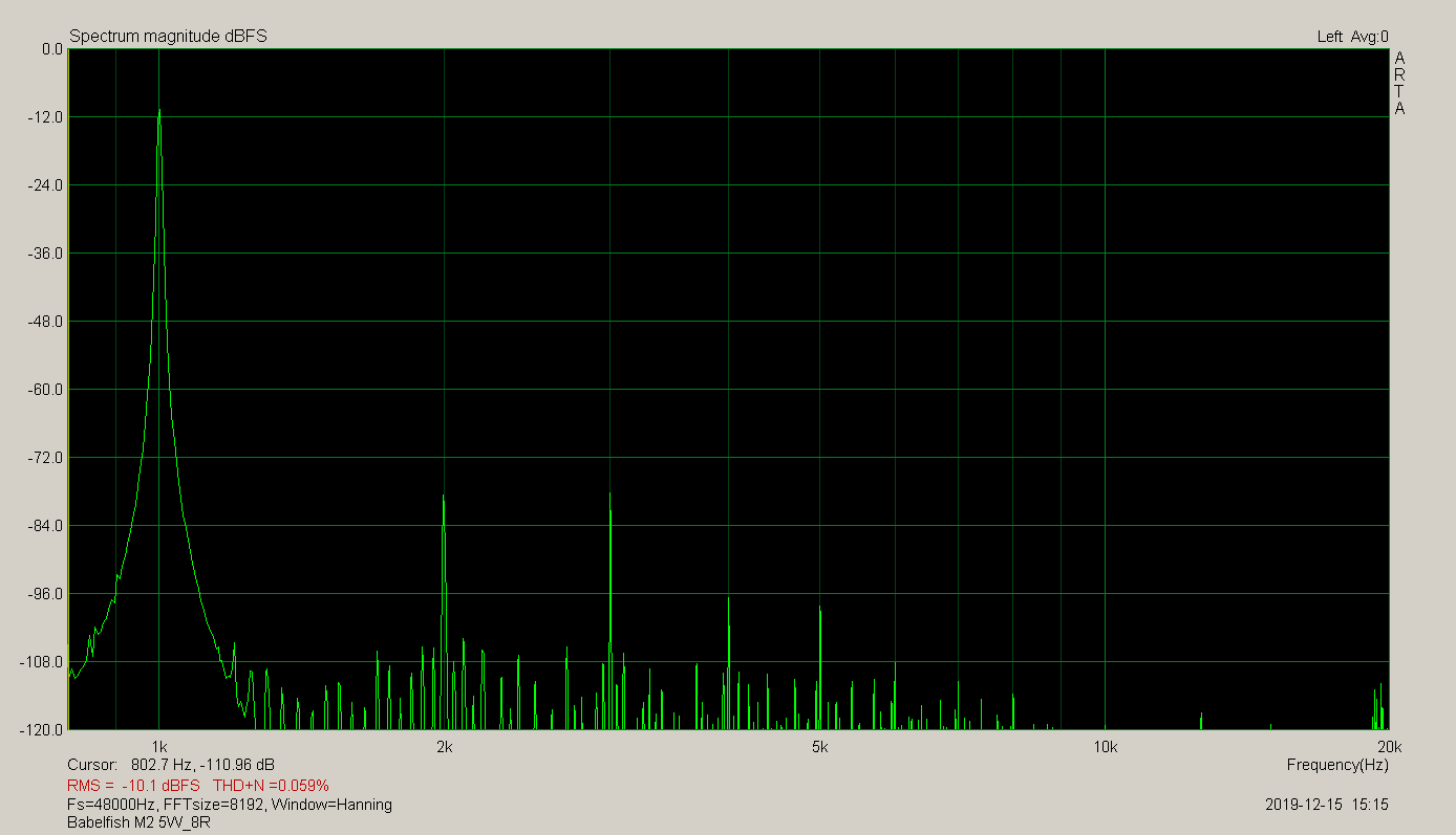

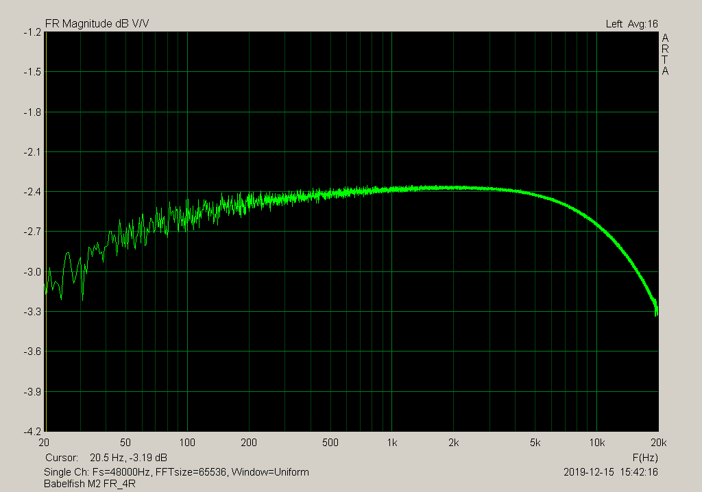

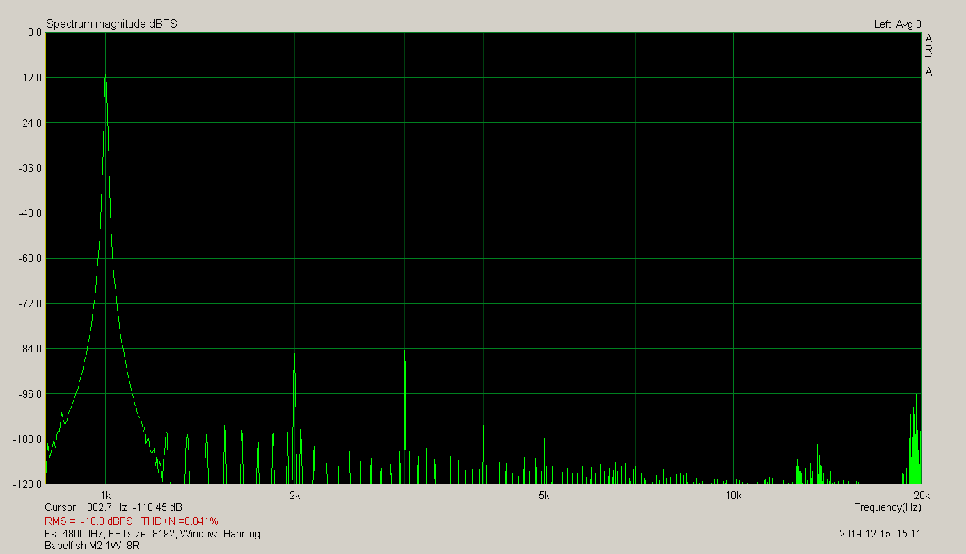

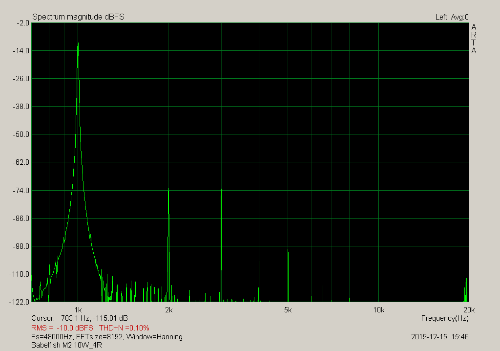

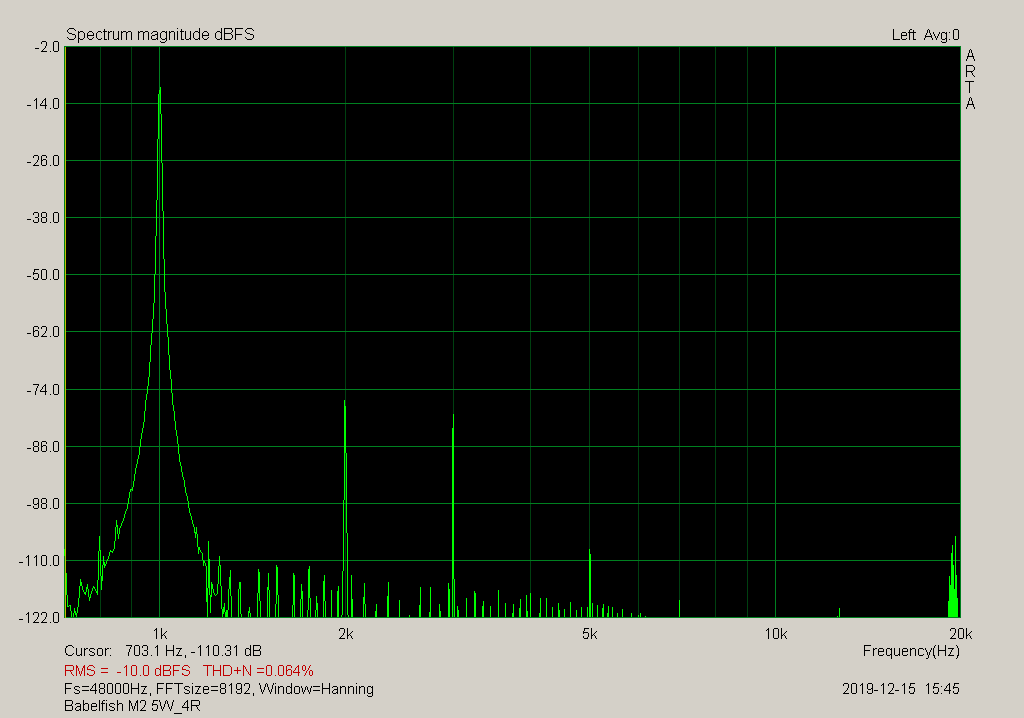

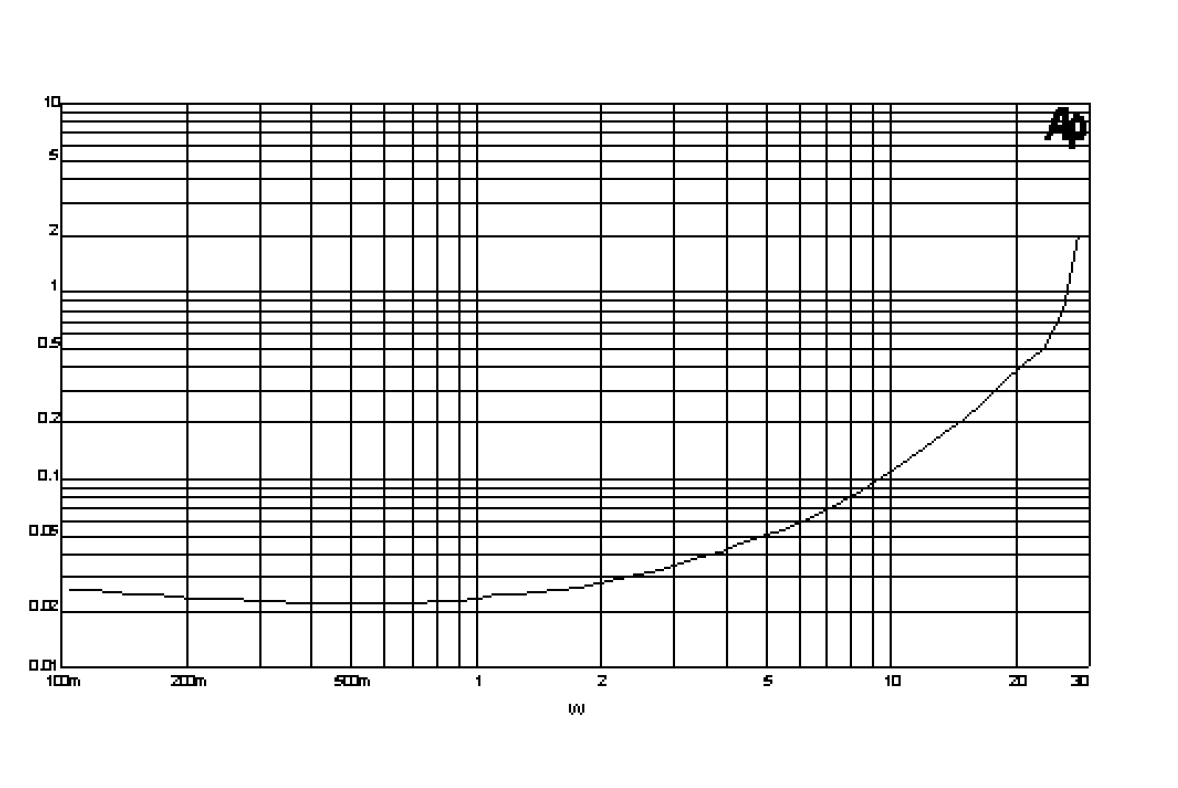

Babelfish M2, hard facts, 8R load
each pic is having own capture , so ...
Edcor 600:15k used , in all tests
25W graph missing - my EMU1212 based setup is not having enough cojones for that , was lazy to add gain block
Papa's original THD graph for comparison

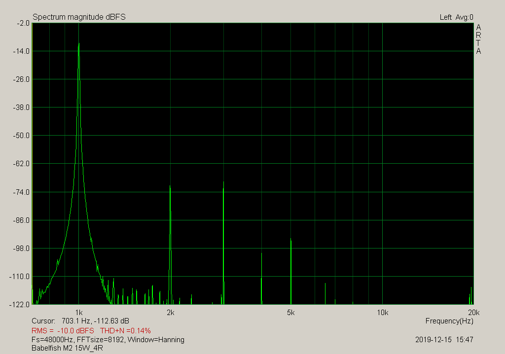

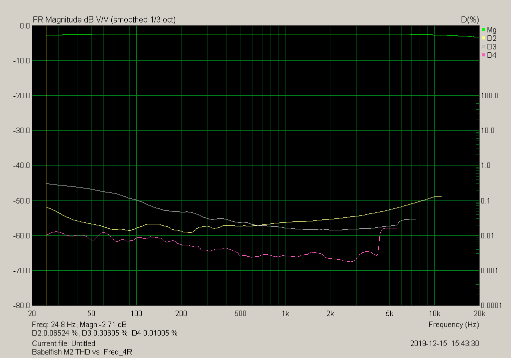

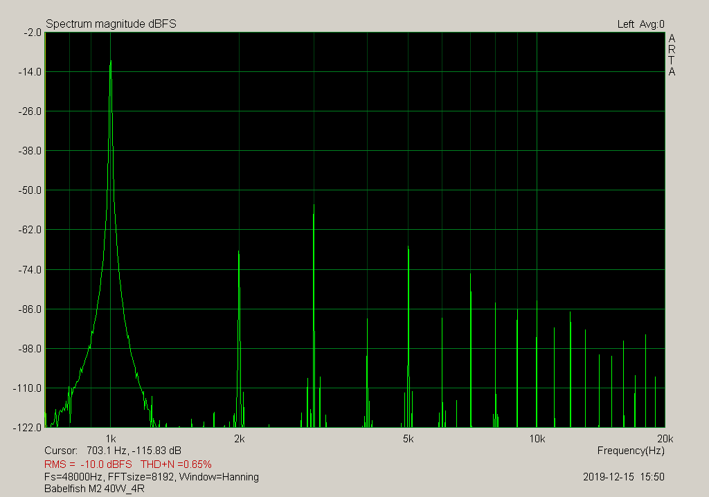

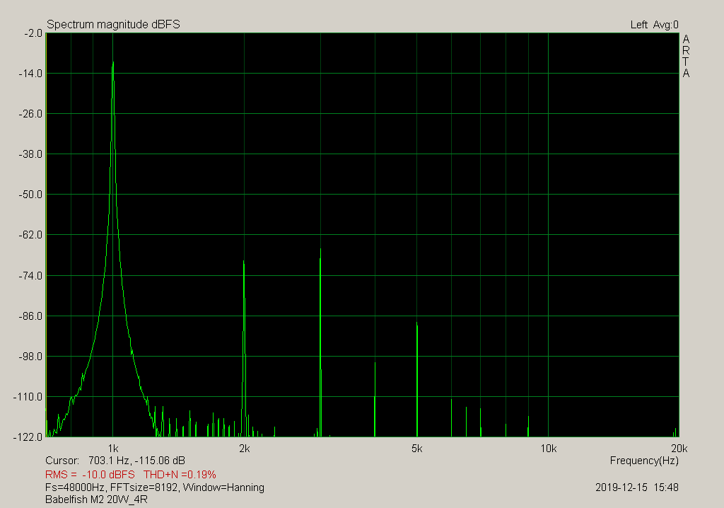

Babelfish M2, hard facts, 4R load
as titled
as titled

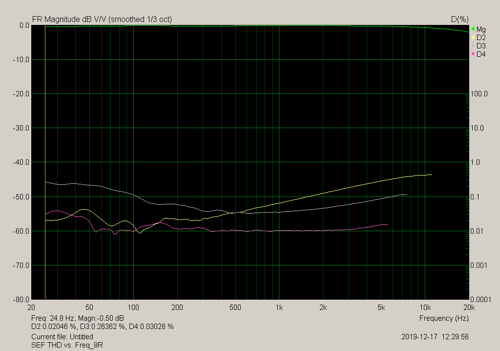

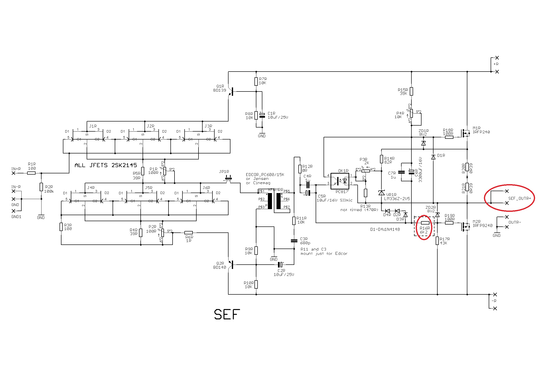

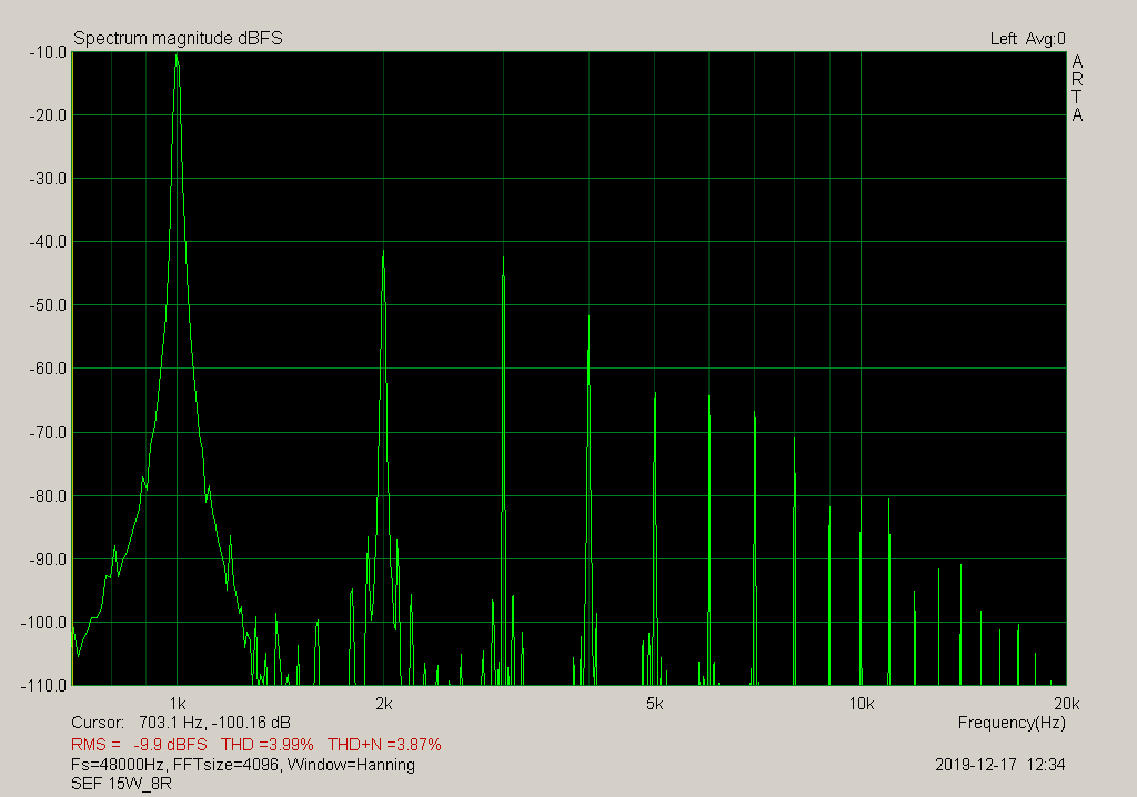

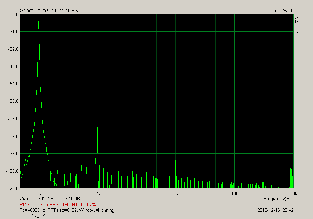

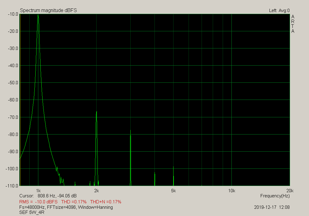

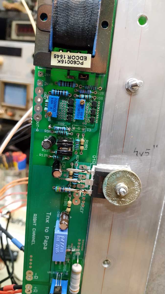

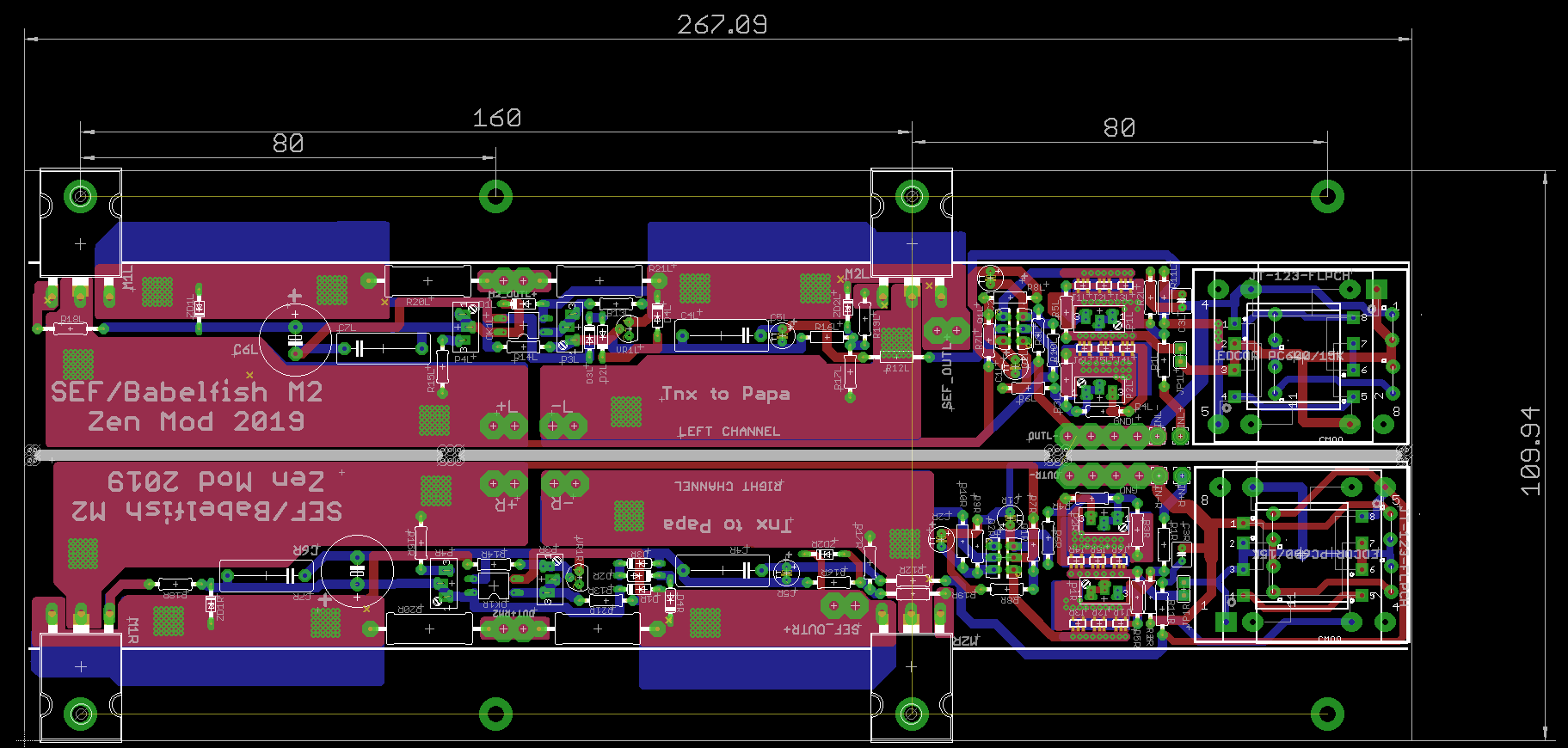

Now more fun one - SEF amp
SEF , as short for Schade Enhanced Follower ;
refer to Papa's DEF amp for idea ...... while entire world is grasping for Symmetry , Mithrandir is deliberately seeking Asymmetry ...... from various reasons
same pcb , same everything , difference vs. Babelfish M2 - circled in red

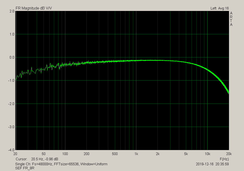

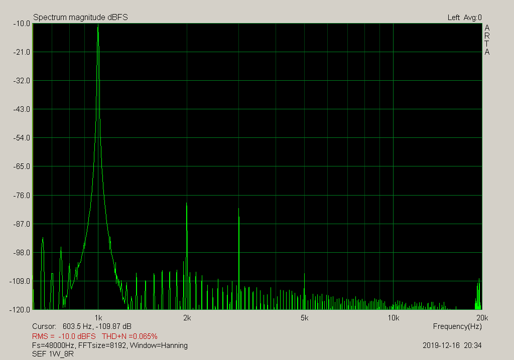

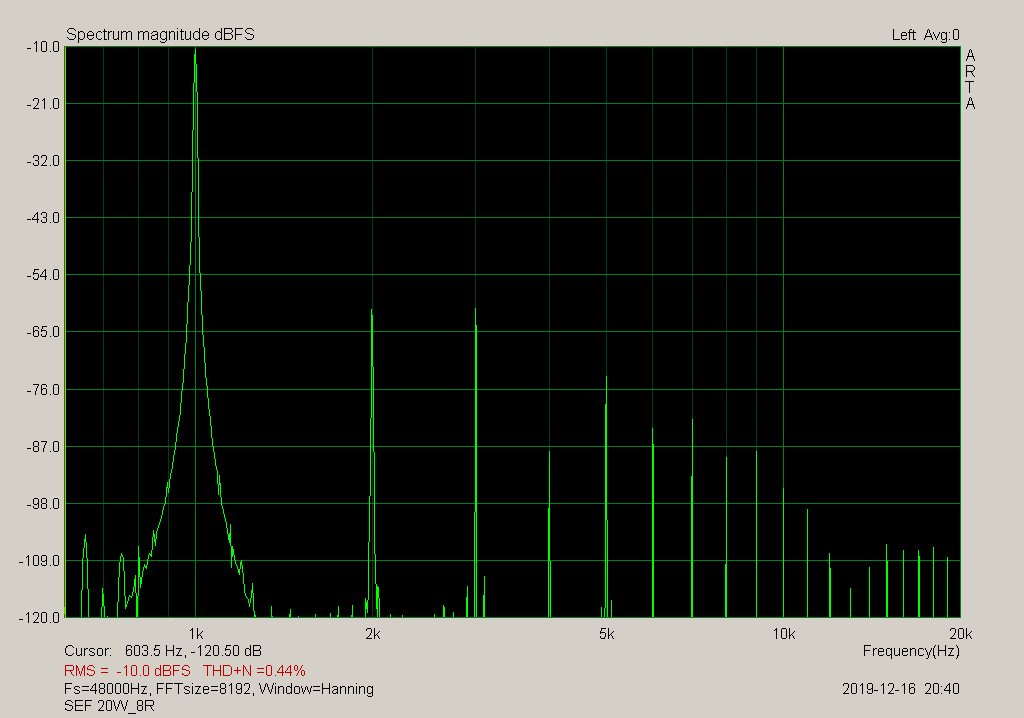

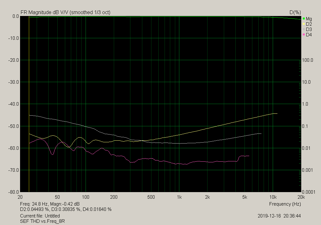

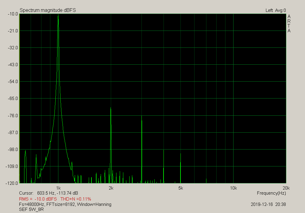

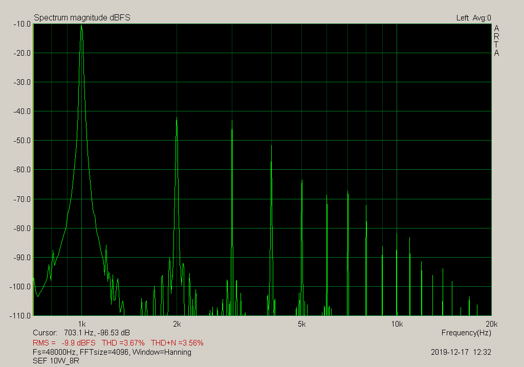

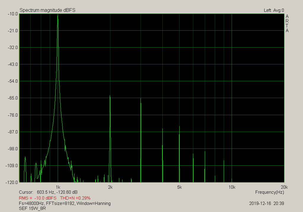

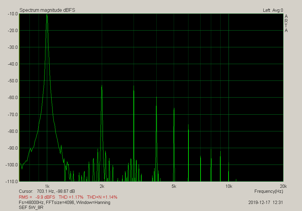

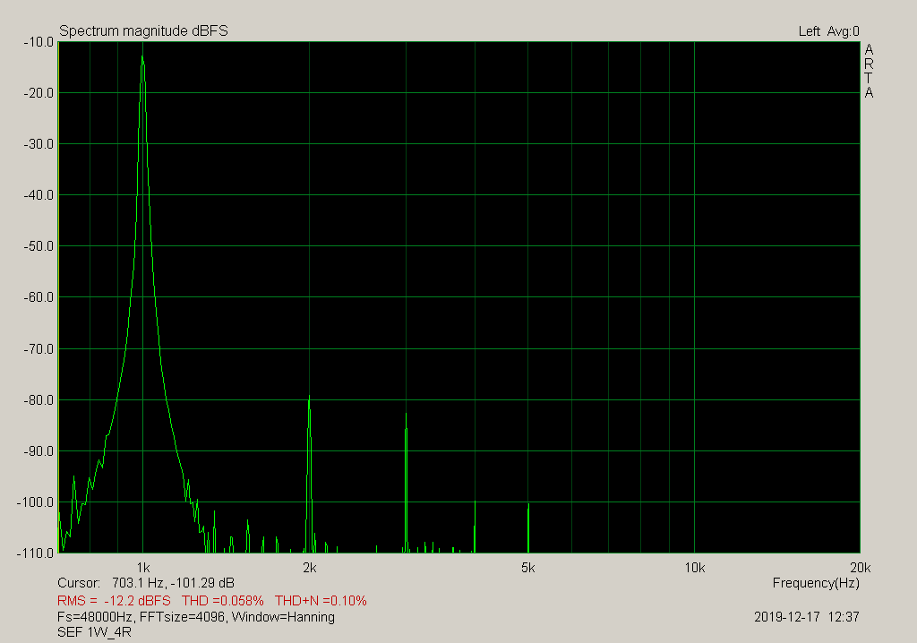

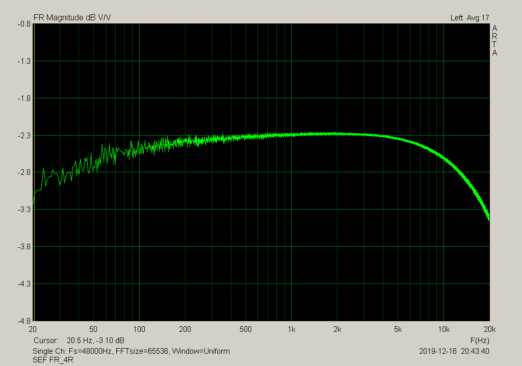

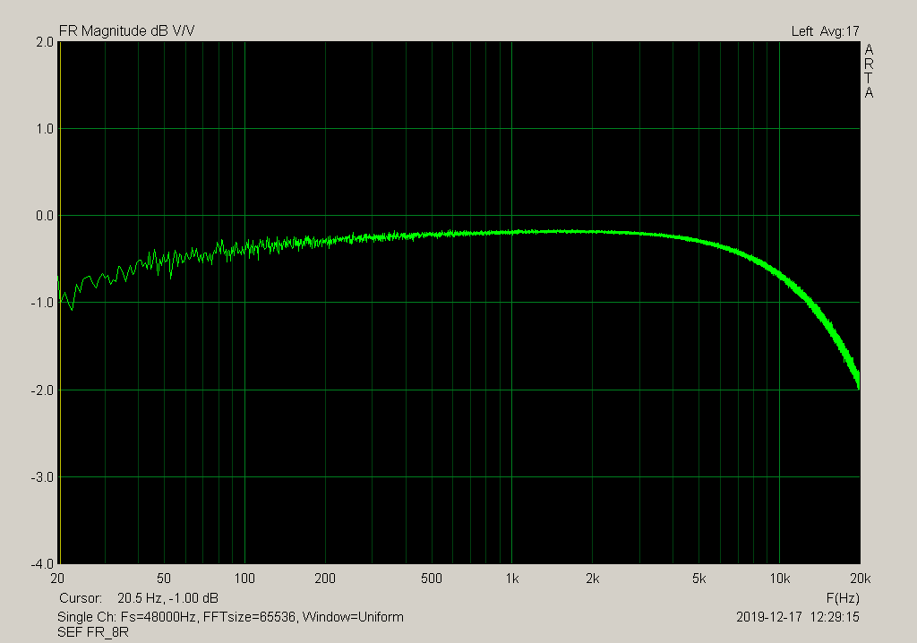

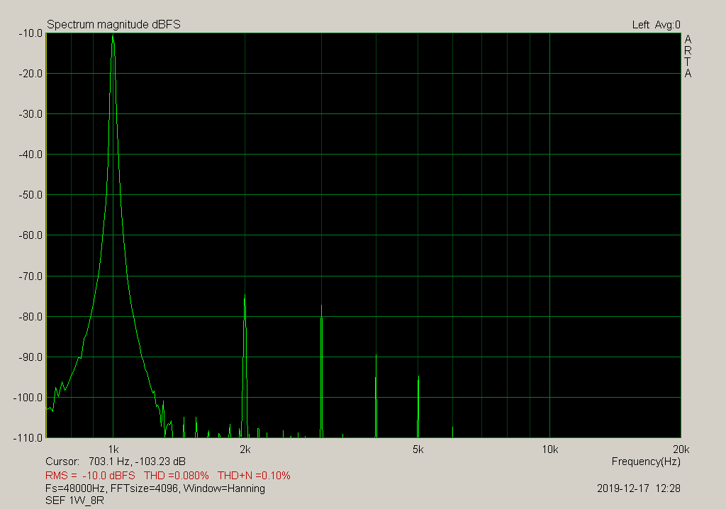

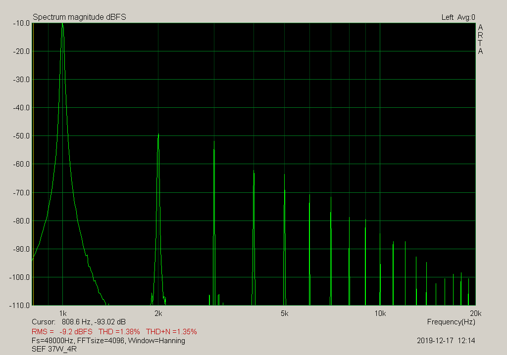

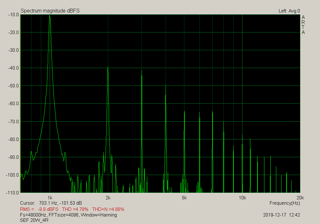

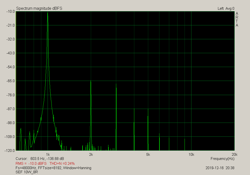

SEF amp, hard facts, 8R load
as titled
as titled

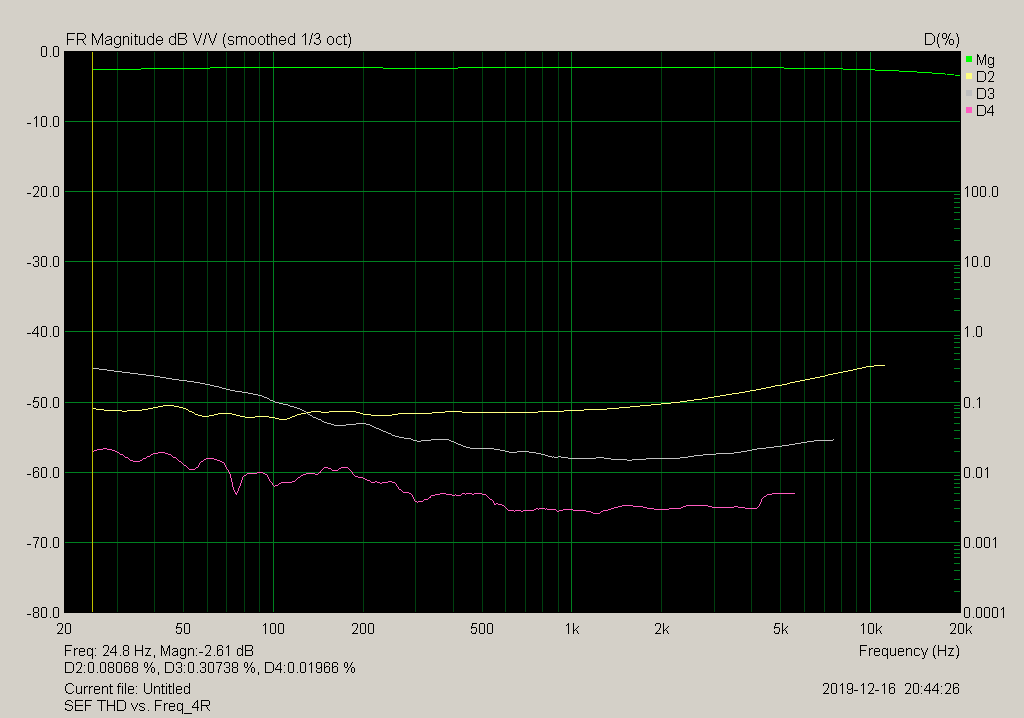

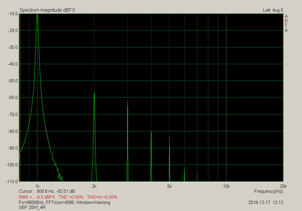

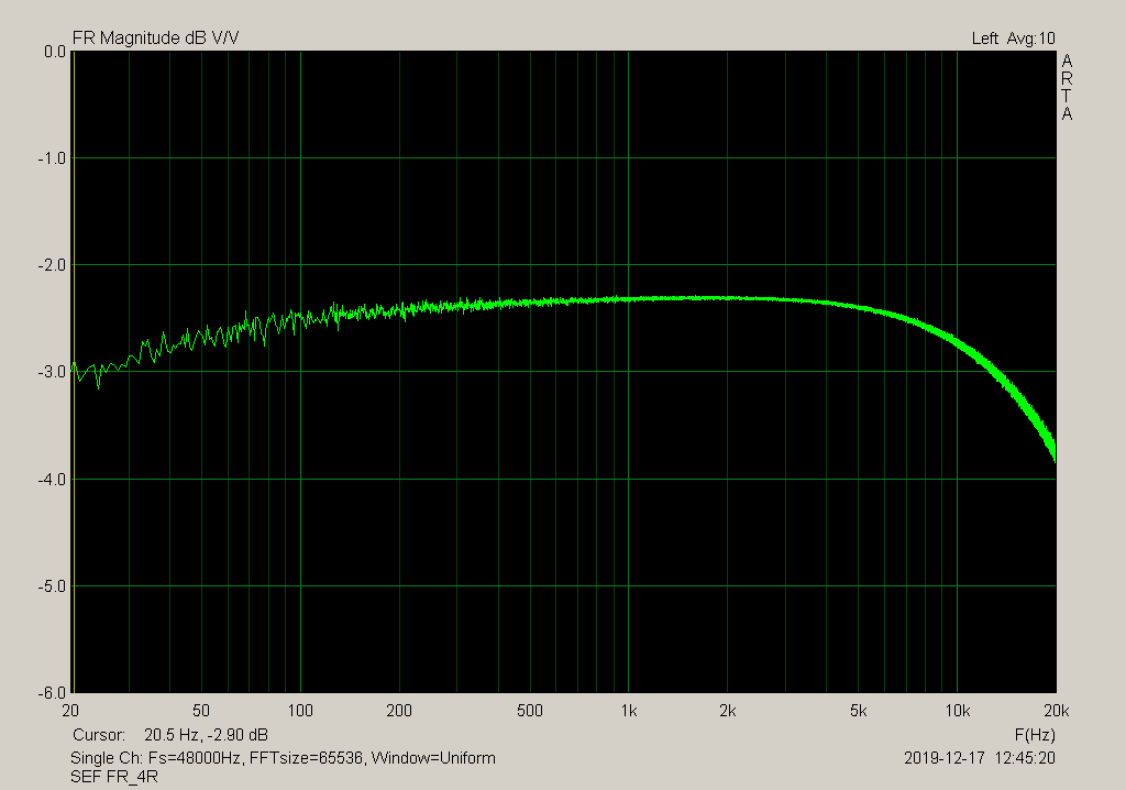

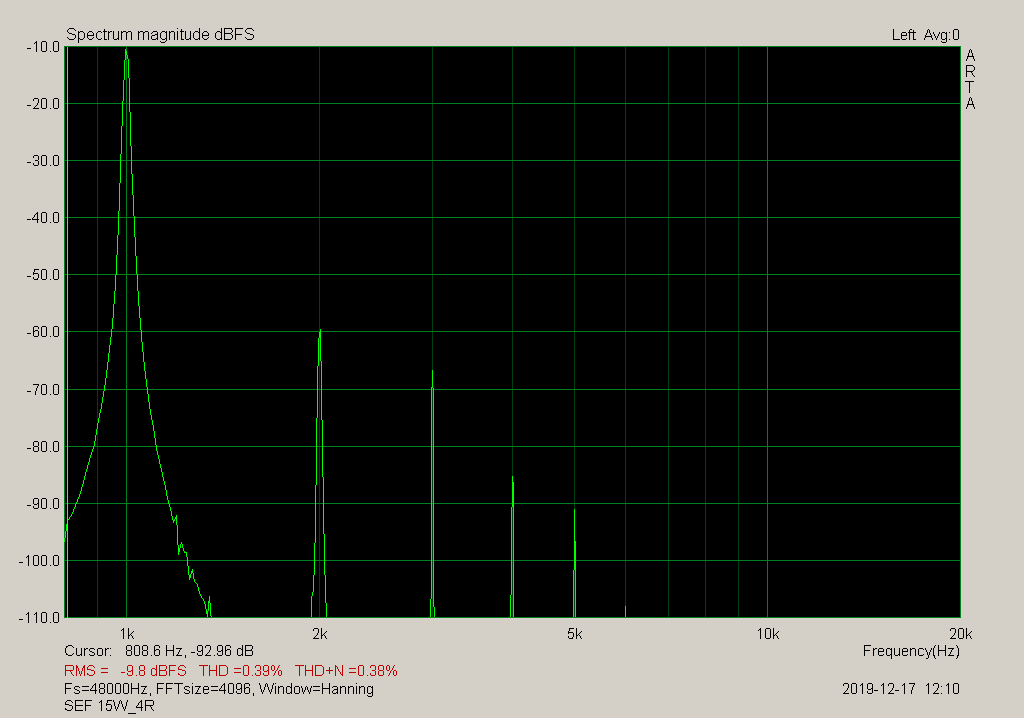

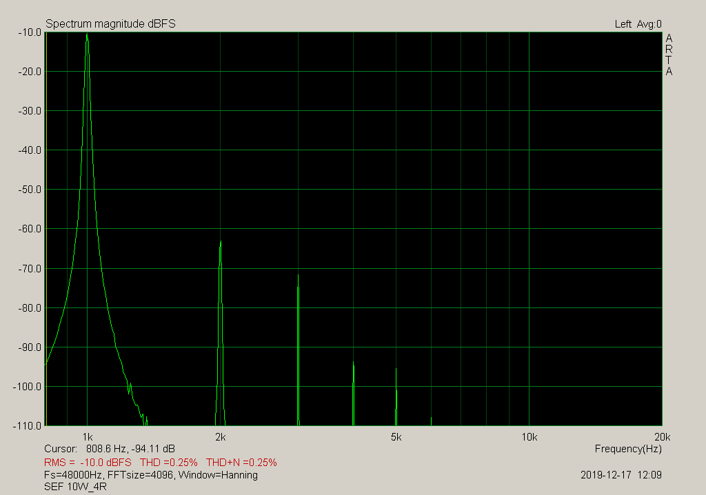

SEF amp, hard facts, 4R load
as titled
as titled

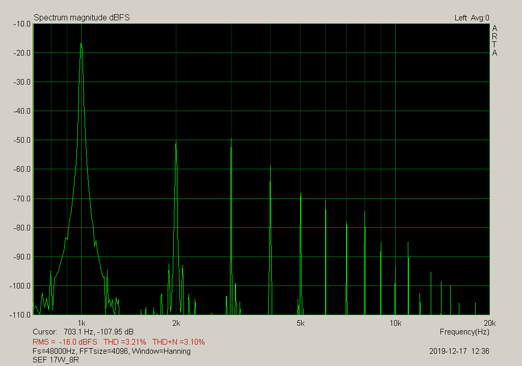

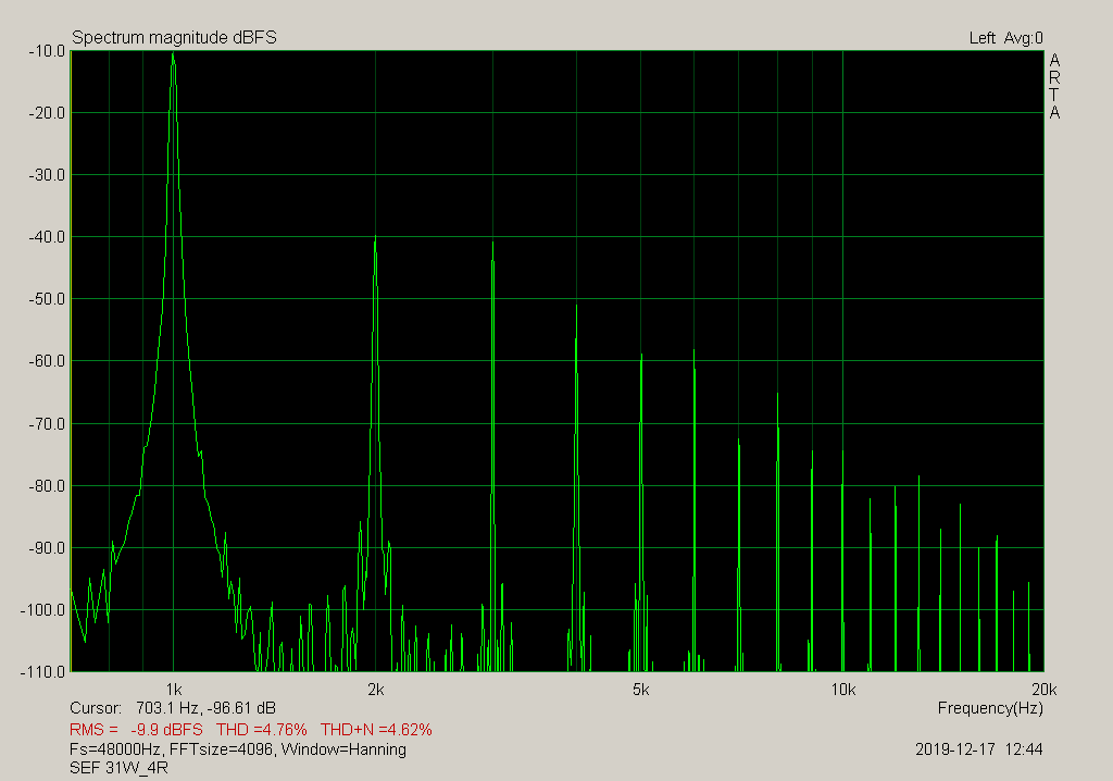

SEF Sugar amp, hard facts, 8R load
as titled
as titled
SEF Sugar amp, hard facts, 4R load
as titled
as titled

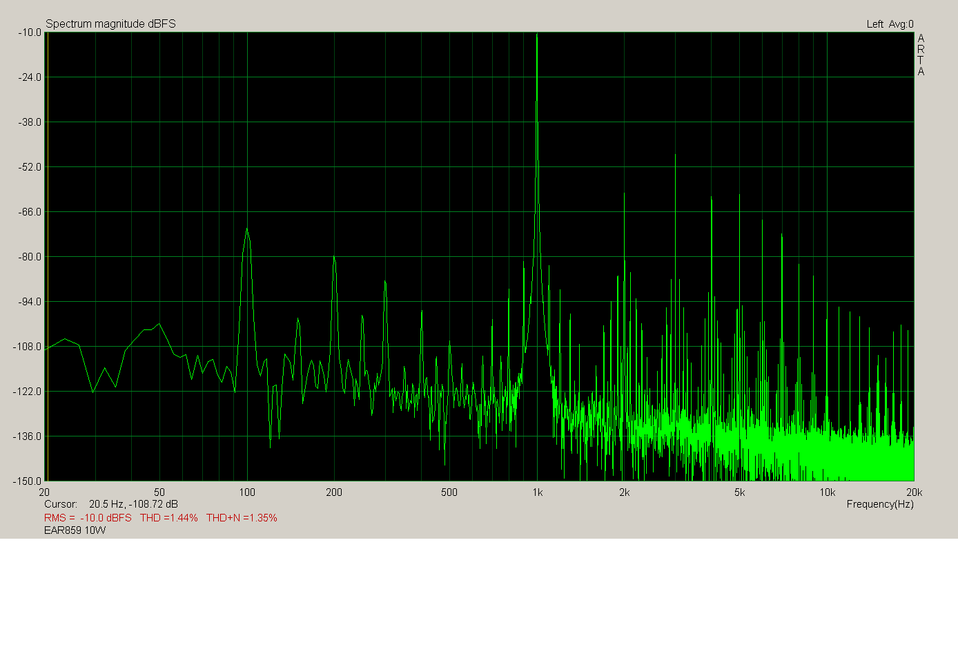

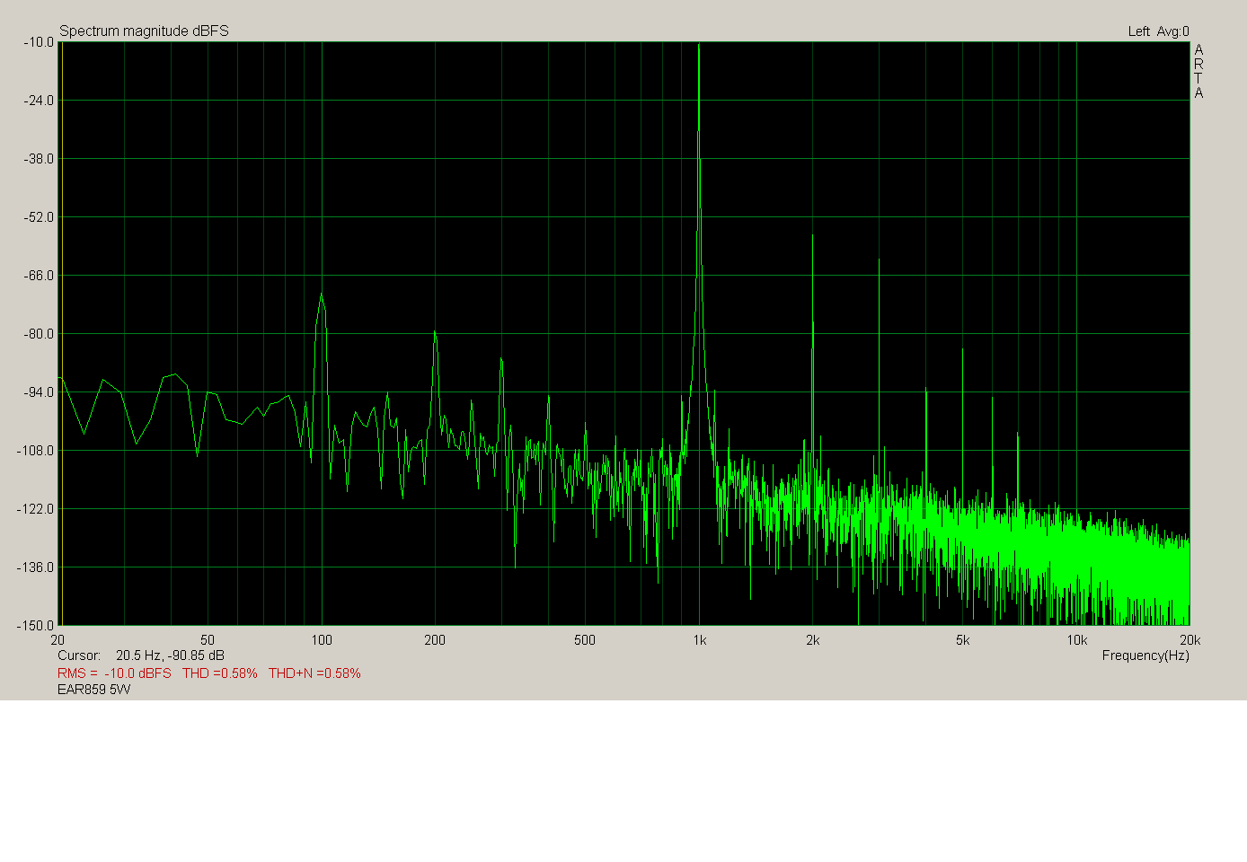

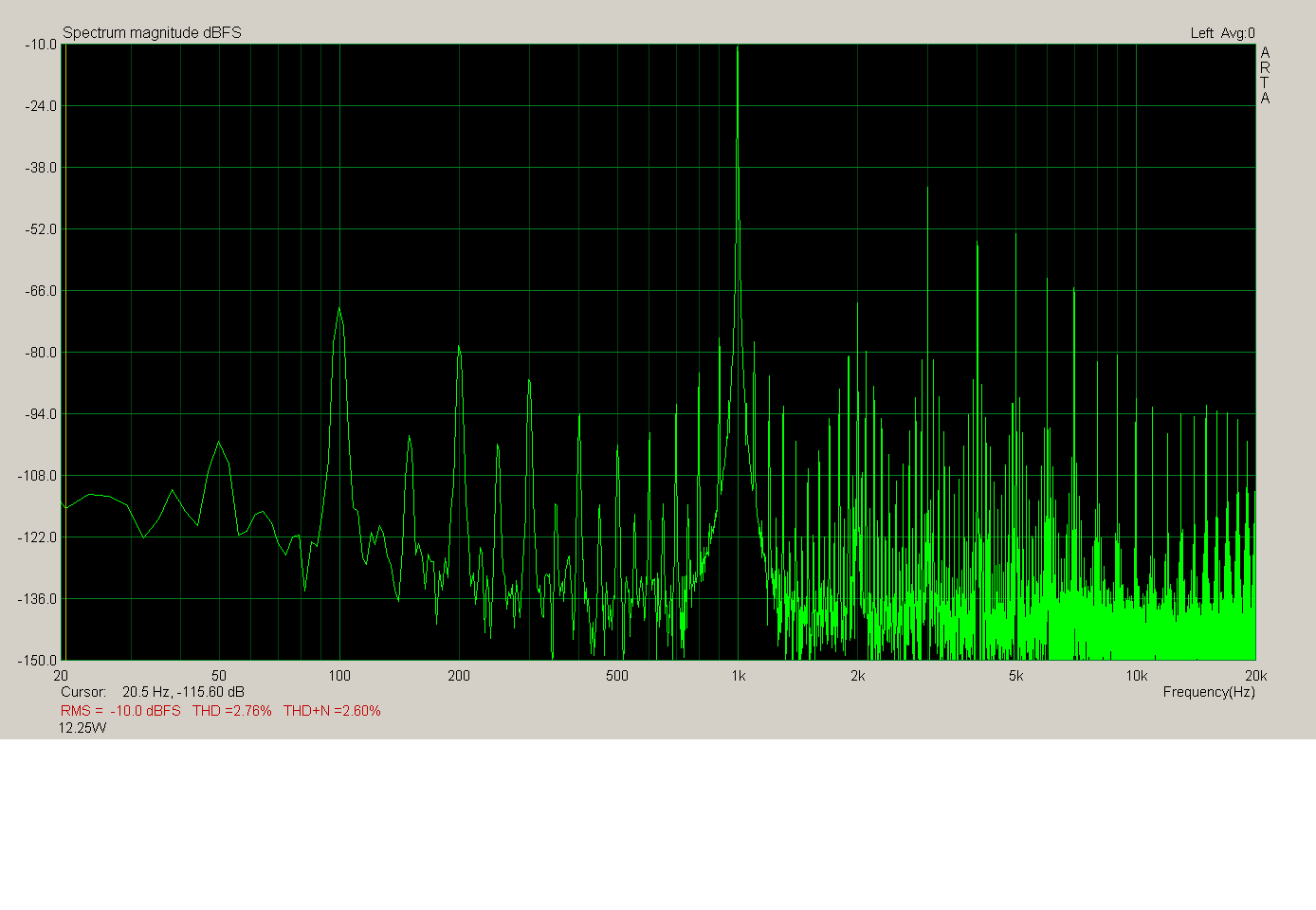

Catch 22 , as if there is ever need to claim existence of one
SEF Sugar iteration , same applies to SEF Final but in much lesser degree - is not Ruthless Party Behemoth ....... from simple fact - when being asked to reproduce substantial level of sine wave for prolonged time , simple biasing mechanismus can't cope , and result is decreasing standing current
of course , regular music isn't sine wave , nor DC , but don't say I didn't warn you
SEF Sugar working in 4R load will suffer most , same with 8R load will suffer less
SEF FInal working in 4R will suffer much less , same working in 8R load will suffer even less
Babelfish M2 is same as regular M2 in that department , but be warned that even these two aren't blameless ....... but we all know what's difference between decent FW format amp and RPB ; if you want one - go buy PL Beastie

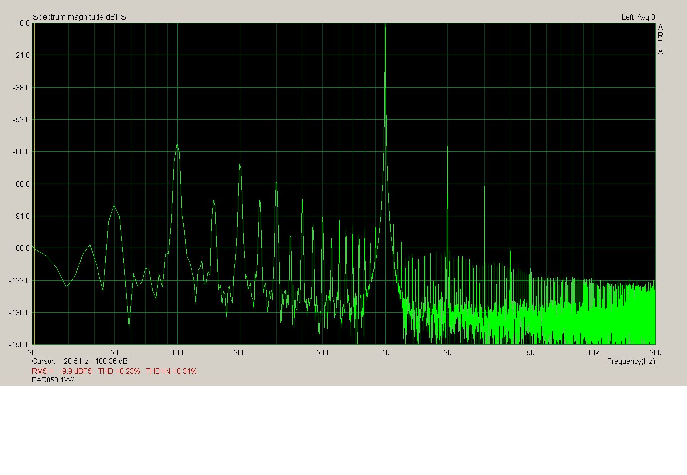

as comparison with SEF Sugar - attached measurements of EAR 859 ; as always - ignore weed generally (not just on graphs
) , ignore everything left of 1K

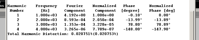

can't - got EMU1212 with one channel fishy , so not able to make any test asking for dual channel
choice is simple - put everything aside and repair EMU , or have fun with new toys and ignore that channel
need to invest some time to resort to QA400 I got few months ago , but sorta hesitating.... either manual is lacking in some areas or thingy (software) isn't made to cover all that
I know later one (410?) can work in conjunction with other software , but this one is sorta orphaned
edit: SEF FInal sim sshot attached
DefiSit has the SIT on the N side and has neg phase D2. I suspect the Schade R (R16) should be on the N side for neg phase.
you're certainly right, as usual
.....output node arrangement , when we flip that and position of Schade-d mosfet , THD raise up for some 6db or so , what I measured in vivo , few days ago , to check what sim predicted
dunno , probably xconductances , I mean difference between N and P are culprit
it's easy to flip speaker phase , anyway

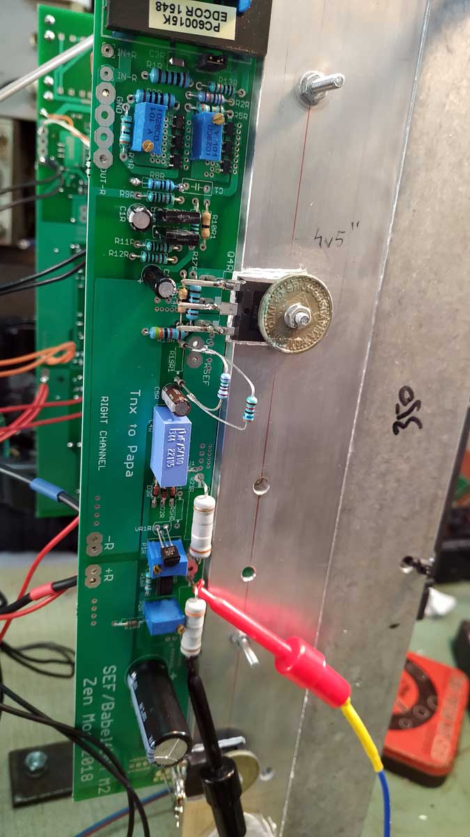

no one yet tried converting his M2 to SEF ?
it's easy - inserting just one resistor and moving LS output wire to other place , with some slight readjust ....
Well.. I want to try it ! But noob questions : what kind of difference in sound quality can we expect between the original and sef? And : the mod to sef is ok on the original schematic too? I know there’s no big difference between your’s and original but asking anyway to be sure.
Hubert
Hubert
OK , I'll post tonight original schm with edit to SEF
you can expect little more sugar and - what's most important , you can set it to your own liking, simply trying few values for one tiny resistor
