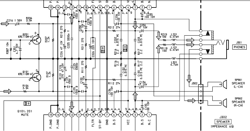

I have a radio which uses BA5417, and have enormous gain(45db), thus have audible hiss & easily amplifies RF, chip noise, etc. My idea is to reduce the gain of the amplifier, maximize the Negative Feedback, but I have no idea how to reduce the gain.
The radio's circuit is slightly different than BA5417 original datasheet's circuit, so I couldn't find the NFB divider.
I'm learing from discrete amplifier, but i would make use of this circuit with the minimum modification. (to preserve the board, avoid changing of board)
If i'm not wrong, changing only the gain(NFB) would usually changes the Iq & DC offset, is there compensation i need to add ?

Yes it does look like R110 and R111 are used for adjusting the gain. Though the values don't seem to make sense for a gain of 45. I'd have thought a 1K resistor in the place of the 270 should bring the gain down to about 29 times. but using a simple calculation for the 30K internal resistor with 45 ohms internal + 270 ohms external for the shown schematic seems to imply a gain of 95 times not 45 (or were you talking db?, that would be about 40db).
I'm uncertain about the dc offset but since there are feedback capacitors fitted (c126 and C130) the gain at dc should be zero, so I don't think that changing the gain should have any effect on the dc offset.

Apparently the amplifier that is inverting in the datasheet BTL config is used in non-inverting mode and vice versa.
Since BTL amps aren't exactly transparent to me, I resorted to drawing and simulating this one. Interesting. You get about 45 dB of gain for the speaker and 39 dB for headphones. Speaker gain can be increased further by decreasing R112, but in order to get basic gain down, you'd have to increase R110. (Same for R2xx counterparts.) Since there already are open-loop-gain draining caps present, the risk of oscillation should be relatively low as long as you don't overdo it (going down to about 20 dB should be quite feasible).
So how much gain do you want for headphones and speakers, respectively? Are you satisfied with headphone driving? (100 ohms of output impedance is on the higher side of things by hi-fi standards, and those coupling caps aren't too huge.)
Hard to tell. Try a 3k3 and see what happens. Do you have anything that could be used to probe for RF up to a few MHz? If the chip gets warm and power draw is up, you obviously have oscillation, but it can be much more subtle while still degrading performance.
With a 3k3 for both R110 AND R111 (you need to get noise gain down for both amplifiers for hiss to be reduced effectively), you should be getting about 26 dB of voltage gain... if that works out well, you have lost almost 20 dB of hiss, which tends to be a BIG improvement subjectively. Distortion will also be reduced accordingly.
Try that and see how it works out. A bit of gain to spare tends to be quite useful at times.

R111 only: Not much of a difference, gain goes up by <1 dB.
R110 only: Gain goes down by 20 dB, but since the other amp is still running at 40 dB of gain, reduction of hiss (and distortion) is limited to a maximum of 6 dB.
Neither really is what you want.

sgrossklass, I have done trying with 2.7k resistor, and no problem seems so far (tested few minute only though)
The hiss is reduced significantly, nice sound is retained though. However, The amplifier isn't sound nice when using direct PC soundcard (compare to other amplifier), however when i use a good quality external soundcard, its sounds nice.
Does this have relation to input impedance ? Maybe the soundcard was driving the amplifier hard ?
I'm also thinking to bypass headphone, how should I connect ?
Could I just bypass C234, R219, L201 ? means can I connect positive side of C134/234 to positive post of each speakers ?
