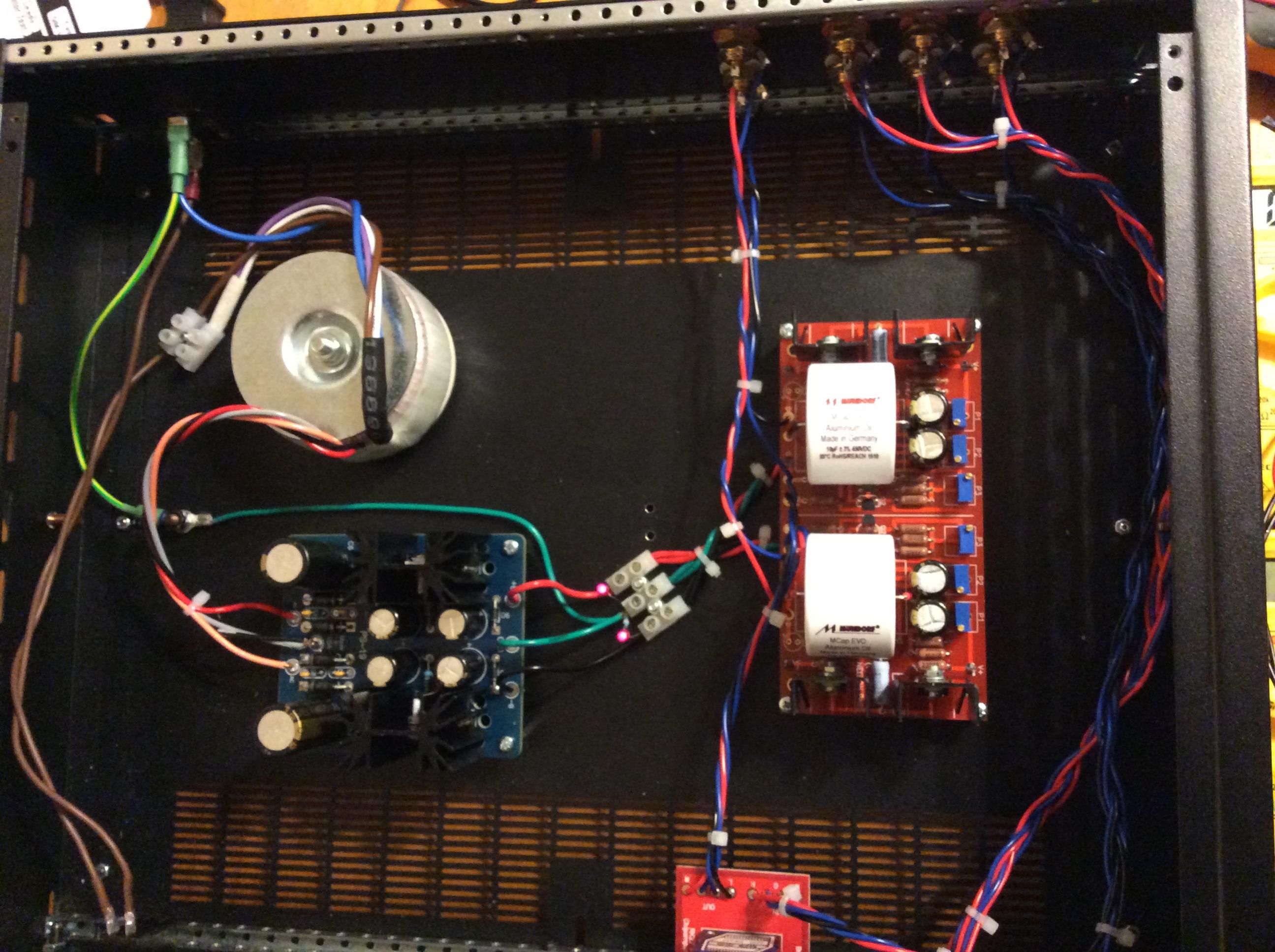

The noise is heard through the speakers and is present regardless of volume setting.
I have attached a picture below.
Hopefully this all looks pretty straightforward. Just out of image is the volume control which is an alps blue 50k pot. I tried to route everything neatly and twisted all signal and power(ac and dc) where I could. There is a single earh point between the transformer and ps (see bolt). The standoffs are fairly low I might see if I can lift these up a bit to see if I am picking up any noise from the dc supply which run under the amp board.

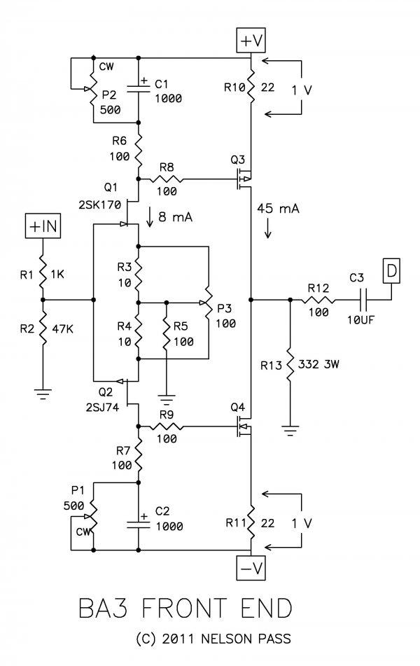

Ba3 gain is 20db ish, gainclone is 30db ish. A lot of gain. Probably don't need a preamp. Noise will definitely be more evident with the ba3 than without it due to massive system gain.
I don't see a ground breaker between the chassis and psu ground, Also, I see mains wire to the transformer missing. Should be totally silent then...since it won't be working. But Iam guessing that pic was just during the troubleshooting phase.
I would add a cl60 or resistor between psu ground and chassis. Lots of ways to do this. You could have a bad ground loop between the gainclone and ba3 via house wiring because they are not isolated.

Thanks zenmod the problem definitely seems to be too much gain. I put an attenuator between the BA3 pre and my gainclone and a cut of 6 to 10db (and more) removed all noise (I have attached link to schematic used). I also used another amp and the noise was there too, albeit at a little lower level, but still present.
With some attenuation, music now disappears into a very black background and exhibits the wonderful musicality seen from day one. The question therefore is how much gain should I take out and how, I don't want to have to keep an extra level of attenuation in the system. I am sure Nelson has noted this somewhere, I'll search the threads to find it but if anyone has a link I'd be grateful for it.
The other question is how much gain is enough i.e. what gain should be I be using for something like a gainclone (which I plan to use for the next 6 months or so) and what new resistor values this requires. Also what levels would be required for an F6 or amp camps versus an F4 - which is what I want to go to after the gainclone.
Hikari, I tried the cl60 as a ground breaker but this didn't reduce the noise, it seems that the existing gain structure is bringing up the noise floor to an audible level and that this will go away with a cut to overall gain i.e. pre plus power amps.

Gainclone is 30db gain. F6 is 15db. F4 is 0. Ba3 front end has 20ish db of gain.
For a gainclone I would just use a buffer. For an f6 or f4 I would stick with the stock gain values in the ba3 front end. Also, the pots after the ba3 you are using are pretty much the same thing as having a volume control on the gainclone and just turning it down. It's raising the impedence of the incoming signal which you don't want.
