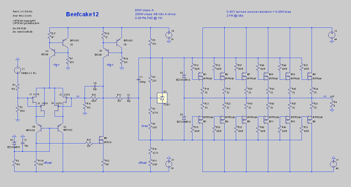

Suppose one had a BA2-like beast with separate FE and OS supplies:
attachment.php

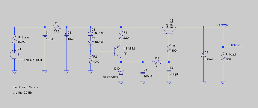

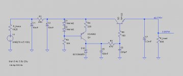

and that the regulated FE supplies looked something like this:
attachment.php
Would that make the "rumble filter" between the FE and OS stages (R11/C6 in first schematic) unnecessary? Or is it not about rail noise to start with?

if you have series reg for FE - better to think about elevated rails - enough higher than OS rails , than thinking about unnecessary additional pre-reg filters
if that is what you're talking about
Rumble filter == high pass filter. And yeah, I'm old enough to have started with rotation vinyl. 😉
But I'm asking about the RC filter between the FE and the OS. Is that for PS noise rejection in the FE, or something else?
FE rails regulated at 50V; OS rails unreg at 44V. Separate transformers.
Thanks!
This evolved from the BA2. I'm just trying to figure out if the RC filter is an appendix or a kidney at this point (ie: vestigial or not).
Papa states "You will note that RC networks appear between the output node of the front end and the input of the output stage. C203 rolls off the low frequency response at about 2 Hz..."
If I didn't need the low frequency roll-off, I could replace the single level-shifting capacitor (C1) with one on each side (like the F4). That speaks to my love of symmetry....
