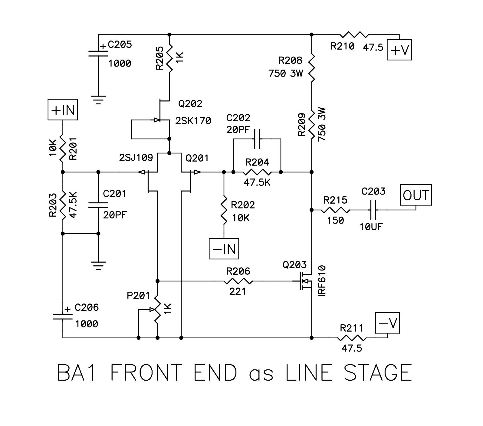

What is the application? Use as a preamp linestage? Driver for a follower amplifier like F4, Theseus, or Vfet?

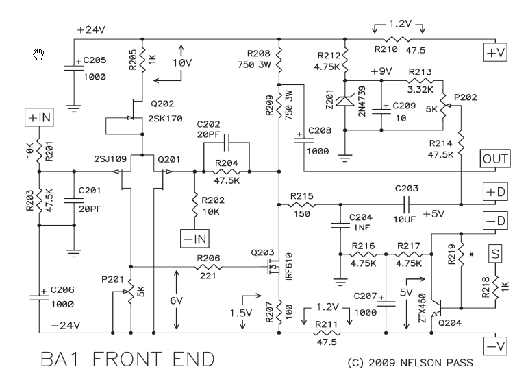

I guess it would come down to if you prefer the sound of a bootstrapped VAS w/ a MOSFET..... or a BJT VAS w/ CCS. I guess you build both and do a shootout, no holds barred, winner take all.... When I built the BA1 as a stand alone FE, I added a banana jack on the back of the chassis to allow a connection back from the output stage, to feed the bootstrap cap. Bootstrapping is a technique using AC that will greatly increase the effective resistance of R209, forcing the voltage across it to be essentially constant. Linearity is greatly improved. The schematic in post #1 is not implementing the bootstrap cap though... I would add it if high performance is desired.
As a linestage? I suspect FE2022 will be the better answer, it uses much easier to obtain parts, works beautifully at lower gain, and is available now.

I would suggest you do not use the stock gain settings of 10x (20db) as gains that high are intended to run follower amplifiers directly. For a linestage, start with R3, R4 in the range of 20k-30k, and adjust if you still have too much gain.
