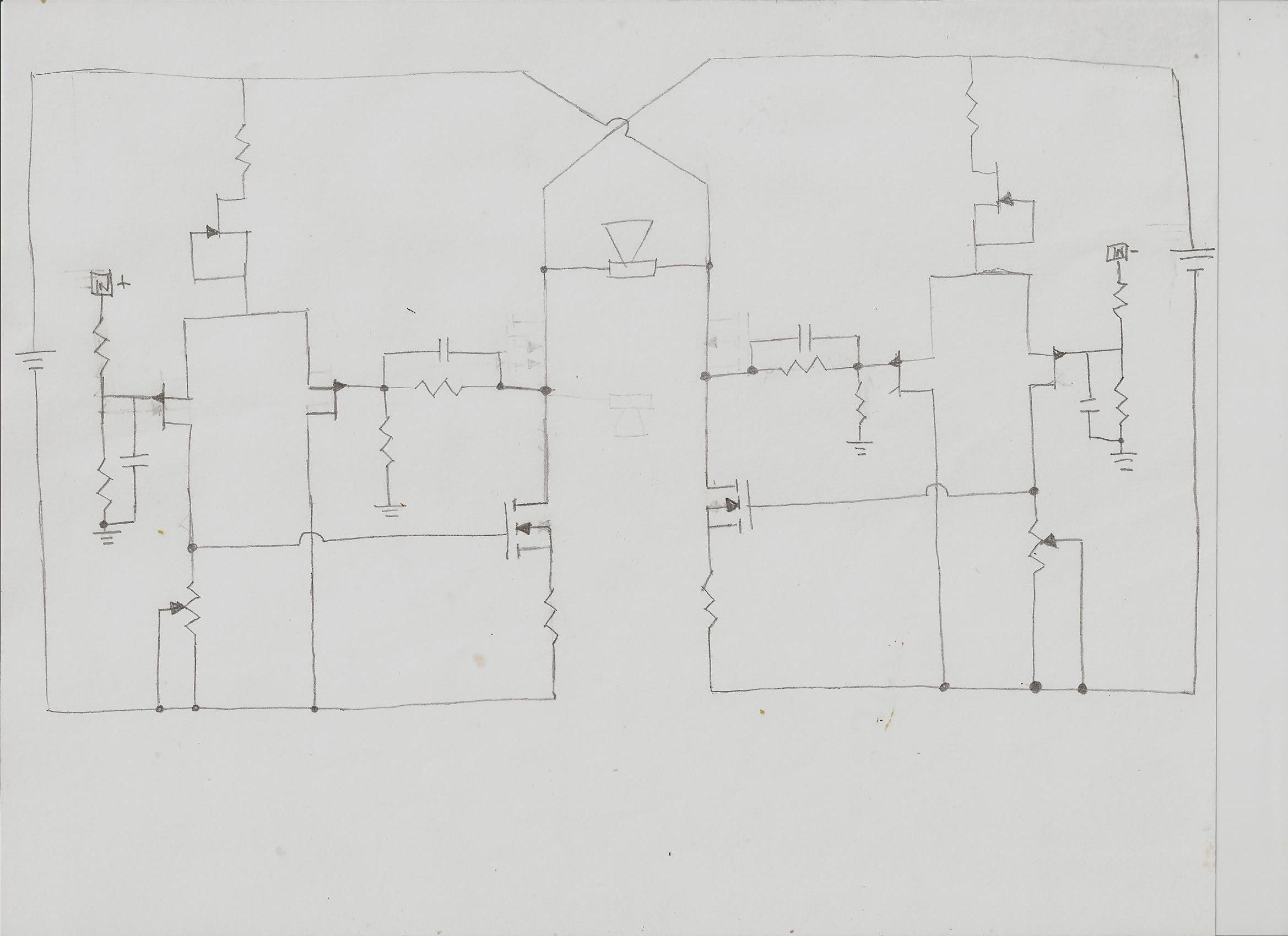

I mentioned it because it's an interesting example of how
things work - the output device is actually driven by the
voltage across the resistor with current provided by the
input JFET. This voltage has been bootstrapped by the
output, so now it depends on the gain of the output
device.
So you have to ask yourself - is this really a follower?
Michael,
Is he saying that ground resistors R13/R14 in your schemtic is bootstrapping the Jfet front end, making it a ccs for the output fets. Is th output fet being operated common gate? What resistor is bootstrapping the output? THere is so much going on in this "simple" little amp. One thing that has helped is reading a post by Nelson in which he states that the fets have no idea whether they are being operated common source or common drain. It helps you see that there are in fact, copies of the signal everywhere in this thing.
R11/12. I believe NP is applying the term bootstrap to the positive feedback in this case.
Strike the bit about "making it a ccs for the output"
The salient point for for me was "The output device is actually driven by the
input JFET."
Now, go back to the diagram I originally posted and look at it again.

indeed, that quote by Nelson was what really made the penny drop for me too. i only had theories of how circlotrons worked before that and your cut is the perfect amp to toy around with as its a relatively pure example

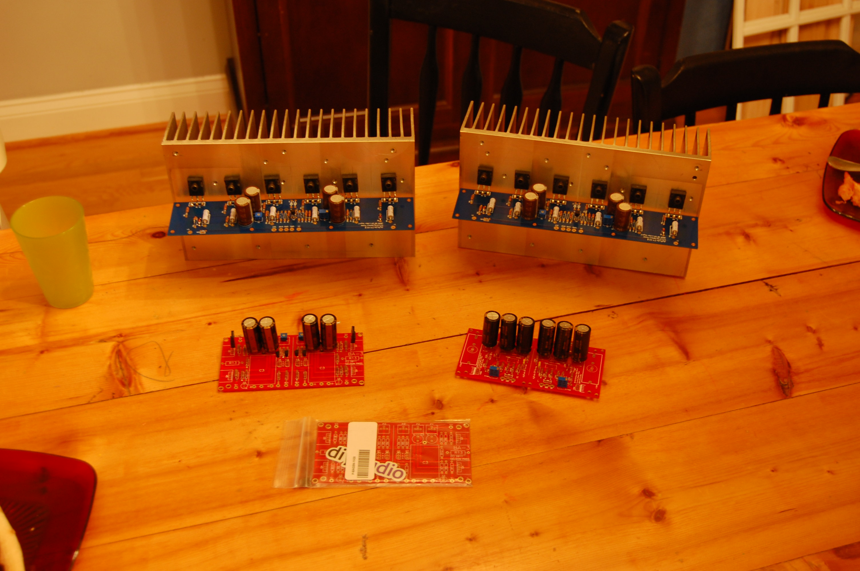

Here is what I have gotten done today. Crippled F4 with IRF(another set awaiting Laterals 2sk1058/sj213), BA-2 FE, BA-3 FE, and twin sister BA-3B on deck. Realized I ordered TO-220 instead 247 mica insulators so know listening this weekend. I will finish everything but mounting, so next weekend will be listening time and beginnings of circlotron experiments. I will try Jfet FE plus 2sK2013 output for what i hope is simple BA-C FE in the makings. A couple pre-reality ideas include singe differential pair used as phase splitter driving both sides and two diif pair with one driving each side with feedback like Ba-2. These are either decent ideas or a revelation of how little i know. Based on the thread, I am sticking with the latter. Soon enough we will find out. I have some extra fets to sacrifice to the BA gods!

I think something may have clicked about the bootstrap and how it drives the output. The voltage that is seen across R11/12 affects the Vgs of the Jfet, manipulating/ changing the transconductance and ultimately the current at it's drain, which in turn affects the voltage at the gate of the mosfet. So, in essence, the Vdrop across that resistor does drive the output in a twisted circlotron sort of way.
