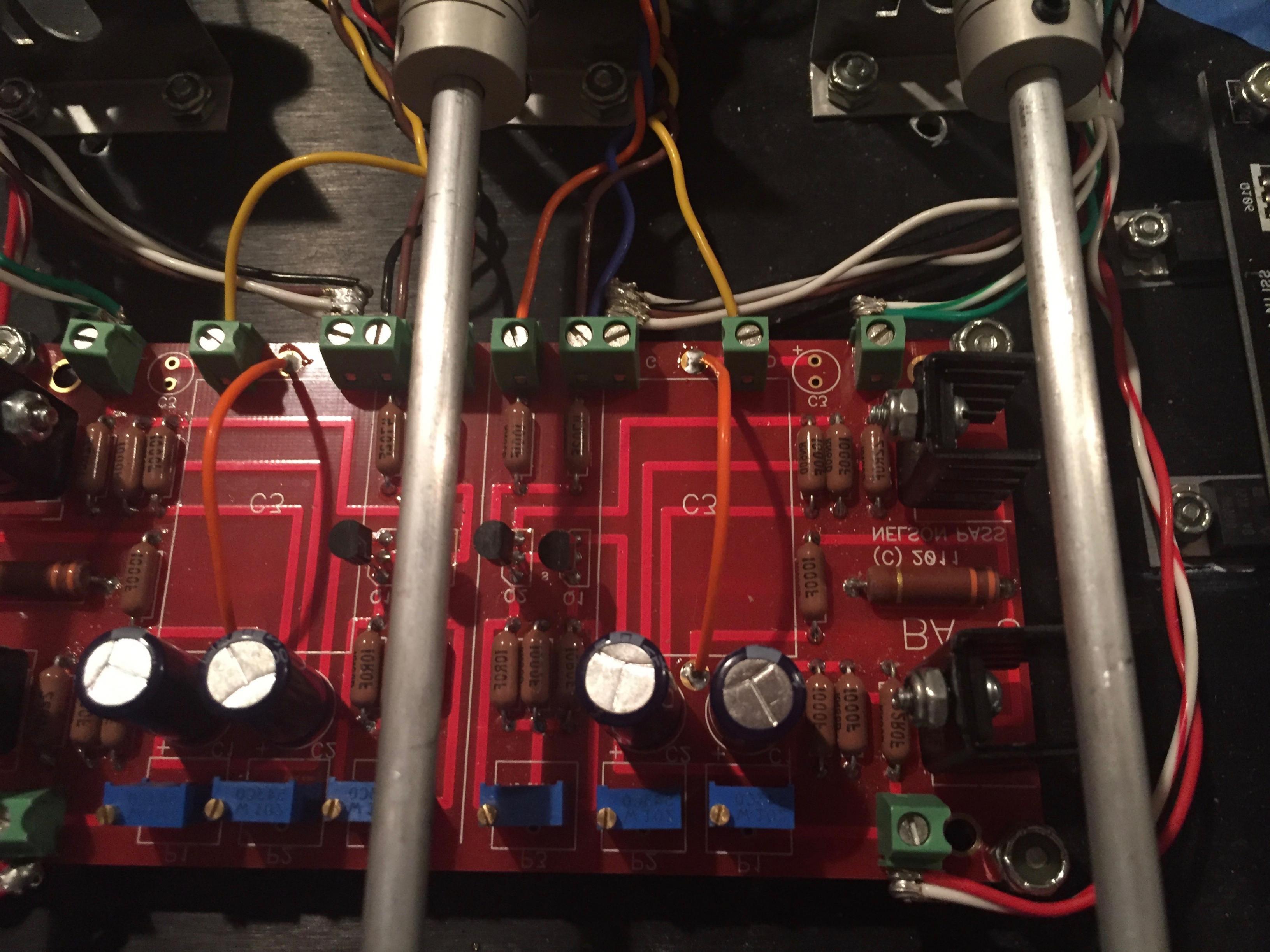

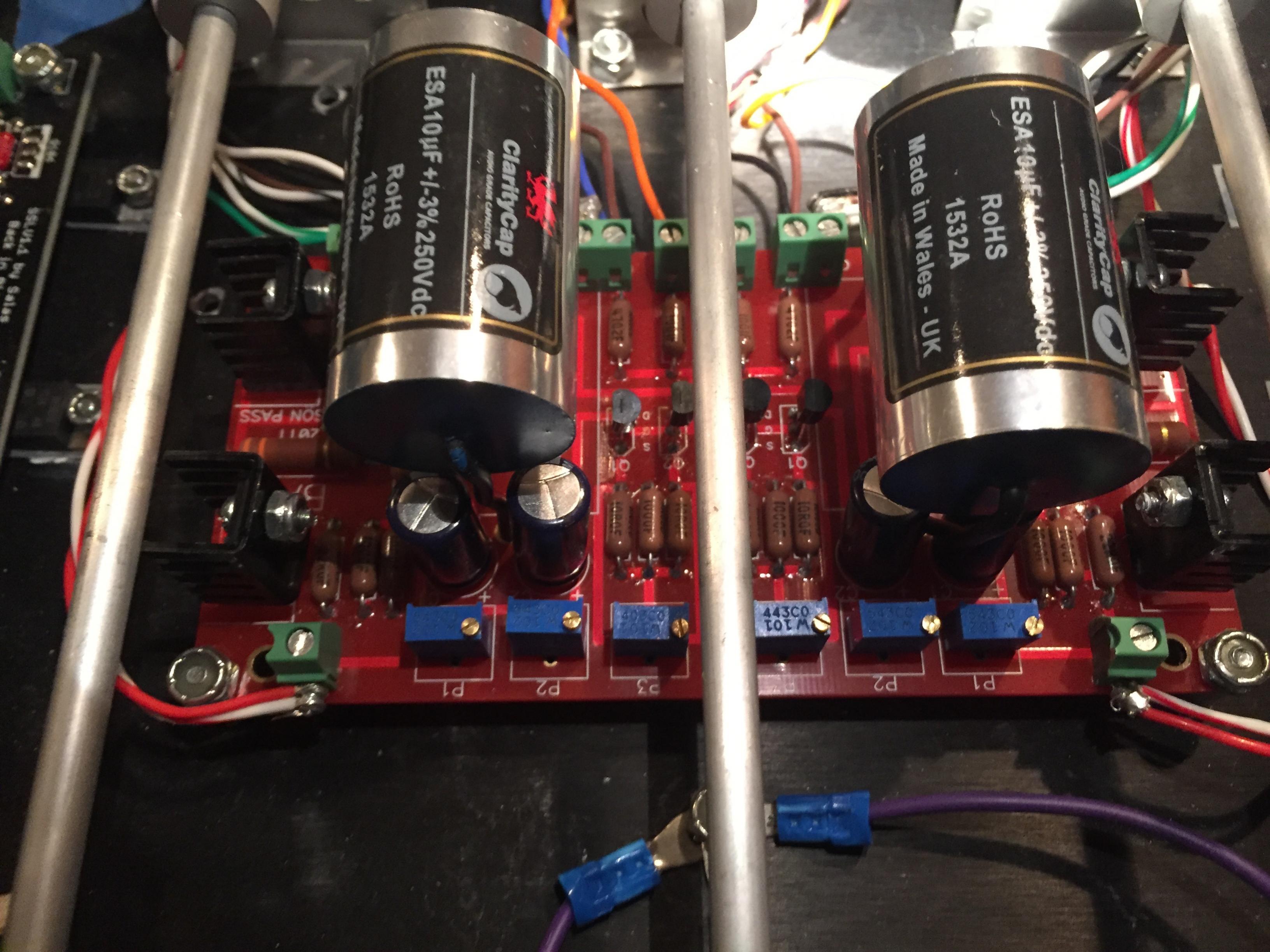

Alright Nash, despite a bit of anxiety over doing this, I pulled the output caps on the BA3-FE. I think it's a significant improvement from top to bottom. Everything seems to have a bit more clarity and texture...like a bit of haze was removed that I didn't know was there.
Of course before doing this I measured DC offset. I never realized how much and how continuously it drifts, but then I never had a instrument as sensitive as the Keithley 2015 to measure it with either. the best I can get is a swing between + and - 5mv.
So I removed the output caps on my BA3 preamp (was using elna silmic electrolitics) and after careful bias and dc offset adjustments I have less than 10mV offset in each channel.
Connected to my F4 amplifier (which has 2 capacitors which effectively block DC) I got a huge improvement in the sound quality.
I can notice more detail and a more airy sound with. Bass is a bit tighter too. Since I will only use it with my F4 I will keep it this way.
