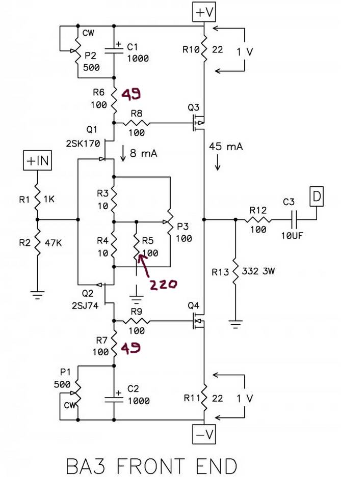

How much change in gain?
Back in post 711, Juma suggested changing the values of R5-R7 to lower the gain.
The image below shows the values he suggested.
Can someone please tell me how much the gain is reduced compared to the gain using the standard value resistors?
Thanks...
Thanks...

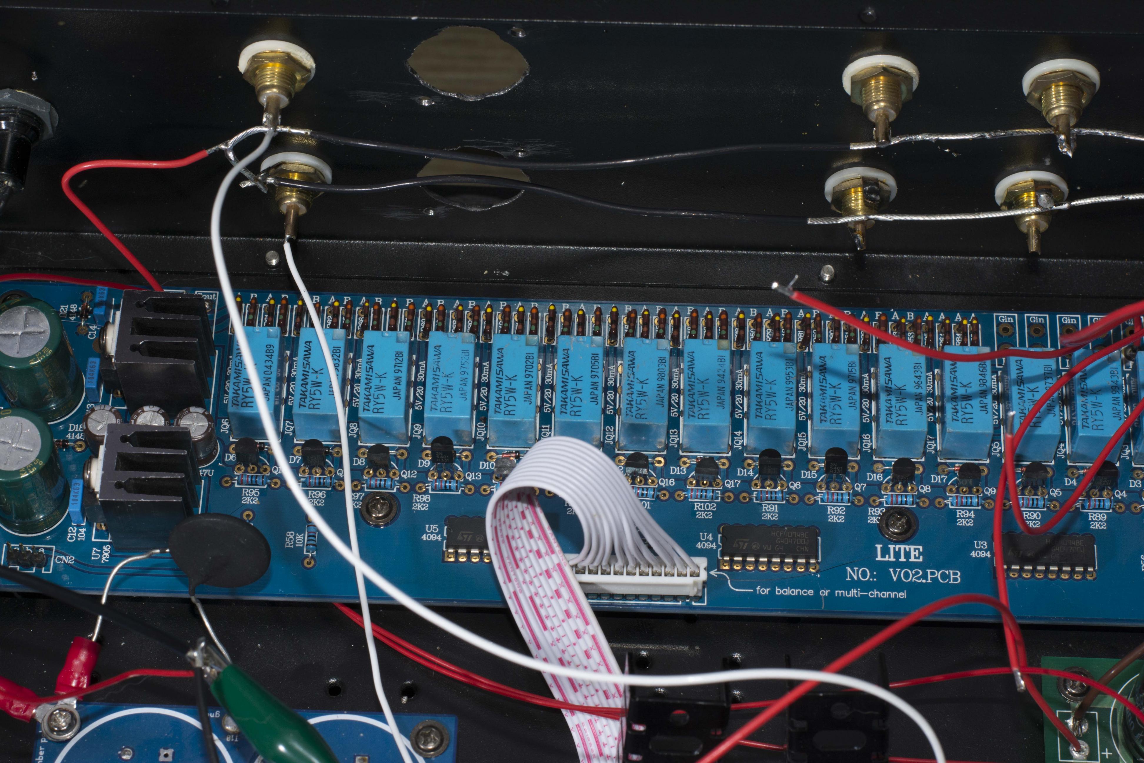

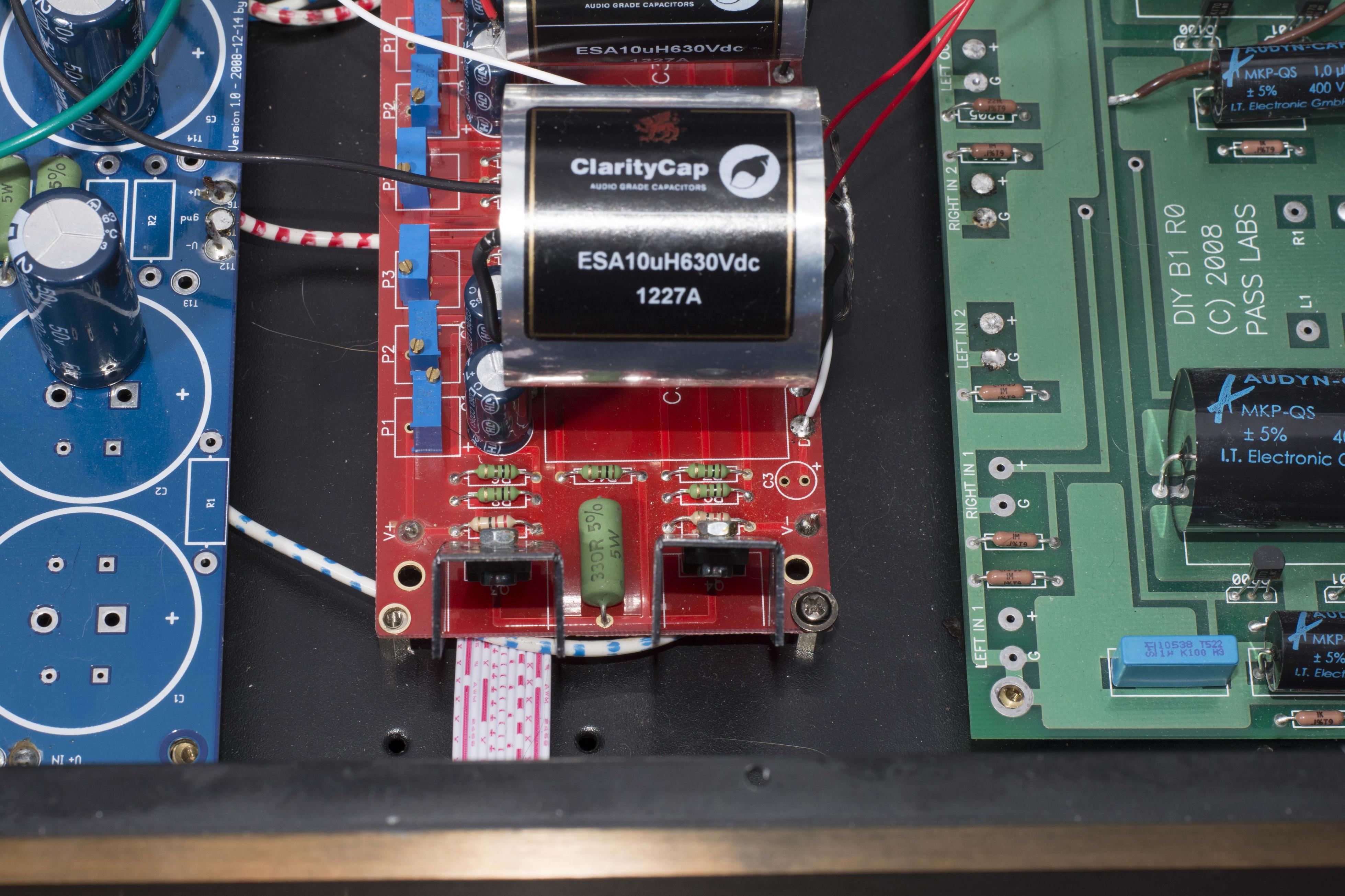

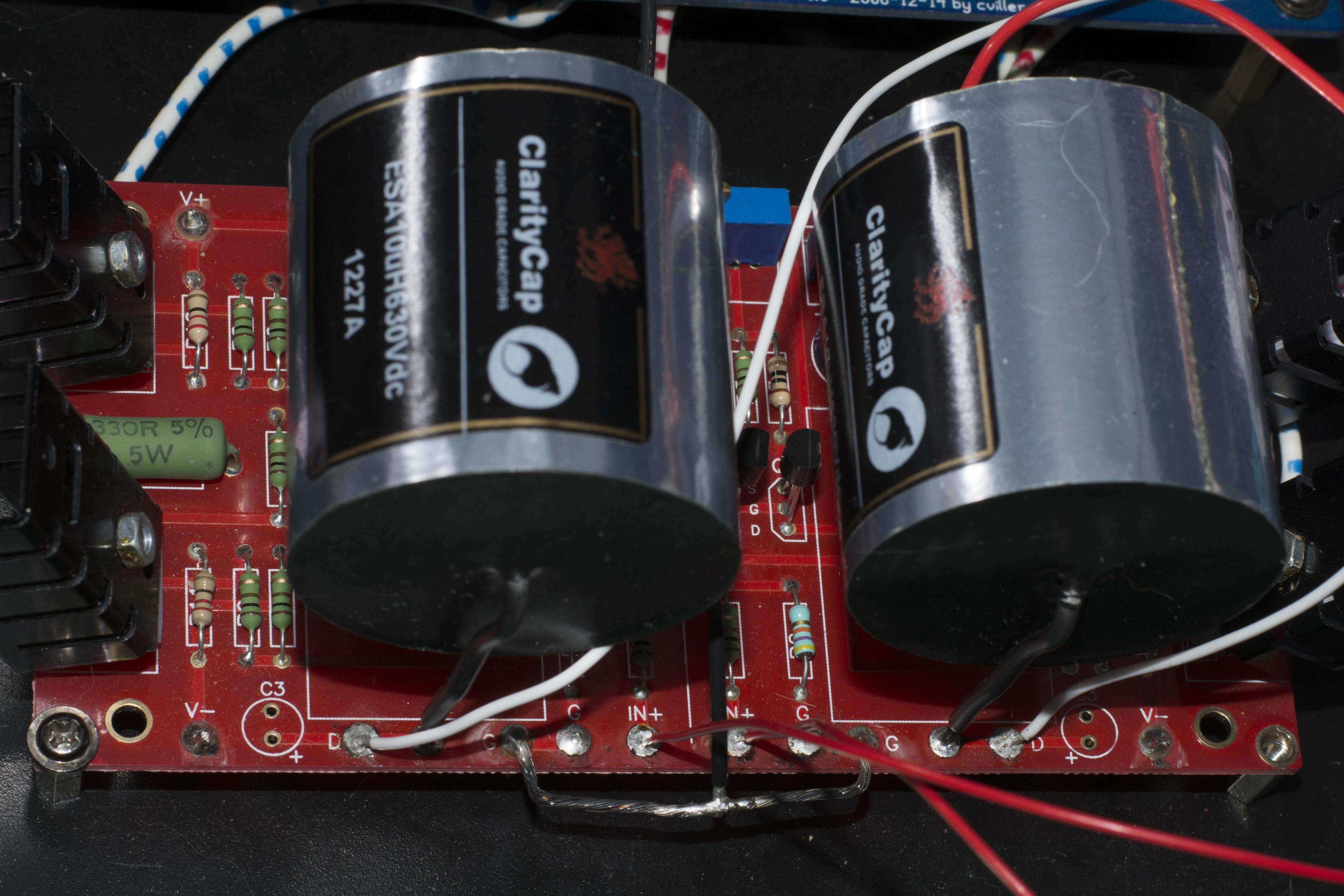

Hi All,
First of all, I rebuild my F5 to F5 turbo v2, but ran into a problem.
My F5 Turbo V2 is silent..... Speaker connected. although when my pre-amp is connected with the F5 it hums loud, there is also a little bit of sharpness in it.
My pre-amp is a BA-3 FE stage powered by a PSUboard v3 @24V. I made a star ground, and installed a relay volume control. Lite audio V02.
BA3 is biased at 1V over R10-R11 and about 20mV DC (measured before CAP and gnd) over R12 there is no DC. I can not figure out where this hum comes from. The interconnects do not interfere, cables only connected at the power-amp gives no hum. I think it's a Ground-loop triggered by the Pre-amp. today I did tried several things without any luck.
- re-solder internal wires and changed interconnects. still humming.
- disconnect interlinks, nu hum
- replace volumecontrol and connect interconnects. reconnect input and output to RCA socket.
- finally I re-solder the connections on the BA-3 beard (input and output).... No hum on left channel. But when powering up BA-3 the hum appears again.
The B1 was in and I used this one also to check whether there is a Hum.... And it was..
Since I was testing, I only connected the Main input and output. So try to look trough the Spagetti
Any of you Experts have an idea where to look?
All help is appreciated.
Nils

What are the noise measurements at the outputs?
Why have you got so many single wires inside?
Hi Andrew,
How to measure noise with DMM? And the thought for single wires was to use a star ground. Connect all RCA gnd to the star-gnd and signal to the input.
should I use shielded cable. Once read that CAT5 mono wire is a good internal connection. I use silver plated CU.
Nils
A DMM set to 199.9mVac measures hum+noise down to 0.1mVac.
Variations in that noise voltage tell you whether the most recent wiring modification is an improvement over what came before.
you may find that each modification only reduces the noise voltage by a few percent, but when all are combined you get a significant noise attenuation. You can also use the "it got worse" results to ensure you don't incorporate a bad modification.
If your DMM does not have a 199.9mVac scale, then go out and buy a cheap DMM that does have this facility.

did a short measurement,
output is fluctuating between 0,2 and 0,1 mV ac. Hope this is ok for starters.
What is the exact place for setting up the BA-3.
I did set 1 V dc over R10 and R11. And the offset measured before the Cap and Gnd
don't think the problem lies here because the hum is also present when there is no power on the system!
