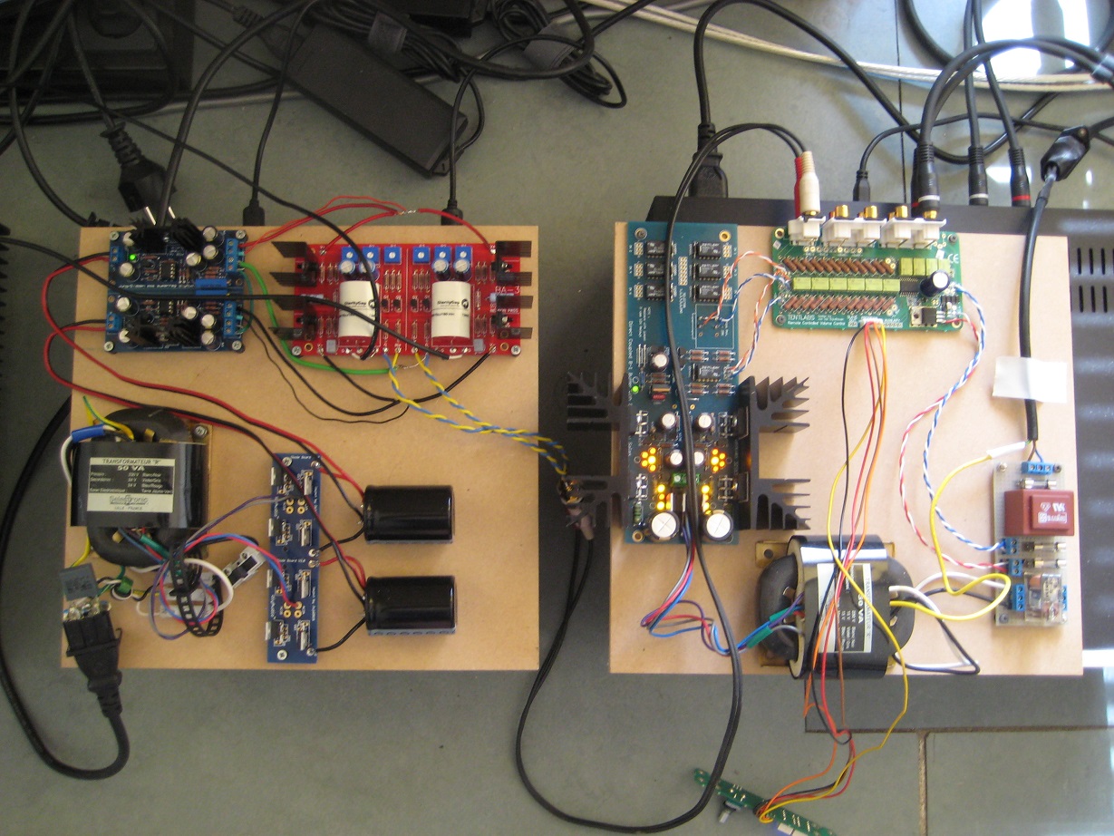

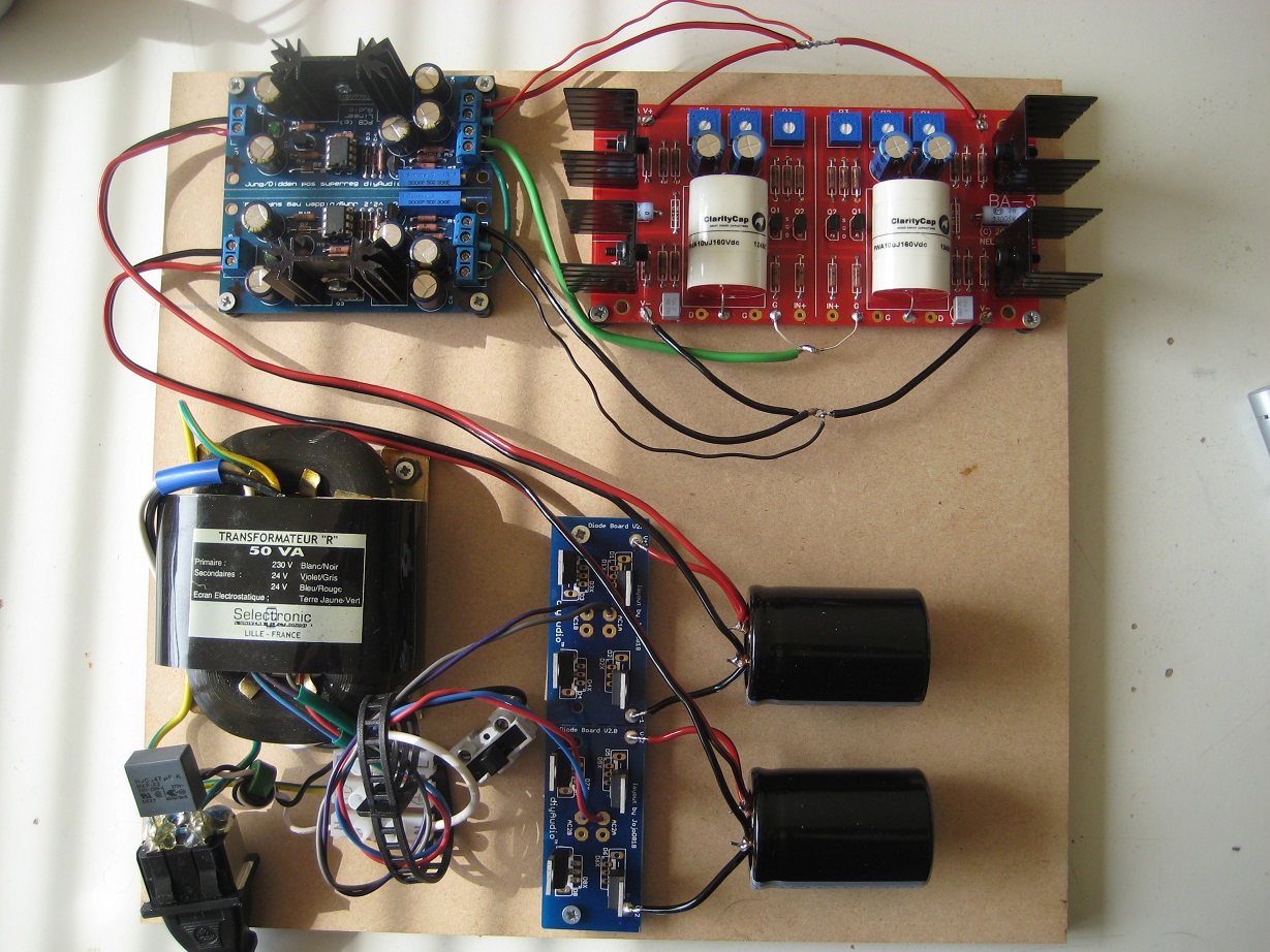

I have been busy.... finished my BA-3 as a preamp on wood and listening to it.
Now all must be put in a nice enclosure😀
Some things I noticed:
- the gain is about 20 - 23 dB and not 30 dB at 24.0V rails. Doesn't mind I wanted it lower.
- the adjustment is a bit 'different' then with F5, the P1 and P2 pots don't influence each other as much as they do in a F5. You can bias both halves more individually...
- with these additional gain I start hitting the noisefloor... with the chain DAC--volumecontrol--DCB-1---BA-3---AlephJ I can now hear al little noise coming from the tweeters with my ear against them😱
Maybe when they are in metal enclosure it will be a bit better.
- better use multi turn potmeters!
I already have an input selector at the volume control board, so I'm going to use the extra free input relais on the Mezmerize board for switching between outputs of DCB-1 and BA-3 and probably BAF2013 Pre from Juma.
For normal listening I don't need amplification out of my pre and I will use the DCB-1.
Questions:
Is it appropriate to increase the input resistor to ground of the BA-3 from 47K to 220K like DCB-1. So it matches better with my 23K output impedance volume control?
For signal wiring ZM advices twisted CU, as thin as possible, but solid core or stranded?
I removed the 100E at the output of the BA-3, can I now use the BA-3 as a headphone amp? Like to have that feature on my preamp😀
When I ever want to build the BA-3 PP output stages, is it smarter to have 32V rails so I can have more voltage swing?
Thanks!

BA3 it`s made to drive output stage to full swing, and 20 or 30dB for a line amp that`s too much . Too much gain to trow away with input pot.
9dB for line amp is ok in my book and you can lower the gain of the circuit with little experimenting and changing few resistor values, so you won`t have noise issues anymore.

It's in a post from Jan Didden how to adjust the Vout. Here in another thread post 174: http://www.diyaudio.com/forums/diyaudio-store/247281-super-regulator-18.html#post3807398
Be careful if you use AD825 it's 30V in max. AD 817 is 36V in max.
I did already remove the 100 Ohm cause it's not really necessary, just to make the BA-3 more foolproof 🙂
So I'm not doing anything with a switch. I haven't tried the headphone yet.
I'll let you know when I listened to it.
I know it's too much gain, I read the gain structure article😀
That's why I also want to build Juma's BAF2013 pre with 10dB gain and put it in my preamp too. And with the relays switch between the DCB-1, BA-3 or Juma's BAF2013🙂
Maybe when the VFET adventures are over, eventually build some real heavy BA-3 😀
