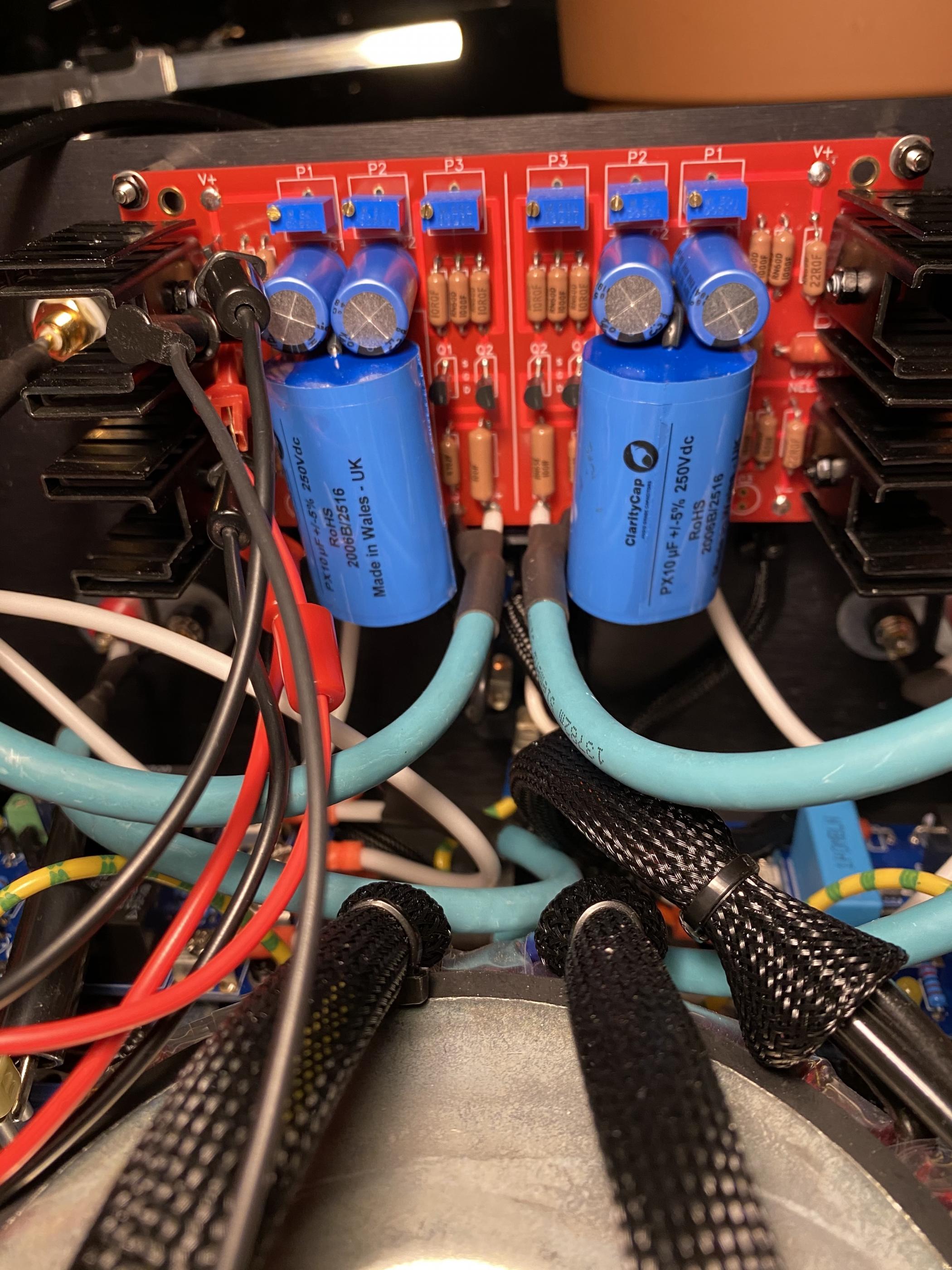

Could use some advice. I'm worried I did a dumb.
I am building balanced complementary BA3 monoblocks.
I started to bias the FE on one of them last night. Started with variac and everything looked good so went to up to 0.75v slowly. I actually have a BUNCH of DMMs so I was doing both channels (or in the case of balanced: phases) at the same time.
I noticed that as soon as I got offset to 0 on one phase, the other would go up. I was puzzled so I read the balanced BA3 thread more, and did a search and found out that you actually need to bias the FE in the nominal SE/unbalanced configuration (R5s @ 100ohm going to ground instead of both R5s connected to each other @ 2x100ohm). No problem, I un-bridged R5 and put them back to ground.
Now I am trying to bias them after this change, but when I power up with variac, if I get to full mains (120v) I am see 60+ VDC across R10 and R11. I'm an idiot and I forgot to dial P1 and P2 back to zero before re-attempting bias with the new configuration. Upon noticing the high VDC I immediately powered off, and turned P1 and P2 back to zero. But still, when I power up with variac I am seeing WAY too much VDC on R10 and R11 even before full mains. And when I turn P1 and P2 I don't see it having ANY affect on VDC AT ALL.
I didn't see/smell any magic smoke. No blown fuses. I rechecked PSU output and it's nominal 32v. I don't see anything toasted either.
Does anyone have any advice? Did I fry my Q3 & Q4s?

You can ignore my previous post. I just realized i had my DMM probes mis-matched so I had R12/R10/R11 probes not going to the correct DMMs. I fixed that and now everything is perfect and I can hit zero offset and am following nominal biasing process.
Sorry for the false alarm and noise!

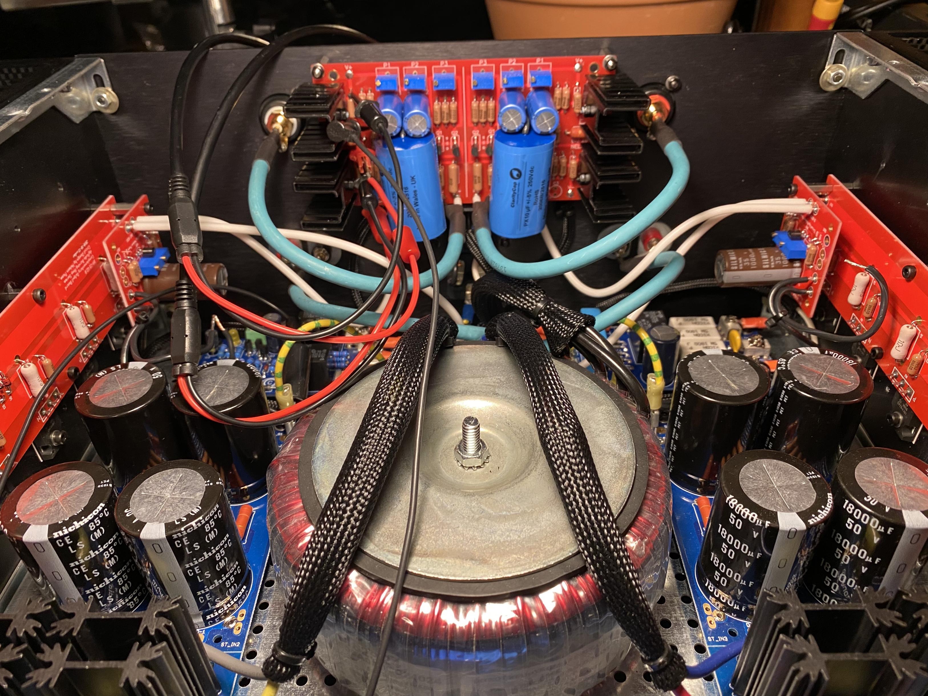

Power supply for BA-3
Hi all,
So I've got the BA-3 almost right where I want it, and it sounds great. My only problem now is (hopefully) a simple one. But, as a novice in this world, I think I still need a little help from the group. I'm using a Hammond 600VA toroid with dual 24v secondaries and the DIYaudiostore PSU v3.0 built almost exactly as per the 6L6 build guide. With line voltage at 120, the rails are +/- 36.5v. Taking heed of the warning about destroying the JFETs on the front end board, I'm running the amp at 111vac through my variac, which results in exactly 32vdc rails.
Can someone please offer some guidance for how best to deal with this issue? My intuition tells me to increase the resistance value of the 3 watt resistors on the PSU board (I'm using 0.47ohm), but I'm not sure by how much, and whether that will be effective. Any help would be greatly appreciated. Thanks, all.
