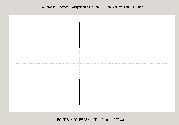

Less the volume occupied by driver and port, the net volume is closer to 5.3 cubic foot, around the volume of this sim for a B&C18SW115.Dimensions (Transport): 28" (H) x 19" (W) x 23" (D)

Or use a B&C15TBW100, at 95 volts (about 1077 watts at the impedance minima) reaches over 125dB at Xvar of 13.5mm in 158 liters (about 5.6 cubic feet).
If your 3kw rack amp can't swing 95 volts at 8 ohms, you could go for the B&C15TBW100-4(ohm) version.
