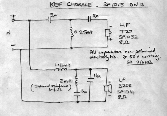

FYI, the KEF Chorale crossover had a 6.4 ohm resistance built into the shunt LC in the bass section and thus was not too deep a notch.
It was designed to correct a certain wonkiness in bextrene cones.
You could use a regular coil and add 5-6 ohms.

That's a 3 kHz crossover so I think your Vifa D19 TD 3/4" polydome substitute will be fine.
It's very like the SEAS 19TFF in construction and behaviour and around 88dB I'd guess..
I would use 4.7uF and 15uF and 1mH and 2mH here for ease of purchase.
You might want to add a little attenuation with ceramic 3W 2.2R or so in front of the tweeter section.

Thanks Steve - I was hoping you'd come in on this. I used the D19 on your recommendation, but anyway I have it in my Mission 761s and like the crisp and clean highs. It was a very popular tweeter choice for the era and for good reason.This is a trip down memory lane! That's a 3 kHz crossover so I think your Vifa D19 TD 3/4" polydome substitute will be fine.
It's very like the SEAS 19TFF in construction and behaviour and around 88dB I'd guess.. I would use 4.7uF and 15uF and 1mH and 2mH here for ease of purchase. You might want to add a little attenuation with ceramic 3W 2.2R or so in front of the tweeter section. Best Regards, Steve in Portsmouth UK.
