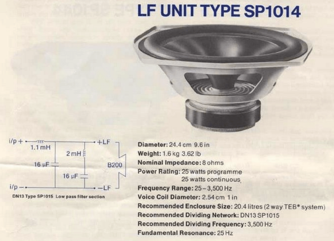

I have coming a pair of Kef B200, and a pair of Vifa D19TD which was suggested as a T27 substitute on this forum. I like it and it's used in my Mission 761 speakers. Similar 19mm poly dome.
What would you suggest as a crossover for a 2-way in a sealed cabinet? Typical X-over frequency is 3.5K
B200 SP1014 + T27 were used in Cantor(1971), Chorale(1970), KEFKIT1(1974), Monitor Audio MA4, Linn Index Mk1, Tangent TM1, 2, 3
Chorale crossover was SP1015 or SP1016
SP1014 – constructors, small magnet, Chorale
SP1022 – Qts .41, large magnet
SP1039 – med. Q, large magnet 104, 104aB, Monitor Audio MA4, 103 Ref. Best
SP1054 – Qts .23
SP1063 – med. Q, small magnet
SP1047 (1974) Used in: KEFKIT 1(1974)
SP1054 1976 Used in: Calinda(1976)
SP1063 1976 Used in: Caprice(1977), Corelli(1976), C40(1979), C65(1979)

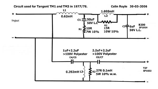

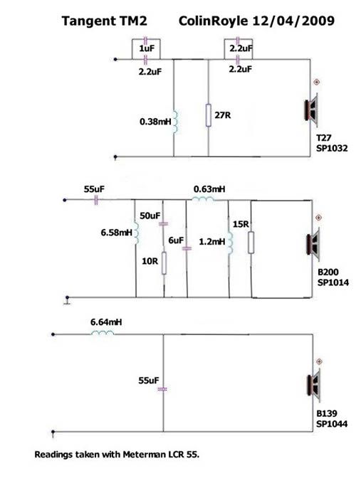

Attached Monitor Audio MA5, Tangent TM1 and TM2

Hard to see the B200 reaching up to the D19.
The biggest failing of the Tangents (the best of the B200/T27 i ever heard) was in the upper range of the B200.
i would not `XO it higher than something like 2.5kHz.
And i do have issues with the data KEF provides to model a proper box. By that the box wants to be considerably larger than any that came to market (i have 16 x B200 SP1014, cost almost nothing).

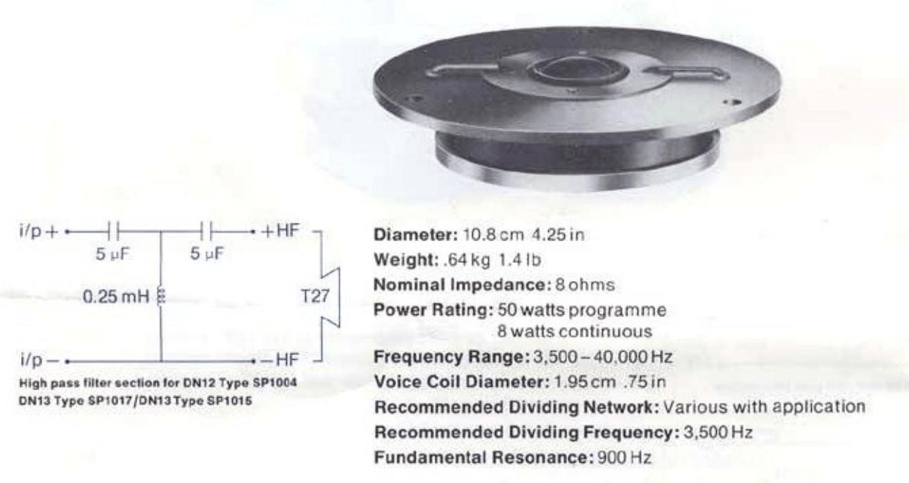

Hello Dave. Indeed, the crossover frequency needs some thought. Here's the D19 data and T27 data
https://cdn.shopify.com/s/files/1/0809/2387/files/D19TD05-08.pdf?1883630718988819778
http://nedlab.com/wp/wp-content/uploads/2014/06/KEF-T27-SP1032.pdf
Fs of T27 is lower at 900Hz than D19 at 1.7K. The D19 was crossed over around 3.1K in the Mission 700LE but 4.2K in the later 761 model.

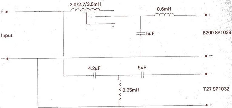

I think it should work in a reasonable fashion, but I am not 100% convinced it would give you a T27 and DN 12 crossover response of the kef original design.
It might be sensible to stick 1 ohm at the input and try 3.3uF as the first capacitor instead of the 5.6uF shown in post 6. If not quite correct then try without the 1ohm and if that still leaves a perceived gap increase to 4.7uf or 5.6uf as per the diagram.
As you know and understand measurement would make it somewhat easier to get right.
