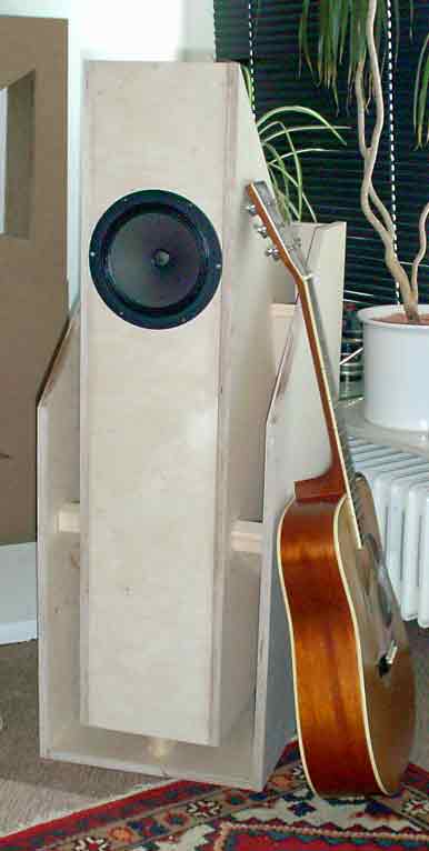

Hello,
the relation of reso and Qts is not working
in a single B 200 basshorn.
I test the B200 in serveral constructions,
in my sats:
Trumpet, Schalmei, Horn the B200 work very well,
no double cone makes it to a superb classic driver,
nothing over 12 kHz normally no problem.
The single simu of the double horn:
Saxophon and RDH20
shows worse simus in relation to Fostex, Sica ...
but it works, by membran movement interlacing,
see last measurement of RDH20.
A single B200 bass horn won´t work good.
