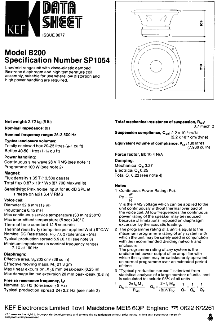

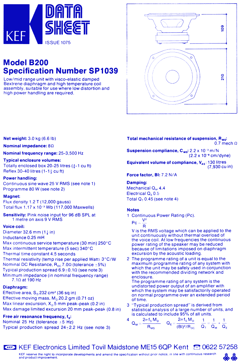

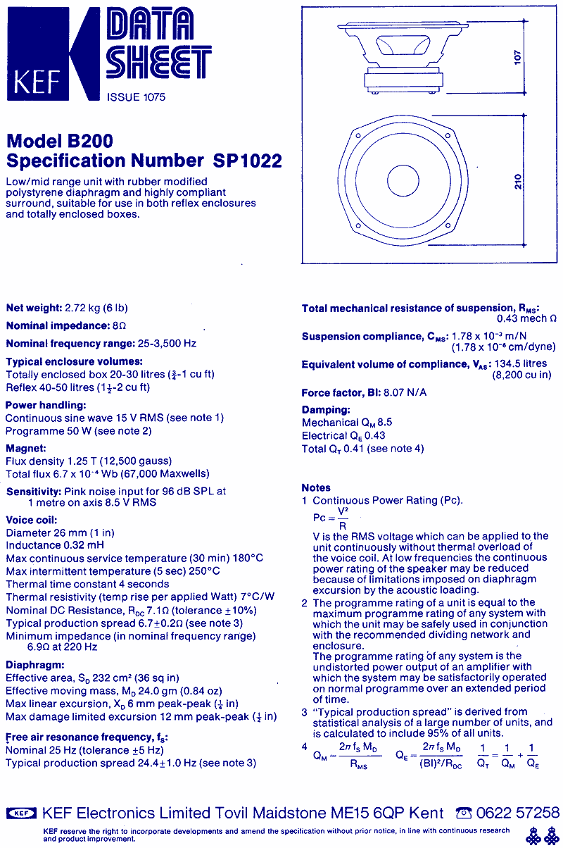

b200 versions
the Qt values vary from 0.23 to 0.51
Some must be more suitable than others.
Depends on what you mean by 'more suitable'.
For a given horn Fp and all other driver specs equal, then the lower its Qes, the wider its LF rising response (point source) BW, ergo the longer its axial path-length, the smaller its filter chamber, throat and mouth area, so at a glance one would assume that the lowest Qes driver is the 'no-brainer' choice.
The reality though is that the longer the horn, the greater its delay WRT the driver's output, so depending on who you ask, the horn's HF corner frequency needs to be between ~250 - 400 Hz before their comb filtering begins to audibly 'smear' its sound-staging, imaging (loss of clarity).
Since only Fs, Qes is required to define this acoustic XO point (2*Fs/Qes), then assuming all these have a ~25 Hz Fs, the driver's Qes range is ~0.408 - 0.255 respectively after all series resistance has been accounted for.
