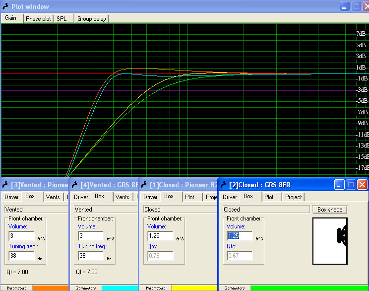

Here you go. It certainly sounds less robust... the GRS does not have the same balls as the B20 but at this point i think we need to evaluate it on its own merits since the other driver was discontinued... The GRS is an 'ok' driver. I've been listening to it all day in good sealed boxes. It's -3 at 70hz according to the sim... the B20 was -3 at 60hz so we lose an octave. It sounds like it's missing its bottom. I will have to model a BIB. In a ported box it also shows a weaker bass response so this really is not a 'direct' replacement as claimed. It sounds a bit strained at higher volume too. But it sounds nice in an intimate setup and the mids are clear and strong. It's musical thru the mids but nowhere else lol... it sounds like a budget driver to me and should be considered as such. If i was blindfolded i'd guess it was a 5" driver.
Perhaps a bit of an aggressive sound. Unless it warms up i doubt i will pursue this driver much. But that doesn't mean others should not give it a try. It's an extended range driver that sounds a bit thin to me and has an uneven upper midrange and treble... to my ears anyway.
