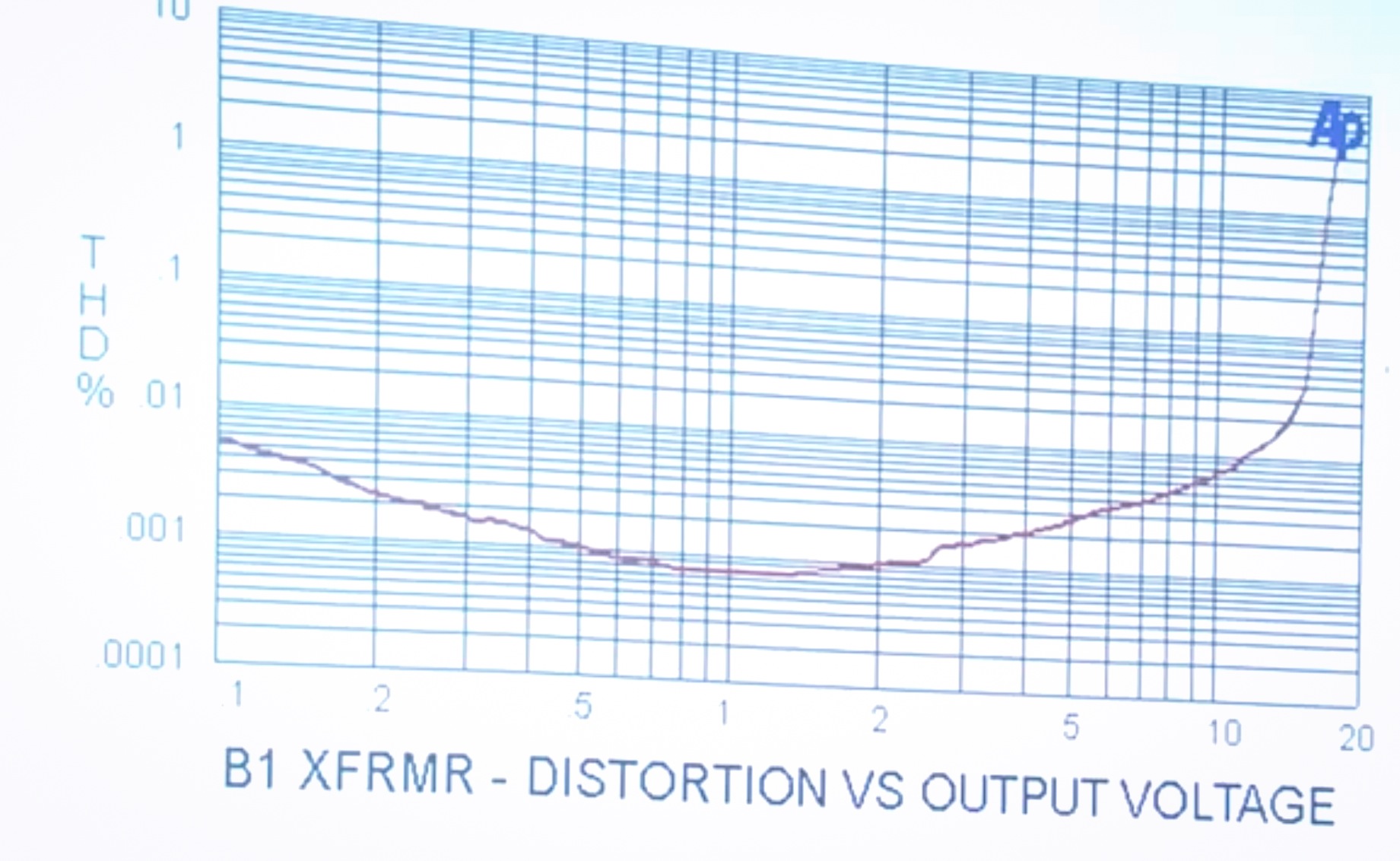

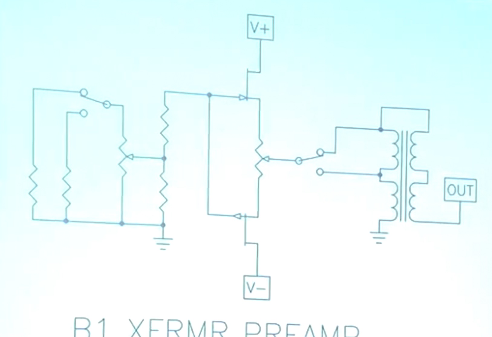

Can we start a dialog on the B1 Xformer preamp? Does it fall under some other existing/similar design, so it's not being discussed?
From BAF 2017.

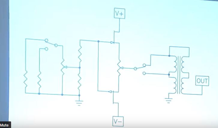

From BAF 2017.

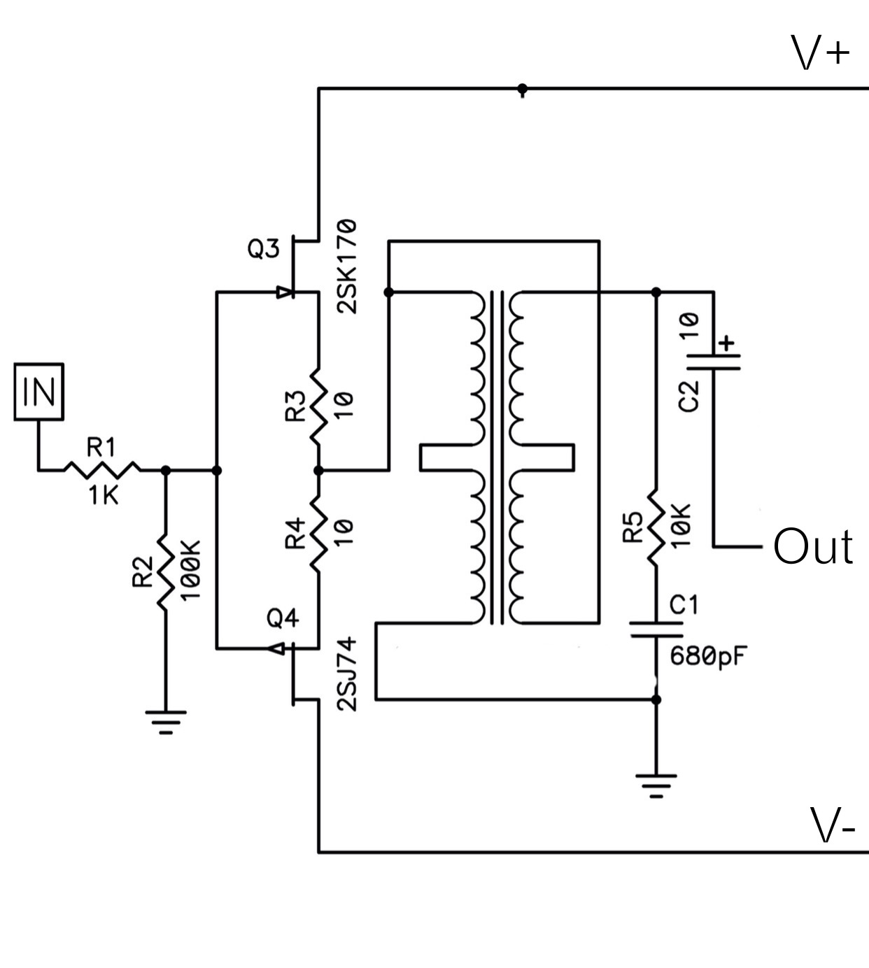

The switch selects between 6 or 12dB gain. If I want a 3 step switch and the 3. position to be 0dB, then all the transformers windings in series will be parallel with the output...will this be a problem for B1?
PSU have V(-) , GRD and V(+) high probability buffer are similar to this one..
Two first B1 Xformer resistors around the switch are 1M Ohm's.
After the switch log volume potentiometer of 50K maybe..

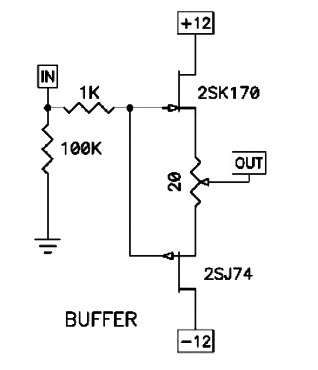

Schematic source : Passworks

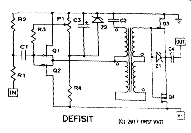

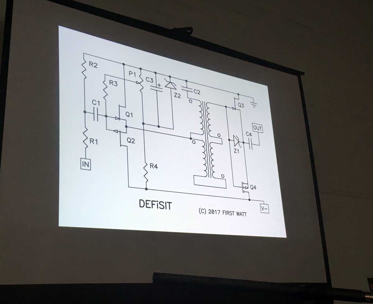

Or something similar to M2 buffer.btw is nice low distortion preamp. Schematic source : First Watt
