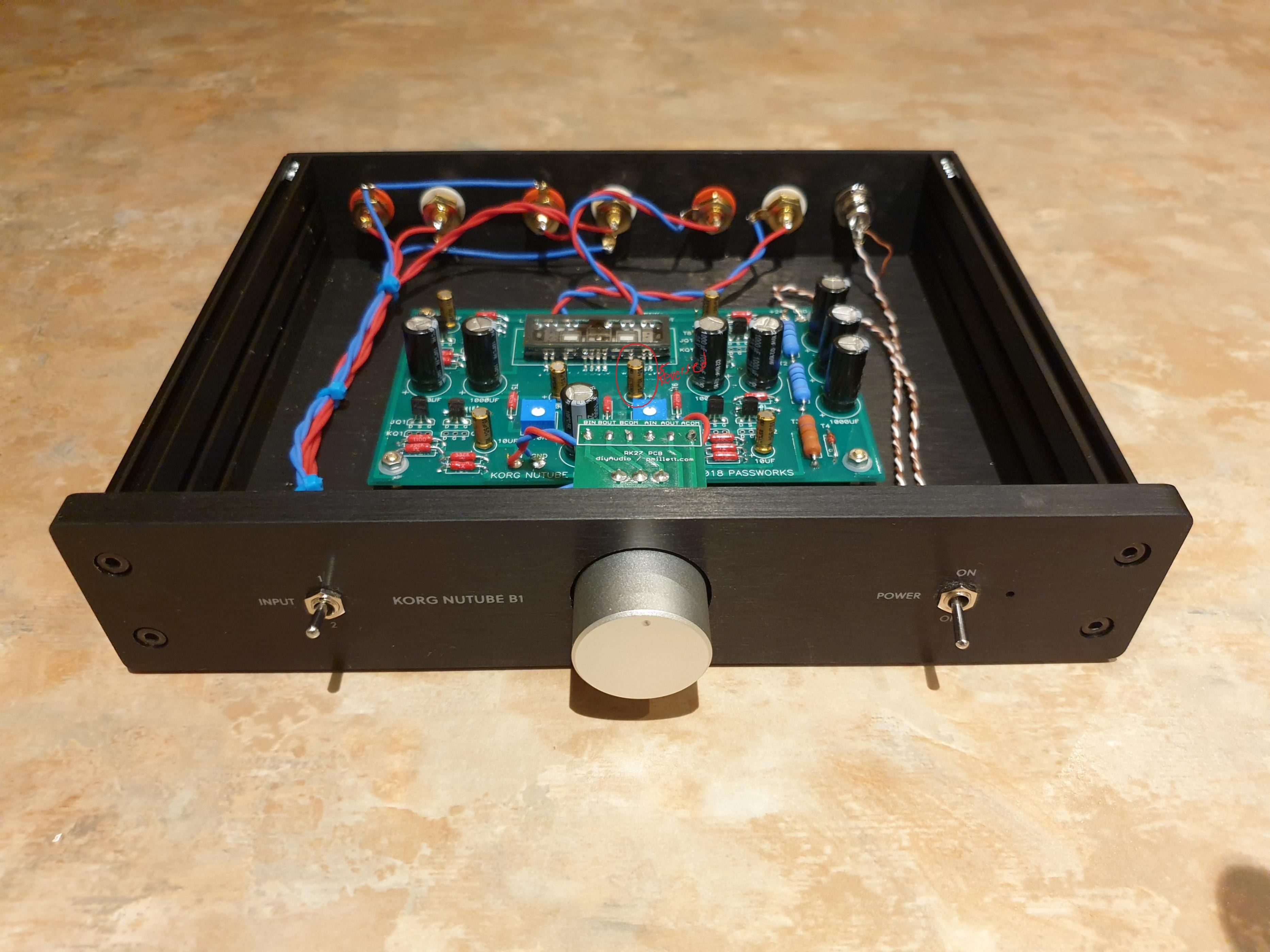

Rich,
Congratulations on another successful build. Neat work!
Also good to know that the Aleph J is rocking it with this preamp even with the lowish sensitivity LS50s.
6L6 never runs out of helpful advice for the DIY community. As our Australian friends would say "The man is a bloody legend". 😀
Can you point me to the post discussing the masking tape technique or elaborate a bit? I am currently working on a Wayne BA 2018 preamp, but have the Nutube B1 preamp parts and would like to give it a shot some time.
And you enjoy the music!
I followed 6L6’s instructions on using double-plyed masking tape to serve as a temporary spacer when soldering in the Korg Nutube triode. Absolutely no problems with microphony—so I would definitely recommend this assembly technique.

Rich - nice build! Looks great.Is that a PEC pot? What values did you use for the coupling capacitors?
Aleph J can run any low-impedance load you can throw at it, AJ just happily chugs along. 😀
Thanks.
The volume pot is a 50k audio taper Cosmos Tocos pot that ClaudeG recommends.
“COSMOS TOCOS Potentiometer RV24YG 20S 15A503 x2 A50kΩx2 A50K 50K 24mm Japan”
Input signal caps: .22uF/400V Panasonic ECQP PP film/foil
Middle signal caps: 2uF/250V Axon True Cap metallized PP film
Output signal caps: 4.7uF/50V Black Gate N non-polar electrolytic
I finally found a use for these Black Gate N caps I bought several years ago from Sonic Craft when Black Gate caps were phasing out. Both measured at 4.47 uF and 4.48 uF using my LCR meter.

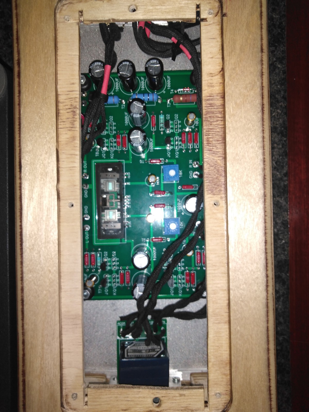

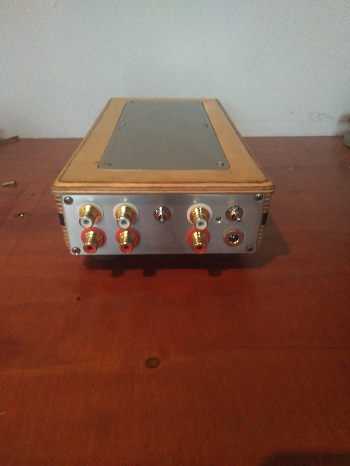

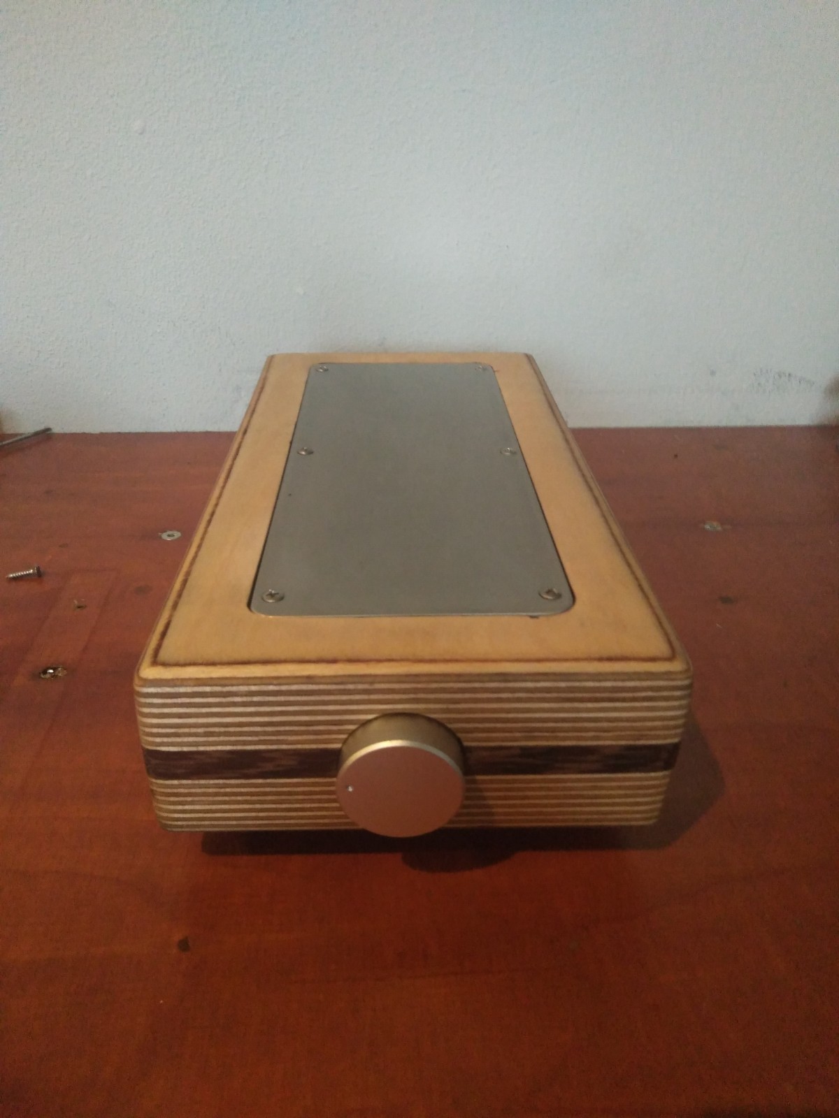

r1Hello,
thought I'd share my take on the B1 w Korg. Standard build with homemade enclosure, internal wiring is Duelund DCA.
Setup: Wadia 121 into the B1, Parasound A23 amp, KEF LS50 speakers and a homemade sub.
My opinion: blown away. Transparency, micro detail, placement/soundstage all took a big step. There's something very inviting and RIGHT about the sound now, and and and, well, I guess y'all know what I mean. Here's a very big, heartfelt Thank You to `Mr. Pass!
I like it so much, I have decided to build another (for reasons I really want 4 channel volume control, so I'll build a dual-stereo pre-amp), but with upgraded parts. Be fun to see if I hear a difference. Some searching trough here will probably put me on the right track, but if somebody already has a BOM of upgraded parts, yes please.

Very nice wood enclosure Vomisa. Looking forward to your next B1 Nutube project.
This preamp is very musical and engaging. The Duelund DCA wire is a nice touch. I used the DCA20GA wire myself. I used it in my other Pass DIY amps: the Sony VFET amp and the Aleph J I completed last month. Everything plays well together, and it comes down to whether I want to listen to a complementary Class A amp or a single ended Class A amp. Tough choices, I know.

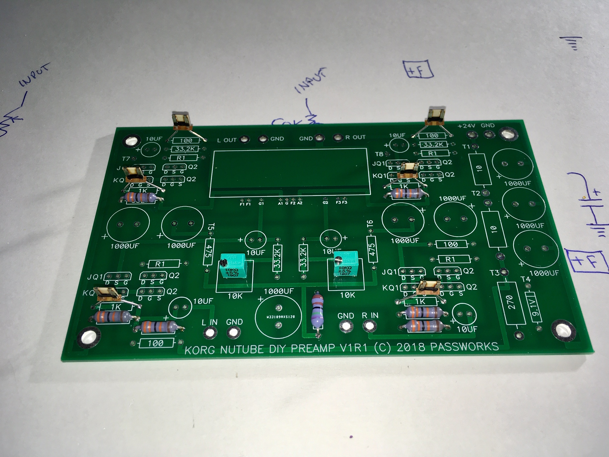

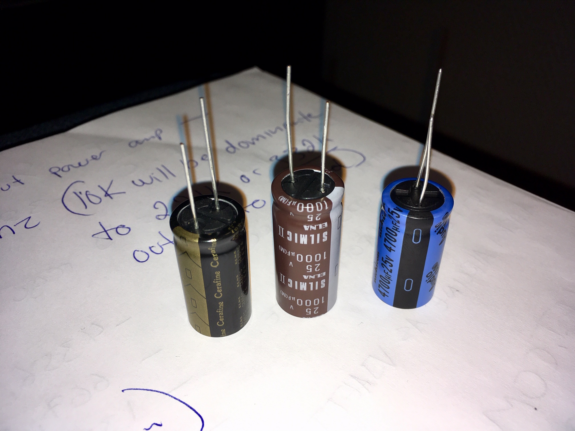

Hi, I have started solder in some parts.
How do you got yours 1000uF 25V caps soldered and close to PCB? The hole on print is 10mm center center. the caps 12-12,5mm.
How you like the Nichicon KA? I know some dont want to use 105 celcius parts.
Thanks for the cold solder tips a week or two ago. Had a chance to sit down for a few hours today, fix those solders, test PSU (check!) and stuff/solder the rest of the board and "floated" Korg tube (tip - slice the tube packing material thin for a shim)! Solders look good - just like those in the Sixties YouTube training video recommended! Damn power diode is still not functioning so not sure what's up there. But making headway. Appreciate you all for the help. Sneak preview - what I'm using to isolate the board is novel and yet to be reported but looks promising!
