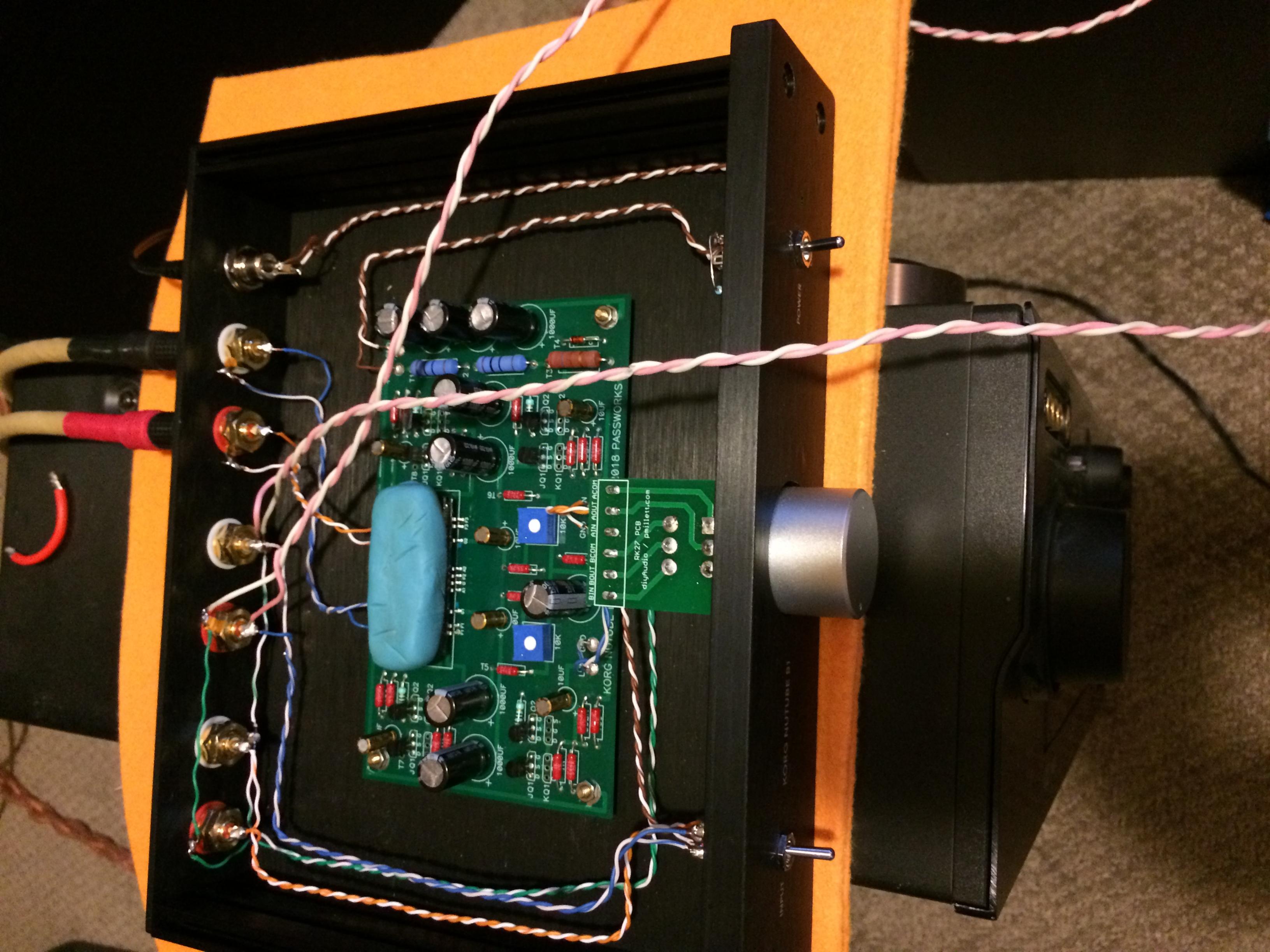

PCB in left channel 1.7 ohms full counter clockwise; 48.7k ohms full clockwise
PCB right channel 0.6 ohms full counter clockwise; 49.4k ohms full clockwise.
RCA ground/hot:
input 2 white 48.9k ohms; red 49.4k ohms (fixed)
input 1 no reading white or red.
Need to reflow solder at barrel and tab input 1?
Thank you
Craig
everything sounds logical, so input and pot are correctly wired

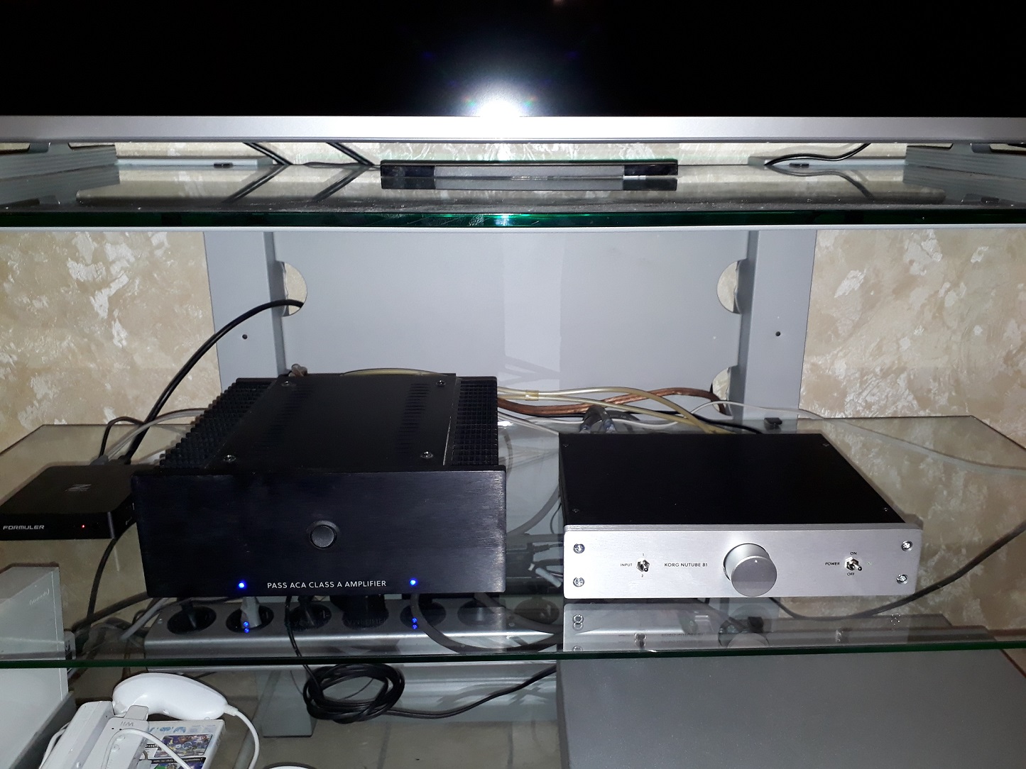

Hello all
So even having a miserable electronics understanding type i have yet managed to build the B1 and it's working!
Now i am very happy with ACA and B1, right now Jazz is a pleasure to listen to
Thank you all, thank you Mr Nelson!
Without all the knowledge, effort and information you all share here i would never get the nerves to attempt these builds!
My sincere gratitude.
.... now i have to take a deep breath and look at the F5 build

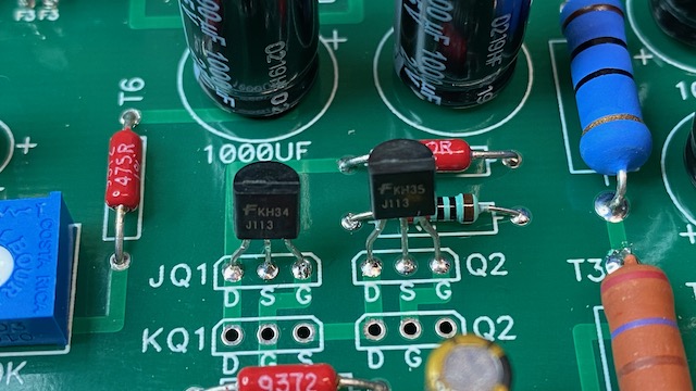

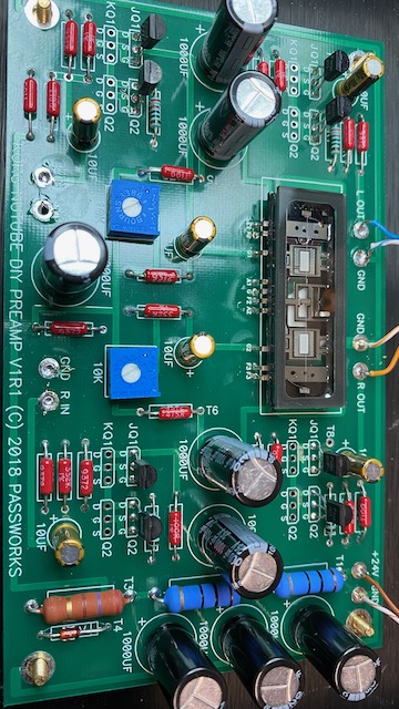

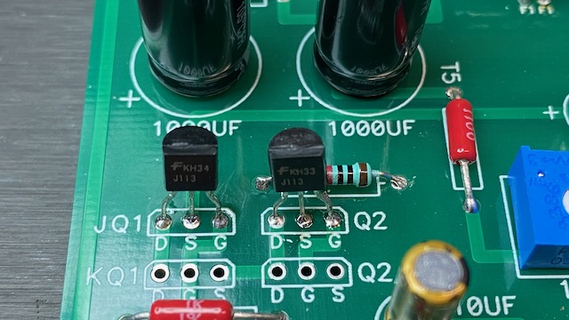

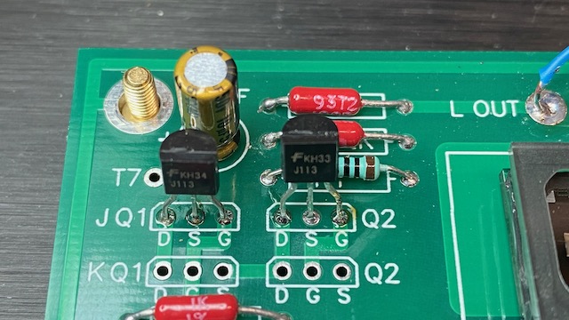

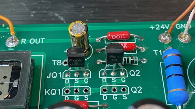

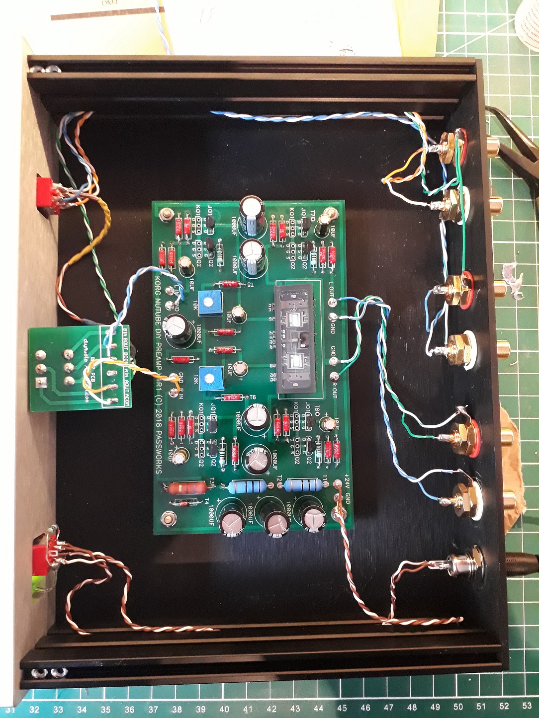

Voltage issues T7 and T8
I have completed my build but have been unable to get the correct voltages out of test point 7 and 8
T7 and T8 are around 20 volts and I can adjust T8 to 10 volts and T7 to 19 volts
I notices the JFET from Q1 and Q2 are FKH23 J113, FKH34 J113 FKH35 J113 and FKH33 J113 and wonder if they are installed correctly.
I am pretty sure I kept the bags separated. See attached image for installation. any help would be appreciated

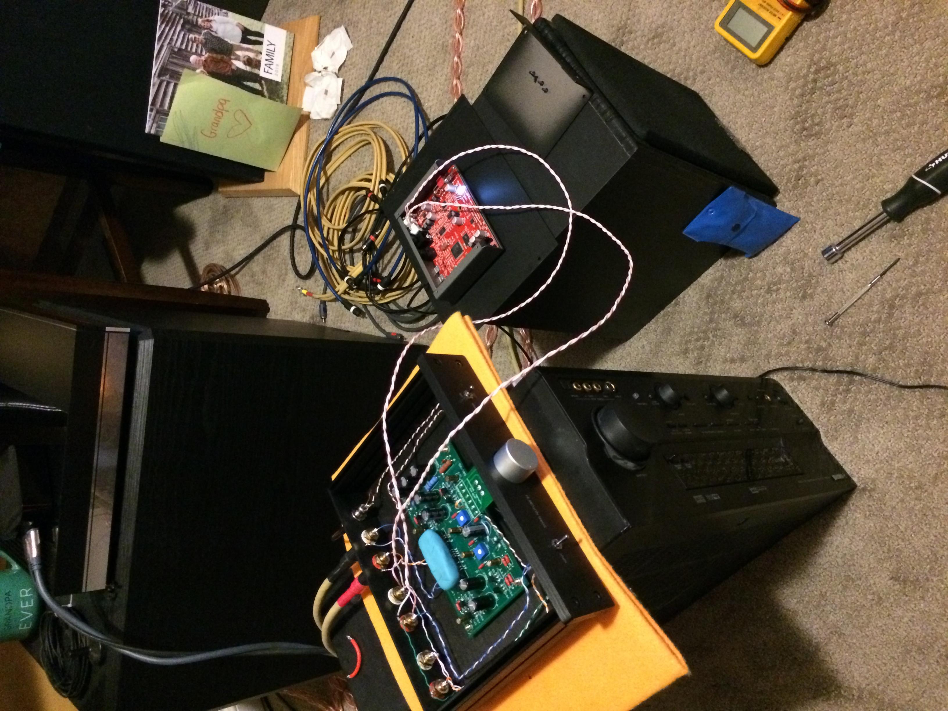

Build photos
Sorry forgot to show photos earlier, looks much like everyone else’s.
You can see where i wired my Schiit Modi DAC direct for the time being. Also you might be able to see my power supply on an extension cord. The ps was causing a rapid ticking through the system so I found a quiet supply elsewhere in the room.
Still hoping someone can shed some light on the reading commented on in an earlier post. Thanks in advance.
