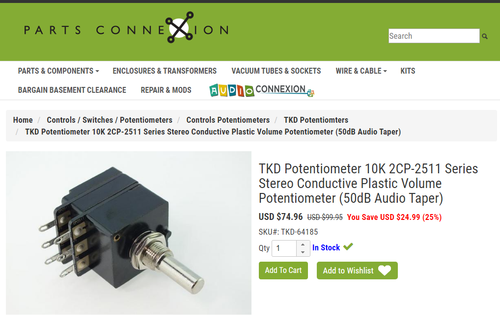

TKD potentiometers are on sale today at parts-connexion dot com, for USD 25 below the everyday price.

Good deal, but not for me in belgium when adding shipping and customs, 75$ becomes 115€. Hificollective (110€ shipped) seems to be the best place to get them in europe, better order before brexit :) to avoid customs. Any suggestions for buying it in europe?
Its a bummer that I have to buy a 110€ potentiometer for the b1 korg, that is half the cost of the entire preamp. The Alps RK27 cost me 32€, so not cheap too.
