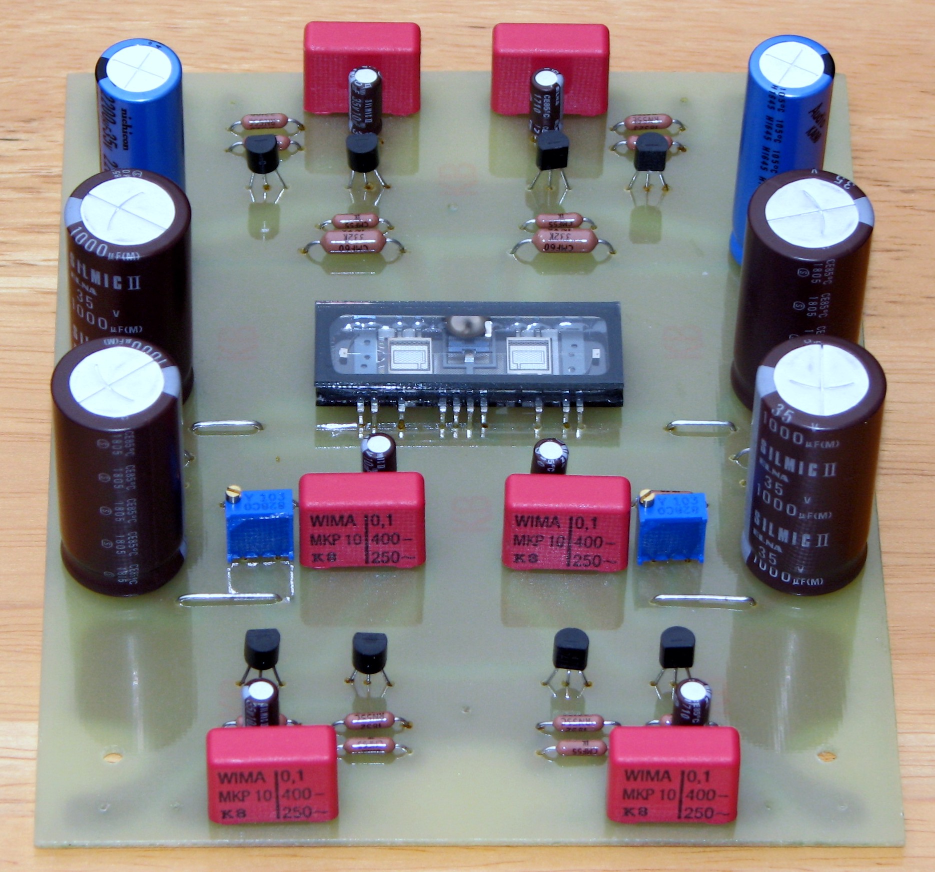

I asked Pete Millett this too. His response was:
If you to want use the JFETs instead of the bipolars in the buffer board to change drain resistors to 10K from 1 K
and add a 1K resistor in series with the gates to prevent oscillation.
Also as Nelson Pass has pointed out in previous posts you need to turn the JFET device around ie not matching the silkscreen since the source and drain leads are reversed compared to the bipolars.
I did it this way and it sounds fine.
I was just working on this today, and I'm swapping out some of the other components for the NP values, looking for something that might be able to match his gain and distortion results. If you look at the schematics side-by-side, the changes needed are apparent, and are relatively few in number. (Get some 221k resistors, always a good thing to have on hand for Nelson's projects.)
Chul is also doing this, and has posted (including some pics) in this thread.
I made the board myself, the old-fashioned way :)
