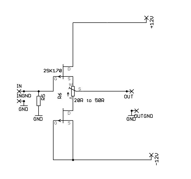

I dont know why i got an idea to add 50ohm trimpot on my dcb1 xo output buffer (copying B1 rev2 for P102), where I'm using 2SK170 source follower 🙁 maybe i just read somewhere that upper jfet can be selected from higher Idss to get null dc offset. Currently i use 9.7mA for upper jfet and 9.5mA on lower one.

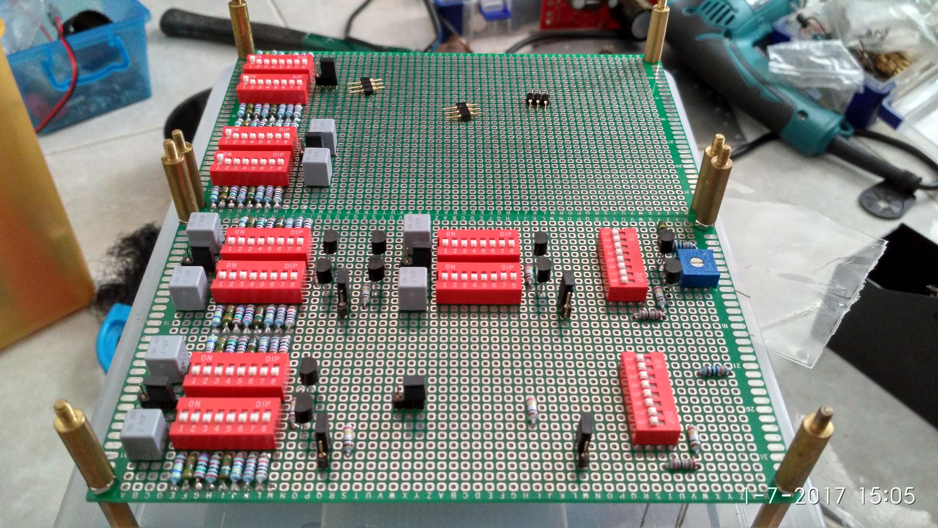

it's not powered yet, maybe less than 40% completed. I will test first 12dB filter than add second 12dB if required, at least the layout has spare space.
is this workable? or should i take out the trimpot?

exact schematic of buffer ,please
I'm using one of posted schematic in B1 active xo thread (which seems get less interest) as my basic reference, but I try to incorporate with B4 feature (dip 8 switch for cut off freq and output attenuator, 6/12dB and bypass jumper).
my output buffer is exactly as attached file, with additional 50ohm trimpot before 330R output resistor
using B1 rev2 for my buffer based on original B4 will be quite expensive, so i'm trying to be creative

what I sketched is , say , strict schematic for output buffer section , where each mV of output offset is important ; in any other position in your xover schematic , you don't need that trimpot , because dc offset is anyway blocked with capacitors
1M on output - it's not mandatory , but you can put it if you want
I'll not repeat myself about "importance" of series output resistor - that's idiotproof part , not having much with cable capacitance issues, as some ppl are involving ..... in fact , I wouldn't use it in that case , especially
also - output current is , anyway , limited by nature of part itself , so no current limiting safety issues
