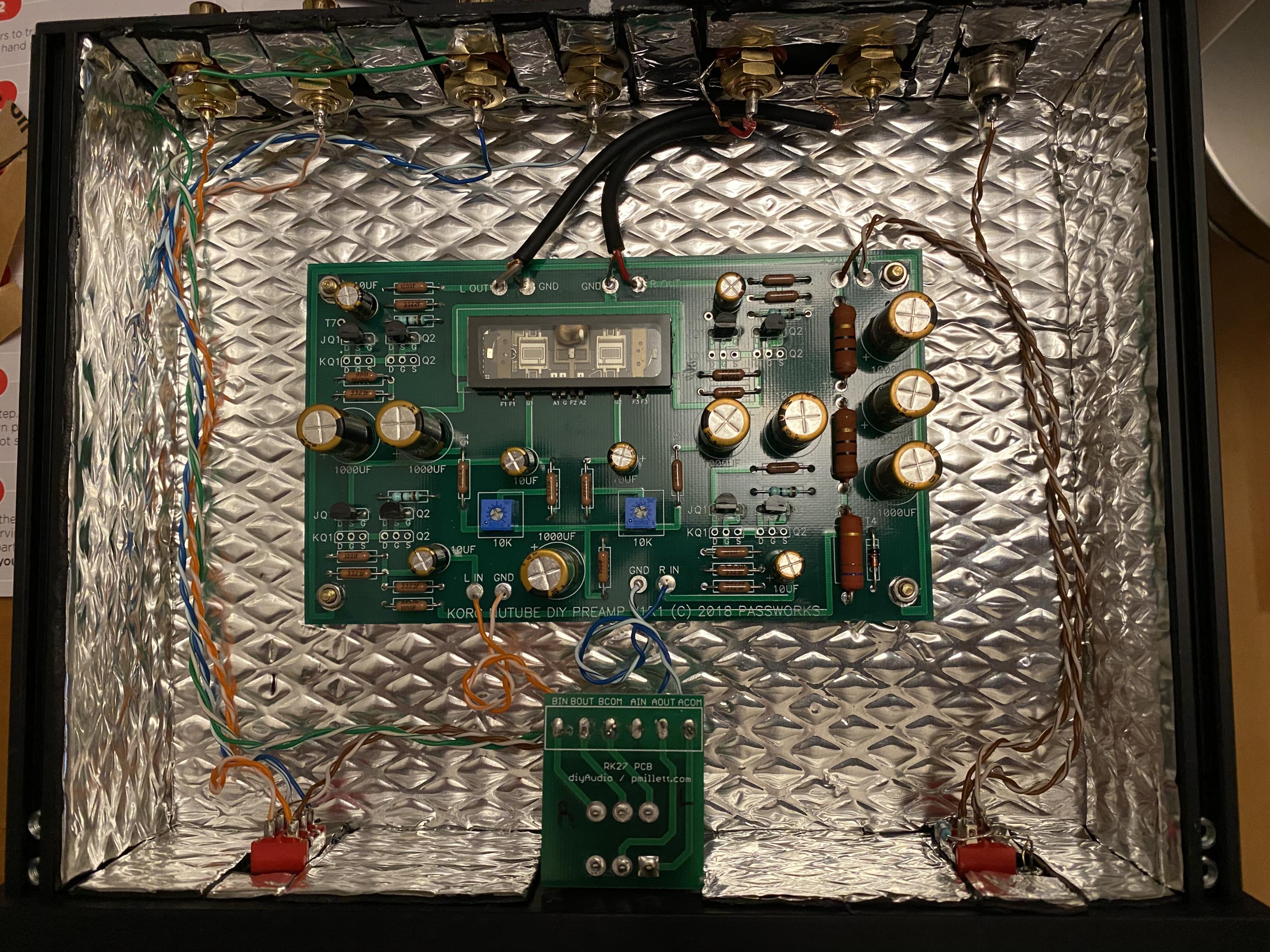

Thanks for merging the threads. Sorry for the double posting. Rewired all the input, output and ground wiring. The rca’s are the ones in the kit with isolation washers.
Also checked all joint solders. Also moved the unit and dac to another shelf position. It looks like if I take the case in my hands while the “beep-whisle” is going on, it stops. Is the pcb board connected to the case, ground wise?

I believe the perimeter trace on the board is connected to gnd of all inputs/outputs including the (-) input of power supply. In my build that is also connected to the 1U chassis (if memory serves) I have mine installed in. Possible ground issue?
What power supply are you using? Is it grounded?
I had issues with my build and had to provide a chassis ground via another device (the SMPS earth pin was not connected internally to anything).
Try run a line from your chassis (any screw) to a properly grounded equipment.
The PCB should (ideally) mount to the metal chassis with star washers and metal screws / standoffs to connect it to the perimeter gnd plane. (Look at the top right corner of the picture you posted to see the connection)

Regarding the ground connection between chassis and board trace, there is no actual connection. It seems that the case and bolts anodizing prevent actual contact. So, I will make sure there is a connection. I did the connection of board ground to another chassis properly grounded as suggested here but still got the beep. I shall report.
It looks like it is fixed!
As mentioned, there was no actual connection between the board ground and chassis. Why? Because the whole case and bolts were anodized. That includes the chassis chamfered holes and bolts, well, not the bolts that come with the kit to attach the pcb stands to the chassis, but as mentioned, these chamfered holes were anodized completely, offering no contact with the bolts.
So I removed the anodizing in the holes and established contact. My kit is the complete one that is offered for $299. But this also applies if you get the same enclosure from Italy that comes with kit. Thanks to everyone for your input and hope this helps new builders that get that enclosure.
