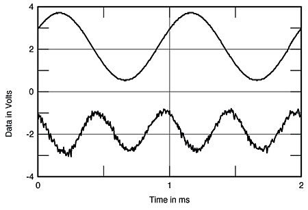

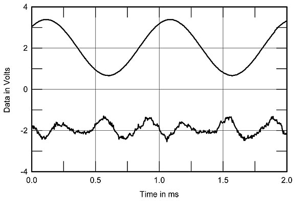

There are some who claim specs are all, and they do not even need to hear the preamp or amp, to know how it sounds, just based on specs.
There are those who know that right amount of distortion with predominantly 2nd harmonic and negligible amount of feedback yields to listening bliss.
Because the second statement is correct, is even the first correct.
Even if the graphics from attachment are not directly comparable due to different measurement conditions, the perceived sound impression agrees very well with the character of the distortion (fundamentally notched out). That's why I'm not interested in connecting amplifiers for listening tests, that have a sawtooth-shaped or triangular-shaped character in terms of residual distortion - even in cases, where THD-values are extrem low.
OTOH - if there are sine wave character of residual distortion, even high values of THD around 0,1-0,5% are barely audible or provide additional lovely sonic character.
I always like to check such amplifiers for a listening test.
If one check this distortion character of a wide range of measured amp models in stereophile I note, that not really the most of them have sine wave character. And unfortunately not one with a Class AB output stage with 20-50mA quiescent current.
