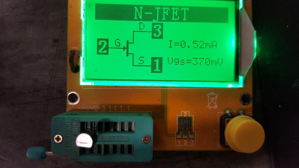

Ooooo- what is THAT cool toy you have there?!? I think I might want one 🙂
It's an E-Bay gadget, a very handy toy.

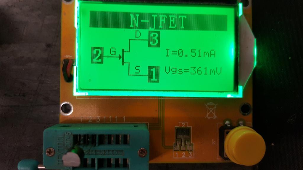

All four NFETs test correct but have been replaced as a matter of course. 4x 9v1 back to back diodes have been installed across the pot wiper and 0V.
There is still no output from either channel.
D2 - the LED - illuminates indicating power to the board.
